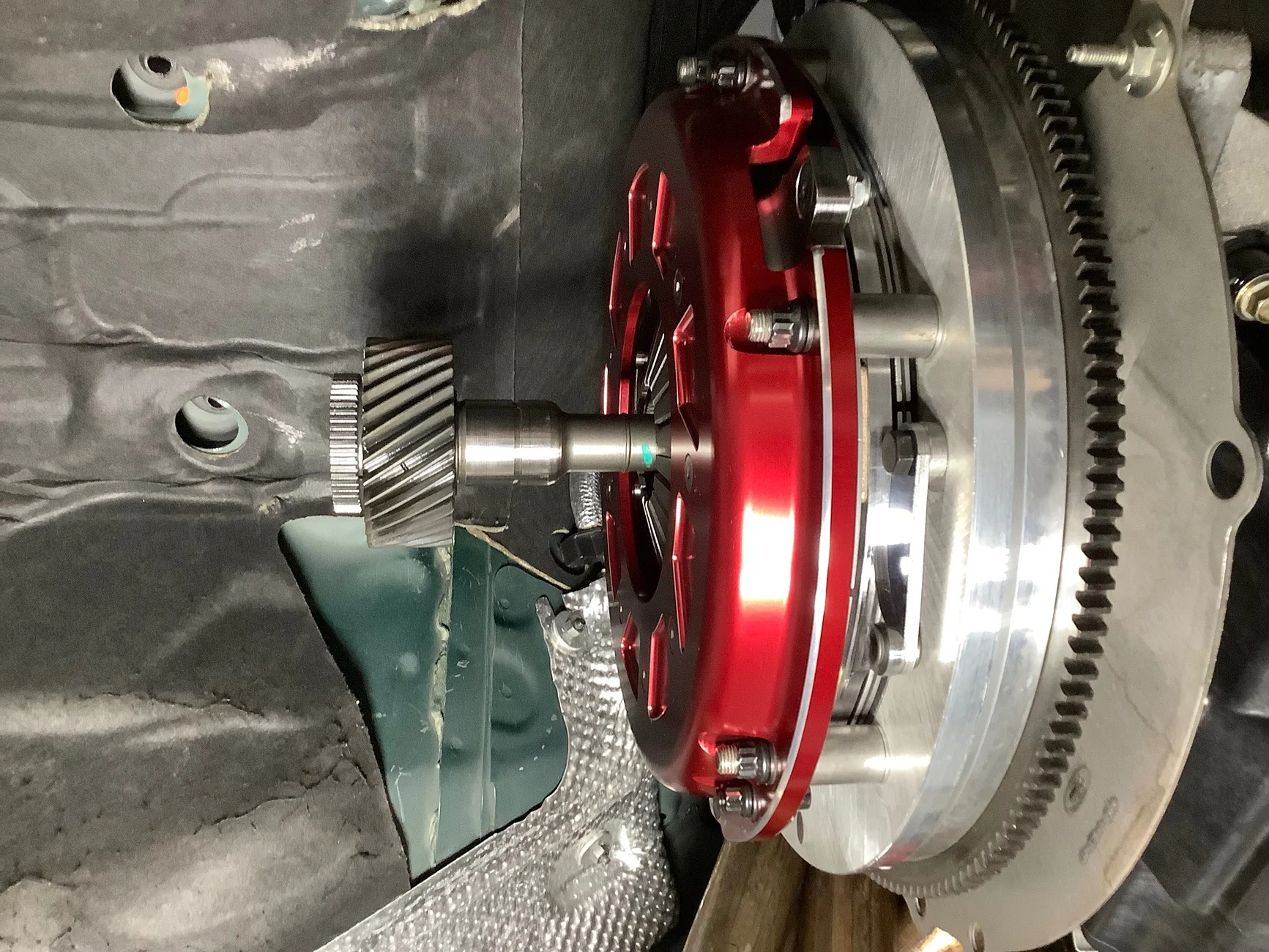

If it’s for a 2018+, I couldn’t find anything when I went down this road. Ram Clutches did provide a plastic one with their clutch, but it was short and made of plastic.
I was fortunate to find a workaround by using my input shaft from my tranny, since I had it apart for the rebuild. This was 3 years ago. If you find one, let me know because I’d like to buy one too.
Ram Clutches alignment tool and tranny input shaft.
