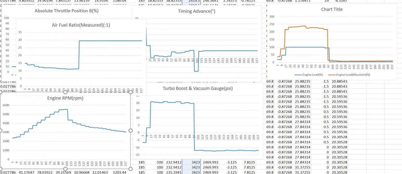

It's hard to tell what's going on in the stock log, the tuned log looks good. In the stock log, it isn't showing time and throttle position. The throttle position you're logging isn't physical, it's what is delivered. So if you were on the pedal 100%, it was pulling for some reason and that explains the boost dropping.
What are you using to log? If it's a phone with an OBD2 app for the stock, try closing anything else on the phone and make sure the phone isn't sync'd to the car. Anything will slow down the logging. Next only log as few parameters as you absolutely need. Every extra parameter slows it down. Notice the string of like 8 or so RPM the same in a row? What happens with most loggers is if they don't get an update for that PID, they will just repeat the value they had last reported.
With the data there, I couldn't really see anything to do with boost I'd be concerned about.

what tuning device are you using? this was full throttle the whole pull? There is no data for knock, oar, or ignition corrections? why is it so choppy and not linear at all is it the device you use to datalog?

I've replaced the filtered stock tune log with the raw data - same as the tuned log so we're comparing the same data.

Oh that explains a lot. There is a different PID for the physical throttle position, I don't know what it is though and don't use Torque because I'm on iPhone. I REALLY wish there was a good standalone datalogger available. The Cobb AP is fantastic for datalogging but you have to actually install it to the car which minimally loads a simulated factory tune. You're logging 22 PIDs which is asking a LOT out of a phone OBD2 app. You'll probably at best get about 50/second if you have a good quality OBD2 adapter and phone. So you have to really trim down the PIDs you log so it's more meaningful.

So LOR is the OAR? nothing changed during the pull so that is fine, I don't know why the throttle is doing whatever its doing though unless you are doing that physically
That's correct, and that was all done by the ECU. Should probably not expect anything else with the aftermarket mods.
Yes, LOR (Learned Relative Octane Adjustment) is the actual PID in the OBD2. The throttle is a relative position the ECU is adjusting to.
You're right. Especially if you have an aftermarket WGA, the ECU will be fighting it. Personally if you have many aftermarket mods, I wouldn't be pushing it until you get your tune back in it.
