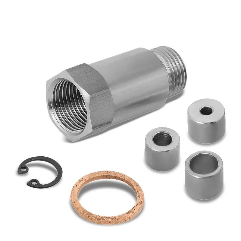

just get a vibrant o2 spacer, I used it and defeated cel entire time. I had the one with 3 inserts, I chose middle one. never a CEL
I can confirm. No cats here and pass all OBD readiness checks.

I used this type.

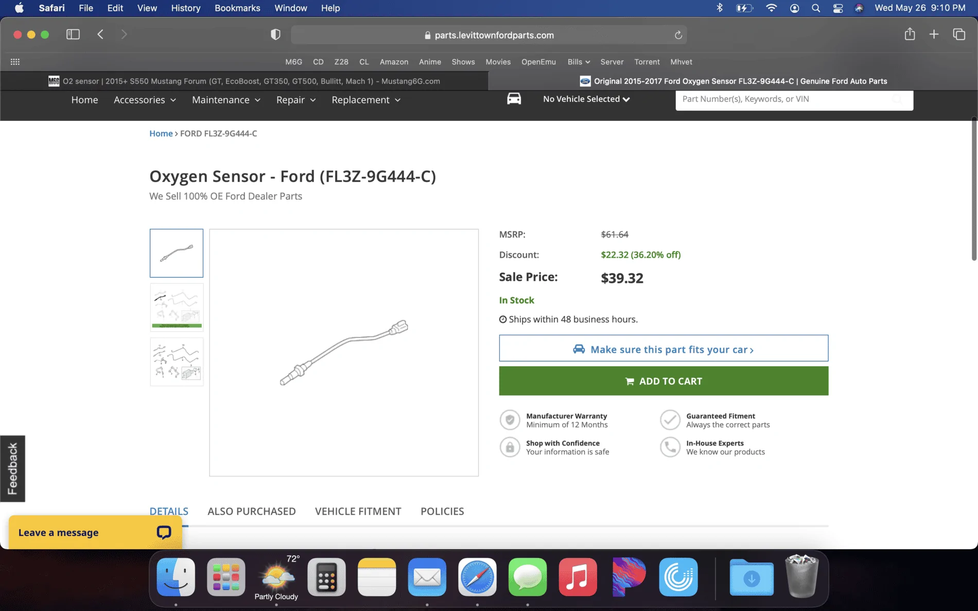

I dont know current price, but this was the rear o2 sensor when I last checked at levittownford

Just ordered it from Rock auto. Shipped was like $10 less. Total shipped with tax was $29
I am not dissing Levittown, they are who I use, but holy shit, I went through my emails from a year ago, all my parts that was like 20-30 bucks, are now like 40-50-60 bucks, same exact parts. damn sucks for people now getting their cars and modding, I dont see parts going on sale much anymore.
