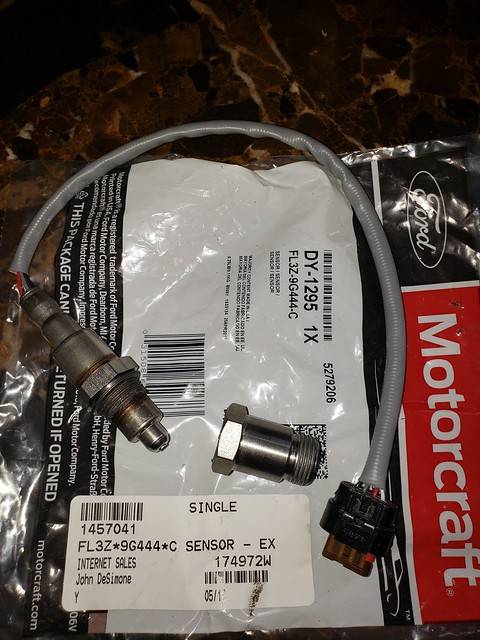

Here is what you need:
20200717_124220 by chefjpd, on Flickr
Thanks! I have an L shaped defouler/extender. Would that work as well? I'm slightly confused because the stock downpipe shouldn't need a defouler, should it?

You shouldn't need it on the stock pipe as the factory Cat chokes the flow.
Extender would only be needed on the aftermarket high flow cat.

I got sensors not ready for the 02 and 02 heater. ( = emissions fail)
Spacer did the trick.
I have a catted MBRP 3" downpipe.
