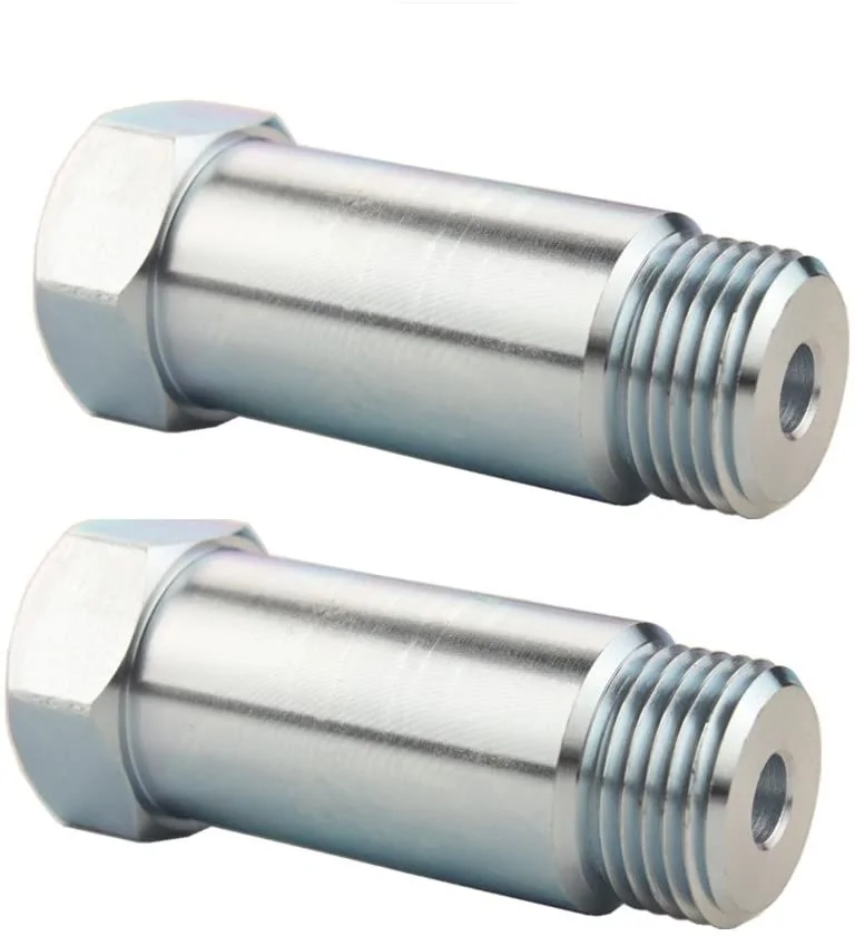

I'll second what every else is saying. I use o2 spacers with "free flowing" exhaust and headers, never had a cel.

So did you guys get angled or straight spacers?

Straight, the right angle ones are for if you are installing in a tight space that wouldn't fit the straight extensions

i havent heard of anyone with headers or cat deletes getting a cel once they are tuned. if you are not tuned is when the cel comes on. o2 spacers as mentioned should help prevent the cel on stock tune. spacers helped me pass emissions with stock tune and no cel.

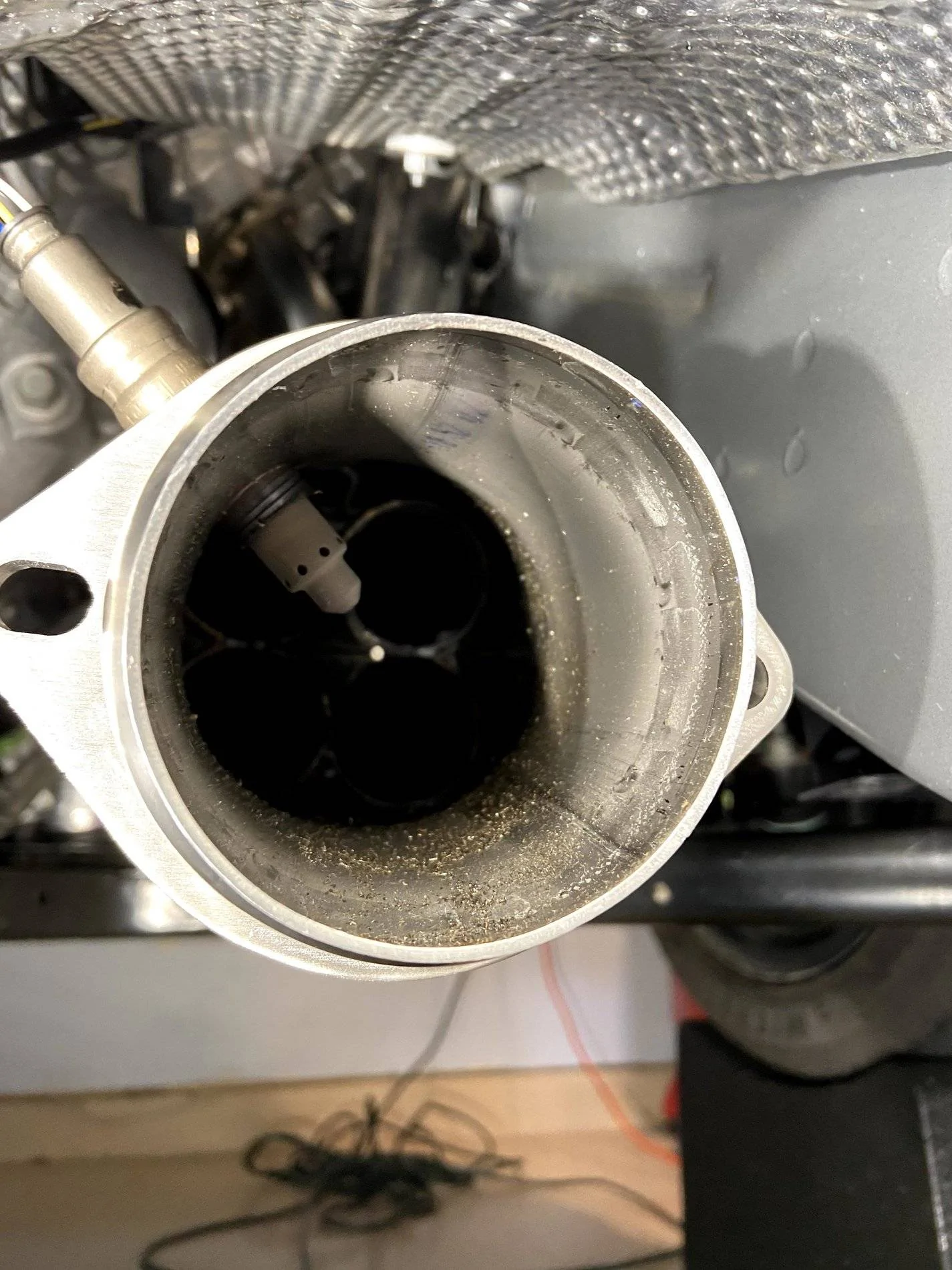

Hi, I just did a cat delete, so I’m full on straight pipe, I still kept the o2 sensors, I just had the check engine light come on. I was on stock tune, if I put my e85 Tune will that fix the issue?? Thinking of ordering my BBK long tubes soon also.

You can get them from AutoZone, Advance Auto Parts, Pep Boys, and many other auto shops for $6 a pair. You don't have to order them from Amazon.
most likely will fix the issue. can also try to use defoulers if you dont get inspected.
