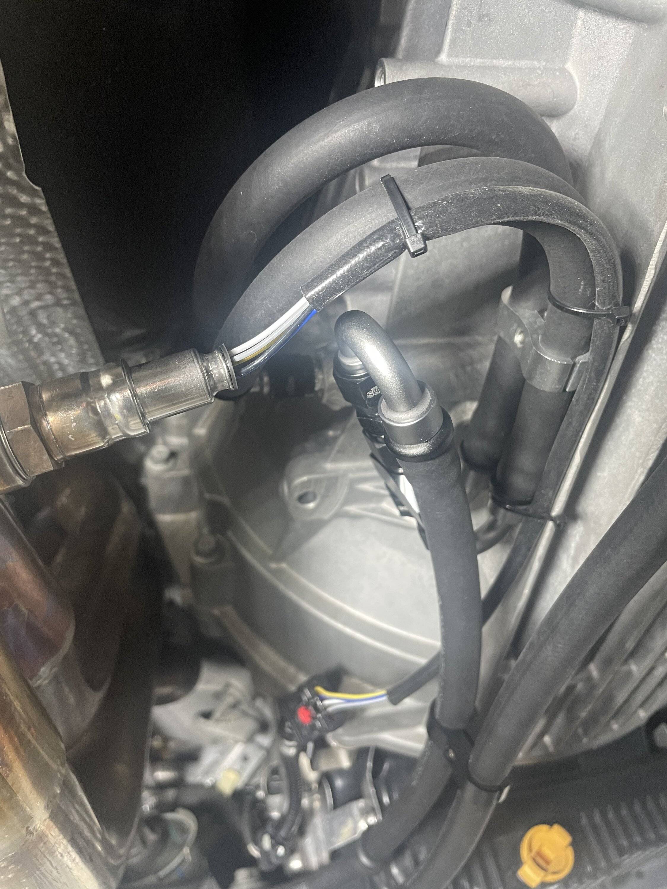

I was getting an oil change and my tech told me I should order an o2 extender soon on the front drivers side as the one I had was so stretched tight that it would start to corrode. Couldn’t find much for extenders but I found something around these NTK 27063.
I guess these work on the 350s and gives plenty of slack. I am running Kooks LTs.
thanks for any help!

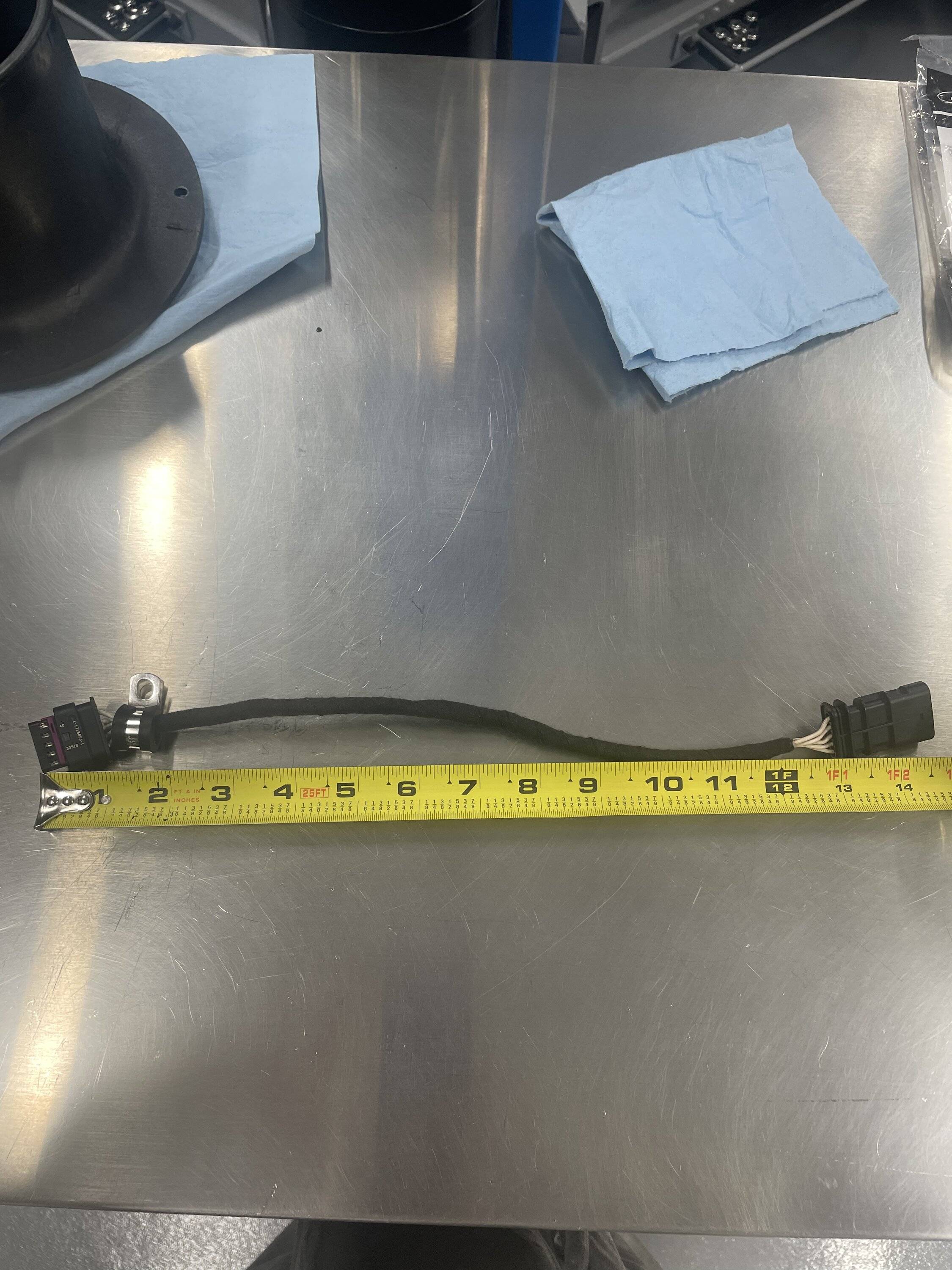

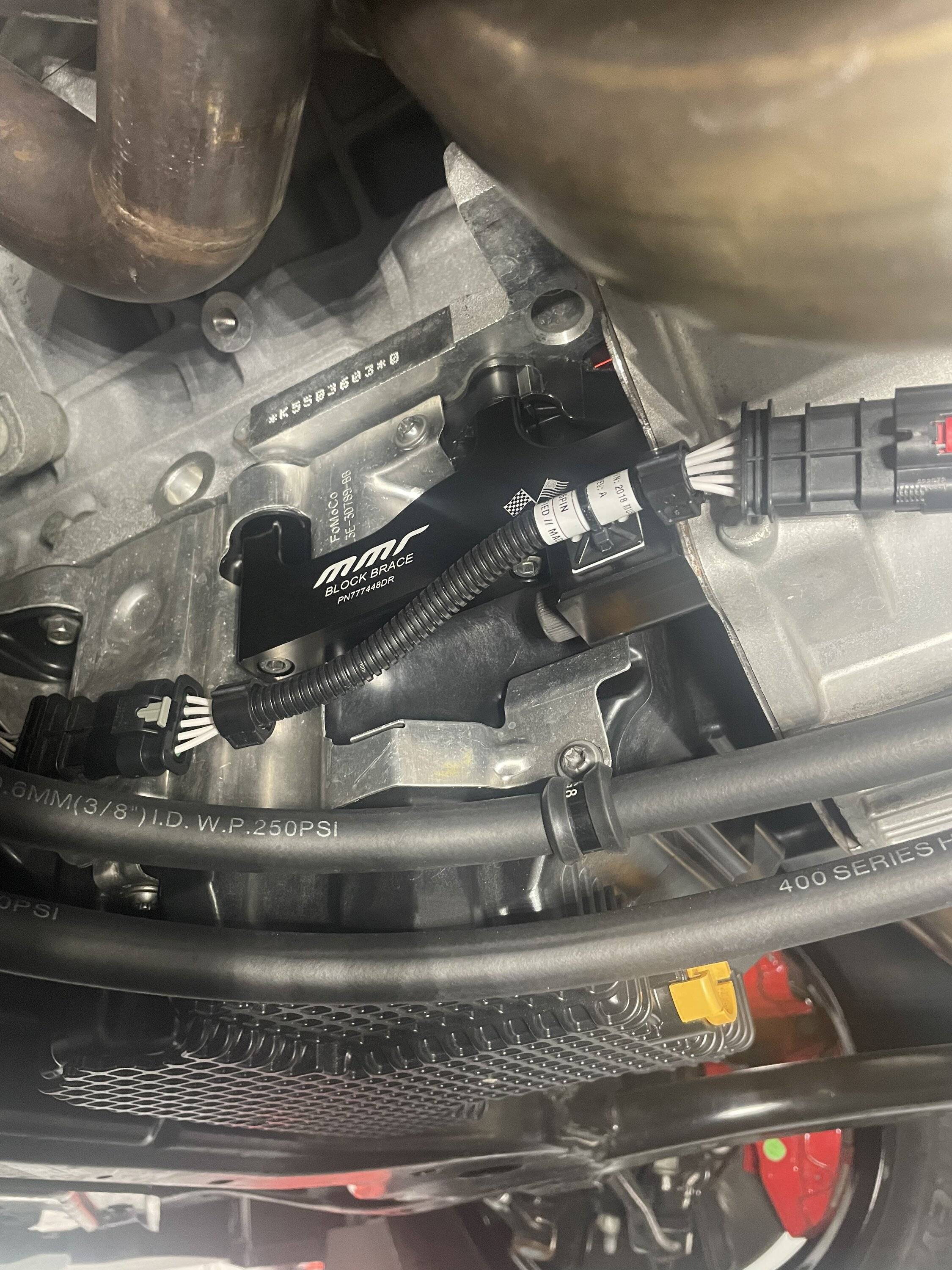

I just put a new Kooks 8” extension on my Bullitt today. It fits perfectly and with no stress. I even routed the o2 sensor harness in a way to take up the extra slack.
Check with Ultimate Headers, they might sell you a 12” extension harness. They supply them with their LTHs and that’s what I used before switching to the Kooks 8”. Even with my Kooks extension harness, I still had several more inches to play with, but I routed the o2 sensor harness in a way that ate up the extra length.
