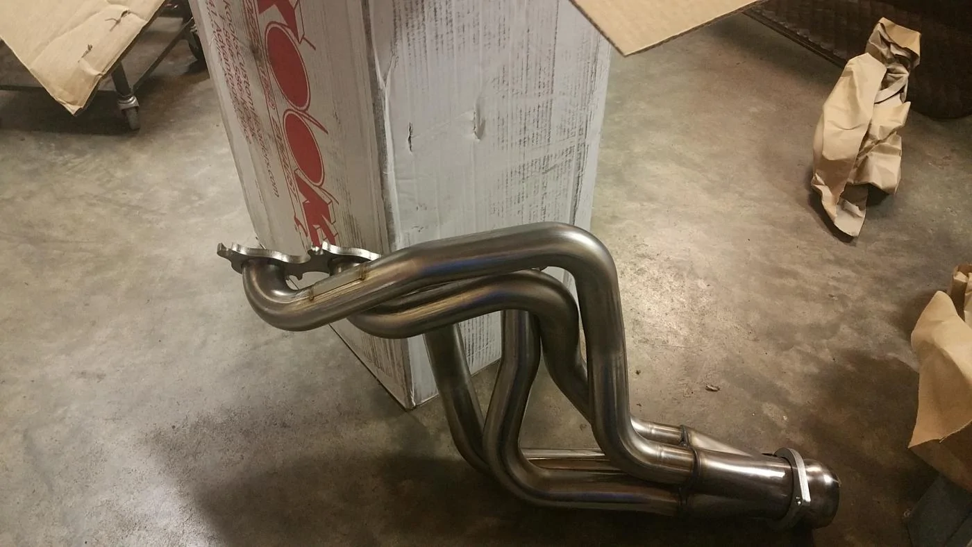

Thanks guys. They showed up the other night, will be a fun weekend..
