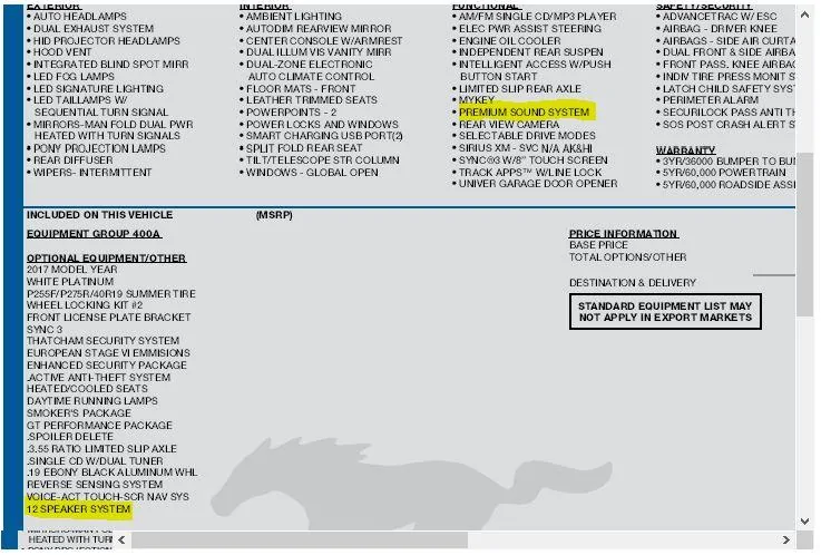

I hate to volunteer other members, but dcjwardog has a 17 model and swapped his 400a ACM for a 401a ACM. He might be able to tell you what pin the audio enable is, assuming it is different.
I didn't have to swap any pins over at all - truly a plug and play swap-out of the two head units for me. Also, my HD radio head unit - what I swapped in - came out of a 2016 car.
That makes sense to me now.
You have a 2017 Mustang. Your harness has two independent "audio enable" wires running from the ACM towards the DSP, one on pin #18 in the c240b connector (that pin is empty in my 2015MY harness) and the other on pin #7 in the c240a (that's the one my car has too) connector.
Basically it doesn't matter what ACM you drop in. If it's from a MY2017 it will use the first circuit, 2016 or earlier ACM's will use the second one.
