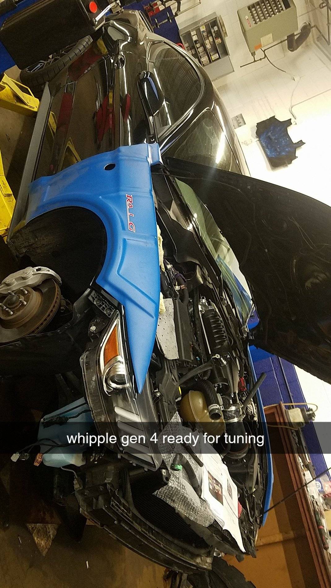

Did you get the oversized heat exchanger? The gen 4 we installed heat soaked like crazy, in this nasty ass summer weather we get in the midwest. Also ford changed coolant from orange to yellow but it looks green.
