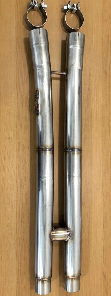

We've been fitting H Pipes for a long while now - a very popular mod to replace the huge centre resonator.
When fitting the most popular brands we've found that the clamp system to join the H to the rear sections of the exhaust is less than ideal. There tends to be a butt type join with a double ended sleeve clamp which fits nicely but due to the design it doesn't grip the H Pipe sufficiently and tends to rotate especially when the system heats and cools relaxing the torque on the clamps. This leads to the rear sections pivoting and misaligned tailpipes. So we worked with our fabricator IWS to create a more simple and more effective clamp join which sleeves over the stock system and grips it properly. Tooling was made to ensure every part is the same and fits perfectly.
The welding is almost too nice to hide under your car. Available from our online store for £192 + shipping.

Have to say I would not agree that the welding is that great.
Certainly if I had done that, and my boss saw it, he would throw it away and tell me to do it again.

Thanks for that constructive feedback - If you’d like to point me at some better quality parts for £192 I’d be interested in taking a look.
Our aim with this part was to address what we saw as a weakness in other designs related to the clamping system used. I’d love to hear what you see as poor quality.

I am sorry to have offended.
Although for clarification, I never said it was not a quality part, I never said it was not great value for money, and I never said it was not better than alternatives.
Your part is all those things, the clamping system especially makes it very good.
However I was purely questioning your sentence "The welding is almost too nice to hide under your car."
To me, I am glad you put in the word "almost" as that welding is nothing to want to show off, in my opinion.

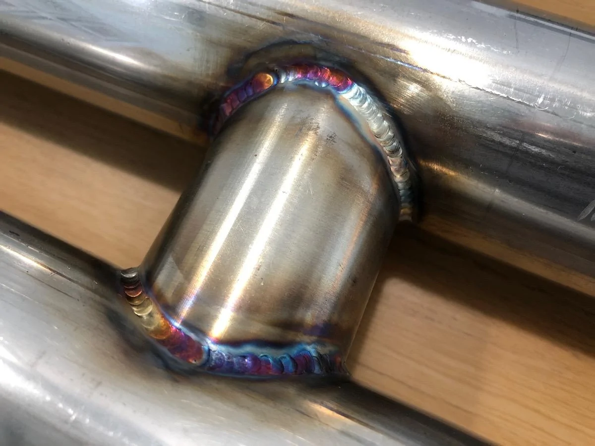

In my own personal opinion, having had almost 12 years experience in the nuclear Power Industry, as a fully coded welder, working on very high pressure containment vessels, I would not be proud of that at all.
The colour is not even and consistent throughout the depth and circumference of the welds.
The size and shape of the puddle feathers vary.
The weld around the name plate is not even straight.
And There are possibly at least 4 pinholes I can see.
You asked me to point out, what I believe to be poor quality, and I have, but that is in comparison to what I know a weld can and should look like when done properly.
But to be fair to you and the people who welded the parts, they are in comparison to what you would normally see, on similar parts from other manufacturers very good, but they are by no means great, and most definitely nowhere near perfect.

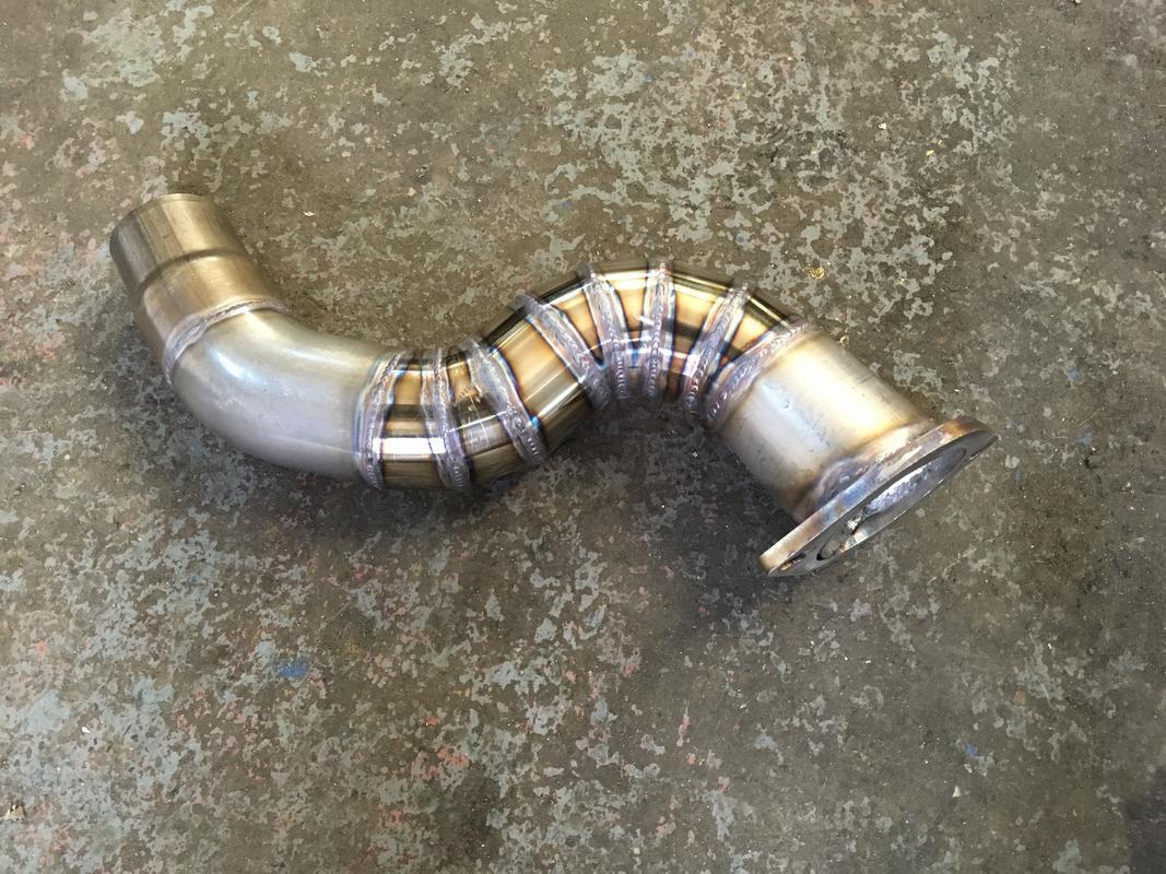

Agreed... the welding is perfectly fine for the intended application.:)
Talk of welding standards within the nuclear industry and pressure vessels is irrelevant..
Here’s some crap welding that’s been on my car for well over a year now:cheers::D

woohoooo for puddle welds.
To be fair; Who cares, you never see it, aslong as there's no holes and it works for the exhaust woopidy dooo daa :D! (i say that because i've also got some really sexy welds on my car...)
