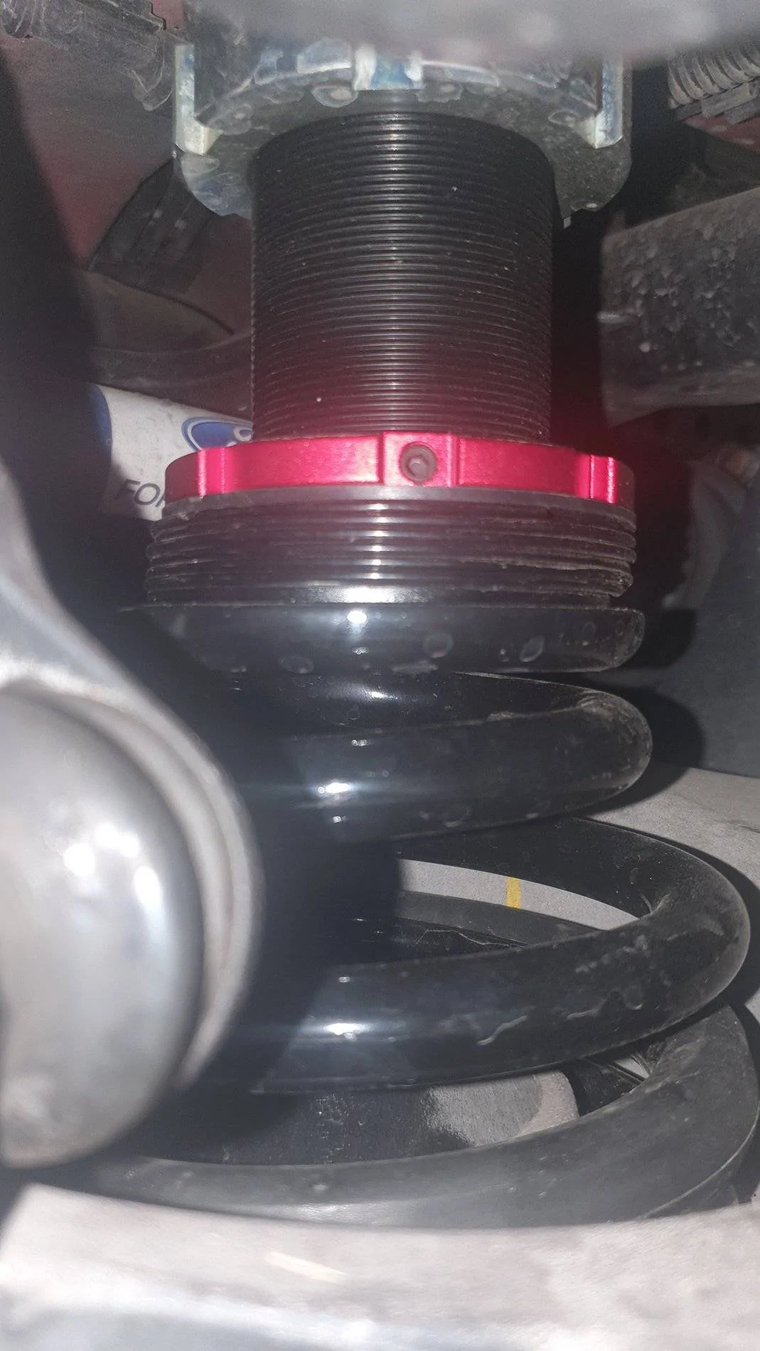

Hi Bluemustang I'm not too sure what you mean by divorced rear spring but I'll attach a photo to help

That's a really soft rear spring rate and perhaps that along with shocks with too much rebound for that rate is where the lift off oversteer is coming from. Just my guess. I have no idea what a proper drag setup looks like so not going to comment on what you should do for rear springs if the focus is on drag racing.
When you get front rates above ~400 lbs-in on the front struts you will not be able to have preload and a normal or lowered ride height. It is common to add small helper springs and a coupler to keep the main spring under tension at full droop.
There does appear to be one of those helper springs and couplers in place on top of your rear springs in the picture you posted.
