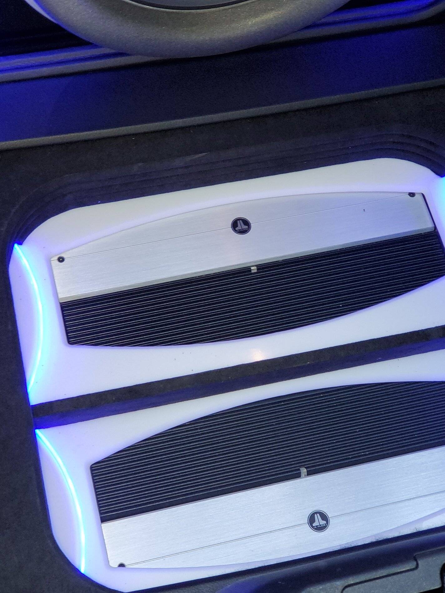

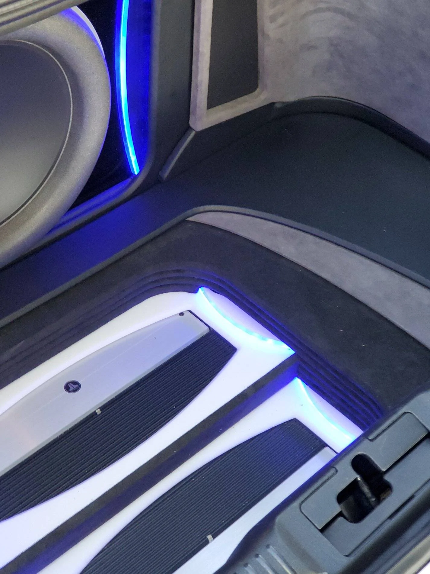

Is the amp easily accessible, can you post a picture taking care to capture the inputs.

Yea ill take a picture.. all sound comes out of the center dash speaker only time I got all the speakers and sub to work was with a astell & kern media player. Bluetooth works since I can connect my cell but the media player is a hit or miss with factory recognizing it.

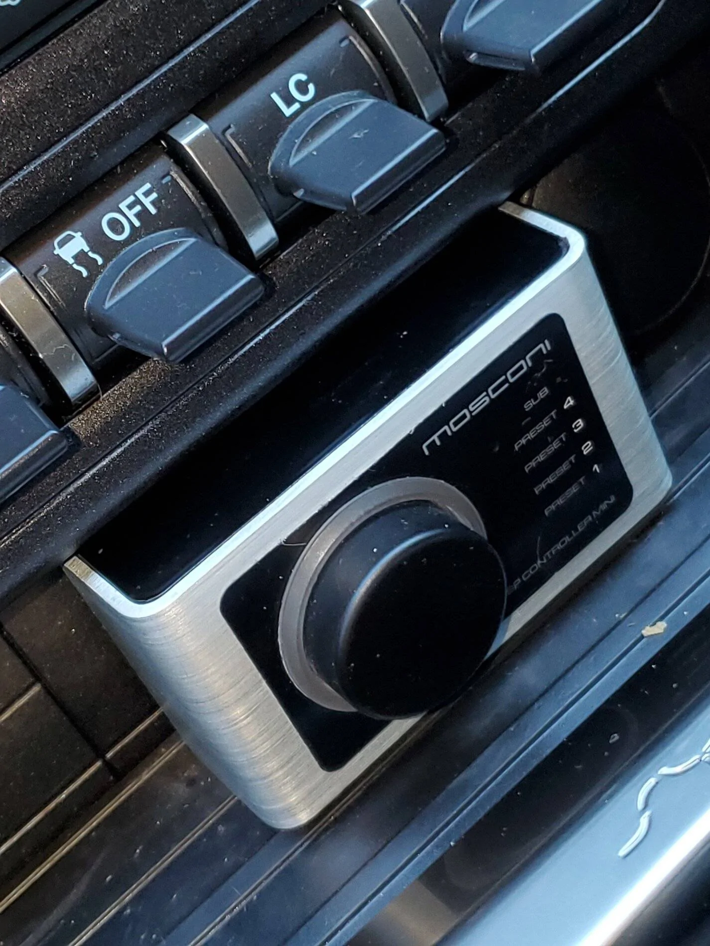

Ok, it has a Mosconi DSP.
How is that DSP connected on the input side?
Is the Mediaplayer directly connected to the DSP? If yes, then it would be good to know if the stock headunit is also connected to the DSP. If not, change that. The Mosconi DSPs can automatically switch inputs if f.e. the input of the MediaPlayer detects a signal.
On the other hand, if you connect the headunit to the DSP, why would you need the MediaPlayer anymore?

That Mosconi unit handles the audio from the player. Kind of sucks as they could have used a PAC PRo unit and ran everything through the system and not just the player.

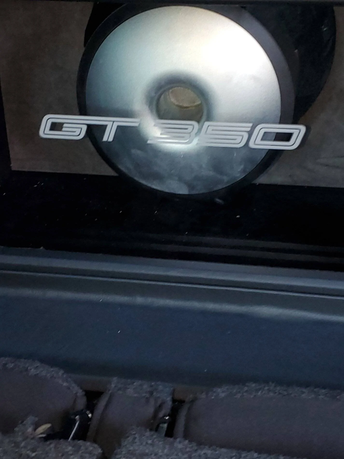

Well, JL amplifiers and as it looks a JL W6 sub and Mosconi DSP. Yes, that is some really good equipment.
That’s an understatement! It’s actually a W7 subwoofer 😳 There’s no PVAC at the end of the pole piece. Based on the photos, I’d wager that he has an XD1000/1 running the sub and a XD800/8 running everything else. Makes you wonder what the front speakers are...C7’s?
