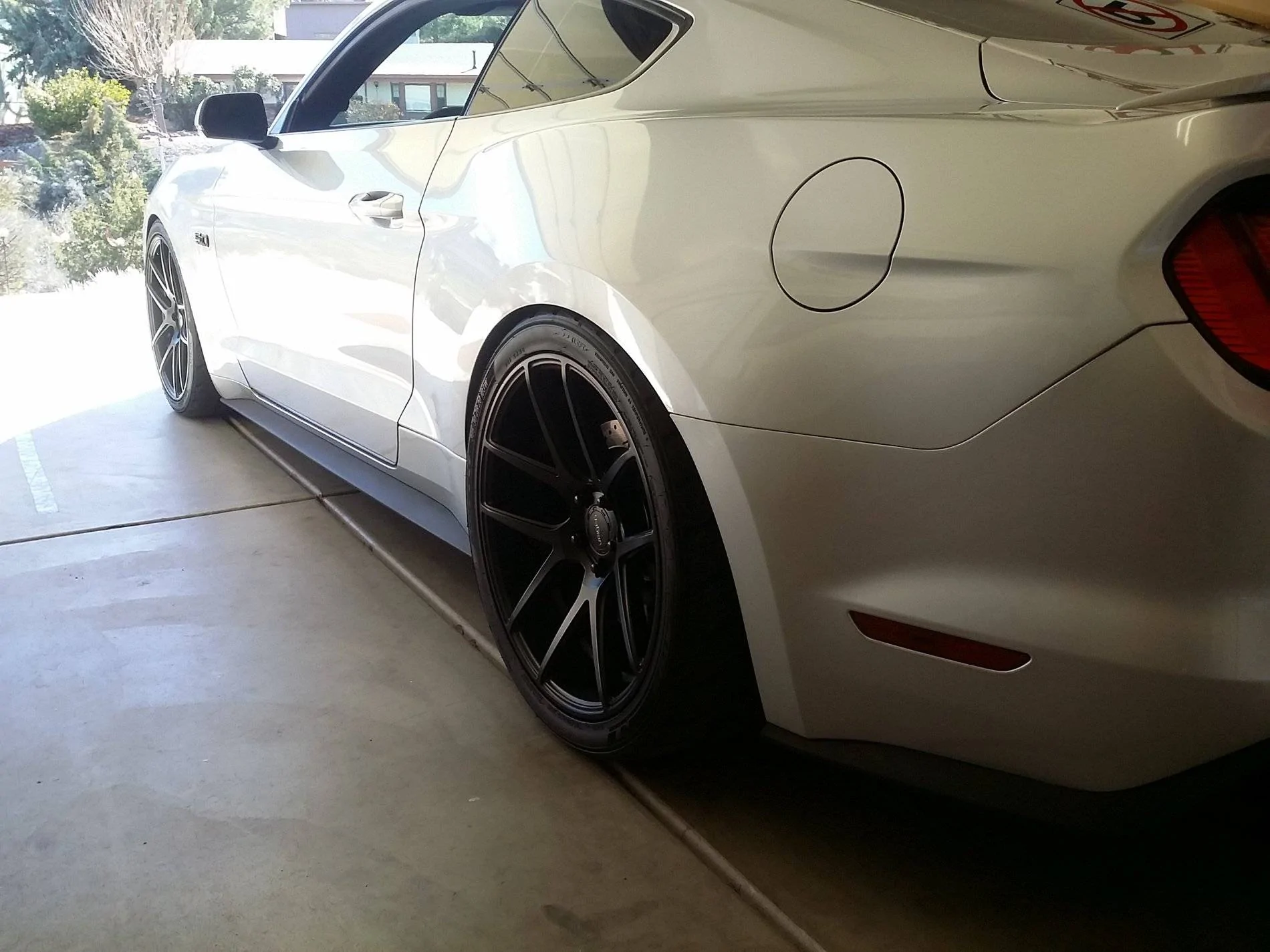

The nt05 are the bomb, have about 7.5 k on them and wear is great . And I'm at over 700 rwhp .
