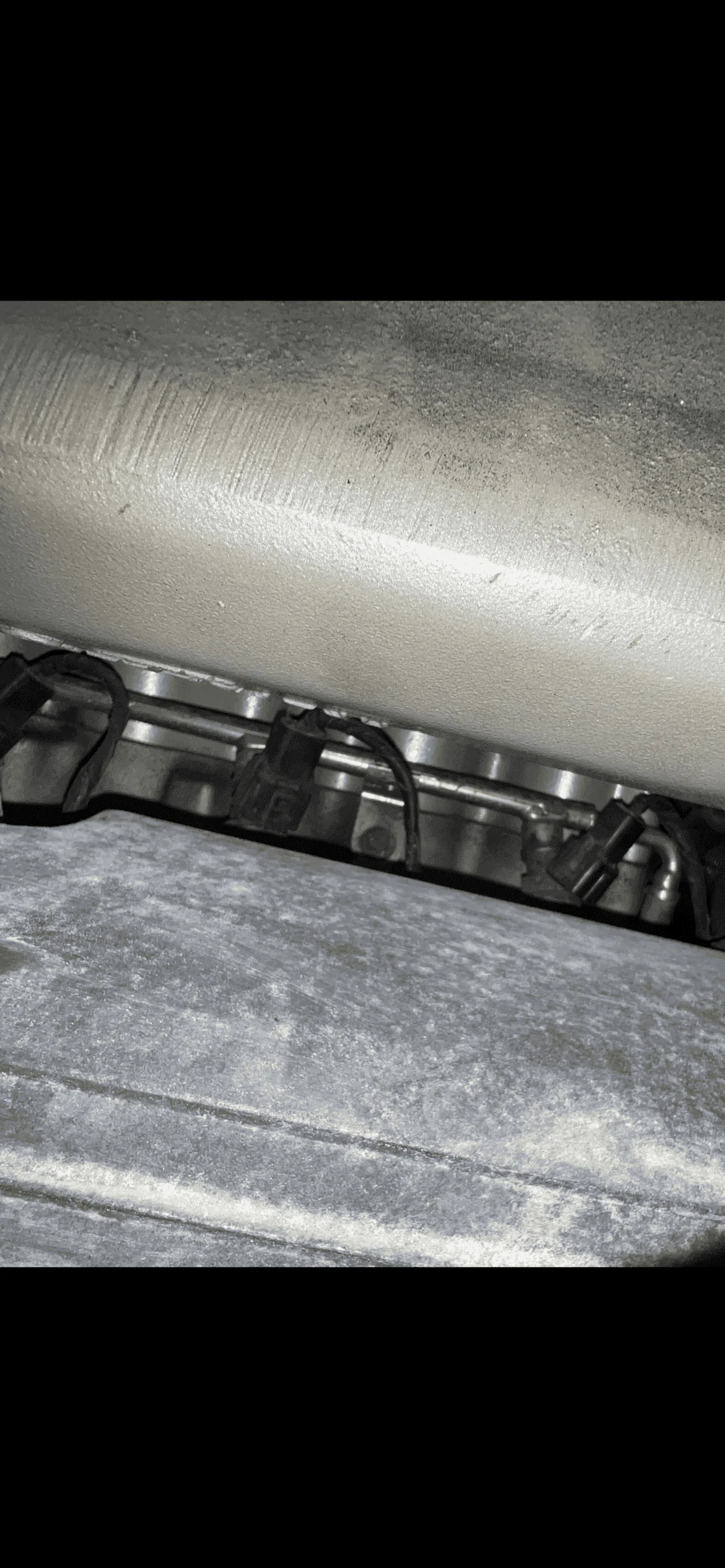

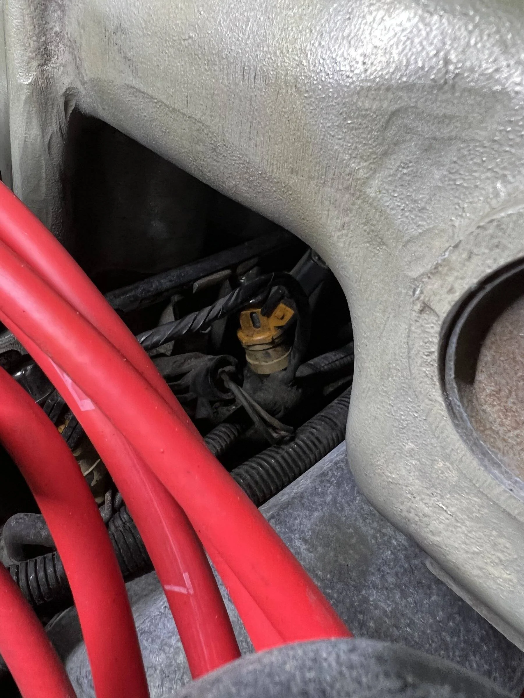

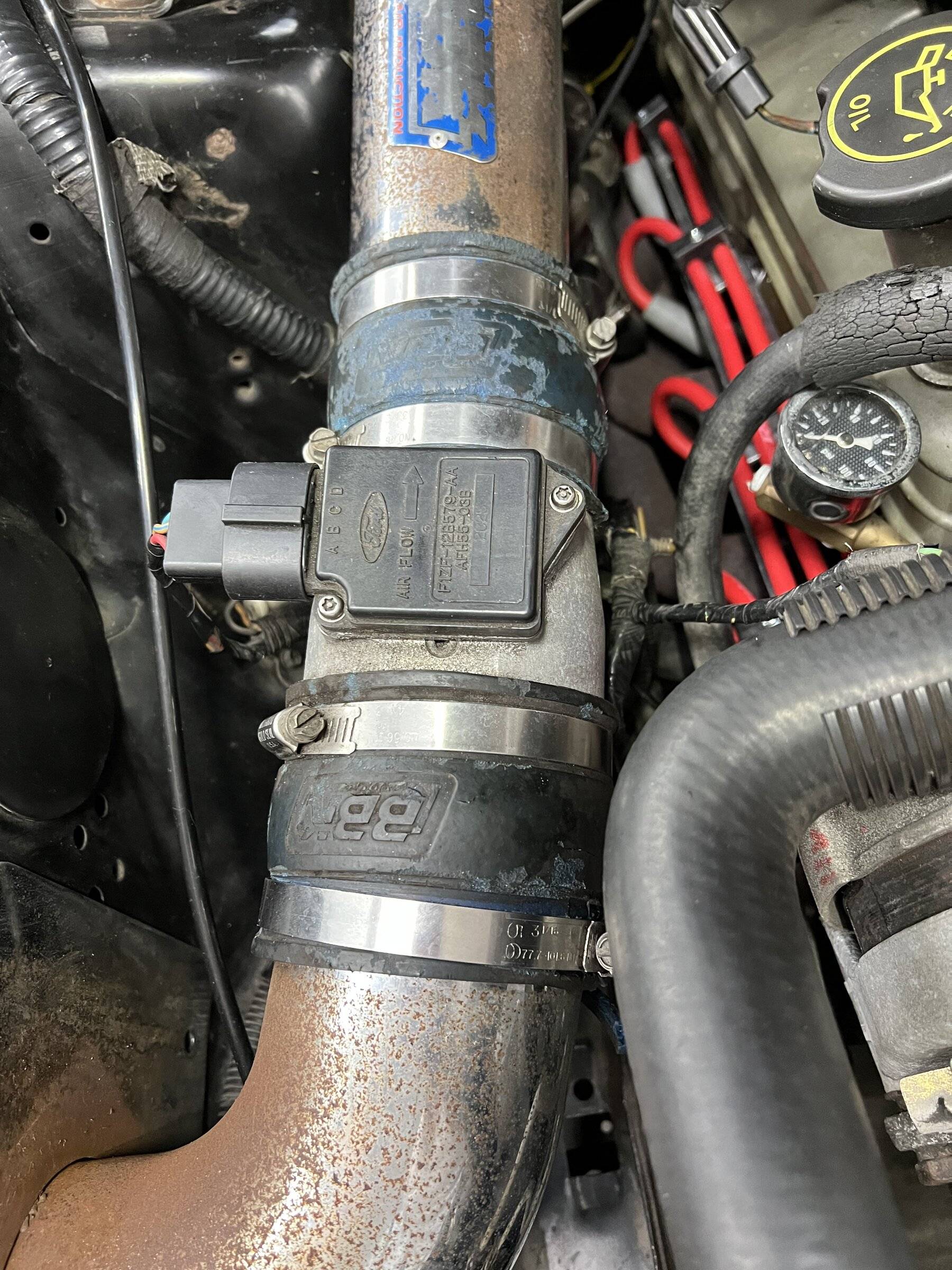

So I bought the car after it had been sitting at the sellers house for 5 years. I got the car running and took it to a mustang mod shop to get the engine to run smoothly and to fix a misfire. I picked up the car yesterday and it drove great but when I stopped to get gas and filled the tank from then on the fuel tank has been buzzing constantly and the car rides much rougher. My guess is that when I filled the tank it stirred up all the rust and crap in the fuel tank which then clogged the fuel pump. I plan on replacing the tank and fuel pump and go from there. The car is a 92 gt with a cobra intake manifold, bbk cai, full exhaust, x303 cam, and I believe it has some sort of aftermarket head. The car had light blue injectors when I got it which I believe are 24# but after I picked the car up from the shop they had installed the stock 19# injectors. Some things I need help with that I wanted to ask you guys is: are those 19# injectors enough for my car should I switch back to 24#? Should I go with 155 or 190 lph fuel pump, and if i stay with the 19# injectors do I have to buy a new MAF that is calibrated for 19#? Something I should also mention is that the car backfires and pops much more than it used to. However I checked the fuel pressure when I got home and it all looked normal it was 40psi when the pump primed and 35psi at idle. Any help would be appreciated

Here’s pics of the maf, the old blue injectors and the new ones
