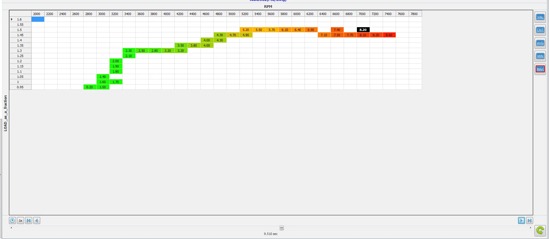

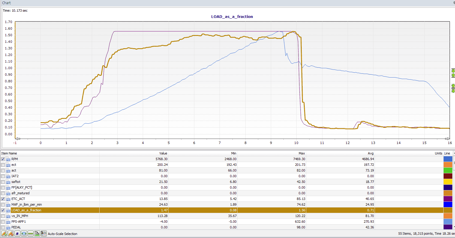

At 5500 RPM your load started to drop. That's not normal for a pro charger unless you have a waste gate setup. usually it climbs all the way to 1.6 or higher. I would guess belt slip. Your fuel trims do not indicate a boost leak. All you have to do is listen for belt slip, you should be able to hear it.
Boost looks like its constantly increasing which is normal.

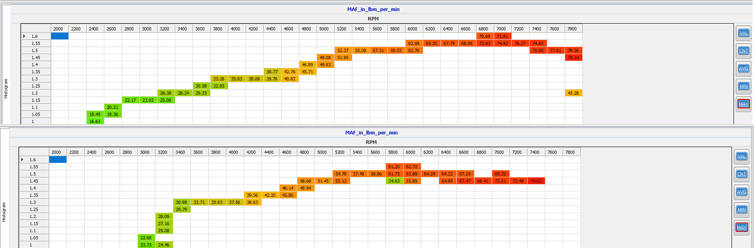

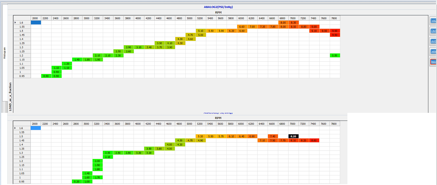

Comparing your cats vs no cats logs:
Boost is down .25-.5 PSI.
MAF is up until above 6000 RPM.
IAT is 40* cooler in the newer logs, given that and the cat deletes I would have expected MAF and boost to be higher all around.
The old log is the one that gets to a higher peak load.

Yea. With cats log was on the dyno 4th gear pull and it was about mid to high 80s. No cars logs I sent at the track it was right around 60* maybe a tad lower. I expected to see slightly higher boost with that kinda difference in DA. So there’s definitely a slightly drop in load from 5 months ago to now and also a drop in maf lbs above 6000.
