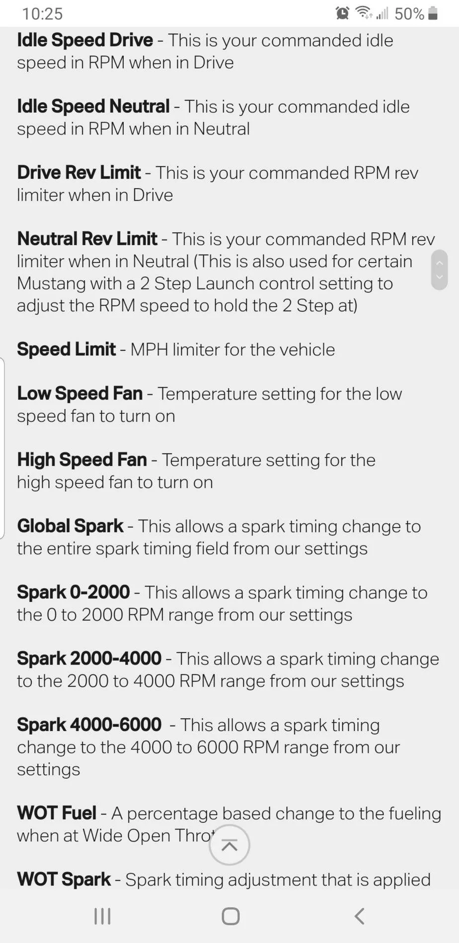

So I purchased my first tuner 93 octane race tune and e85 tune

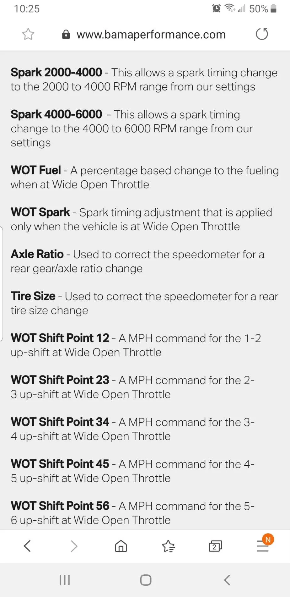

My question is once I flash the tune it gives me a bunch of options (see pictures for list)
I'm just wondering if anyone has any advise on what to set these at.
Thanks guys

You don’t need to touch any of those settings. Everything that needs adjusting should already be done in the tunes you received.
The only settings the average driver should mess with is “Speed Limiter” -use to remove the factory high speed limit, and the “Tire Size” -used to correct the speedometer if you changed the tires to a different size diameter.

Most tuners do not let you change those options, for good reasons. Typically you should not have to change those. I'd be more concerned with the tuner you are using than the tune options themselves.
