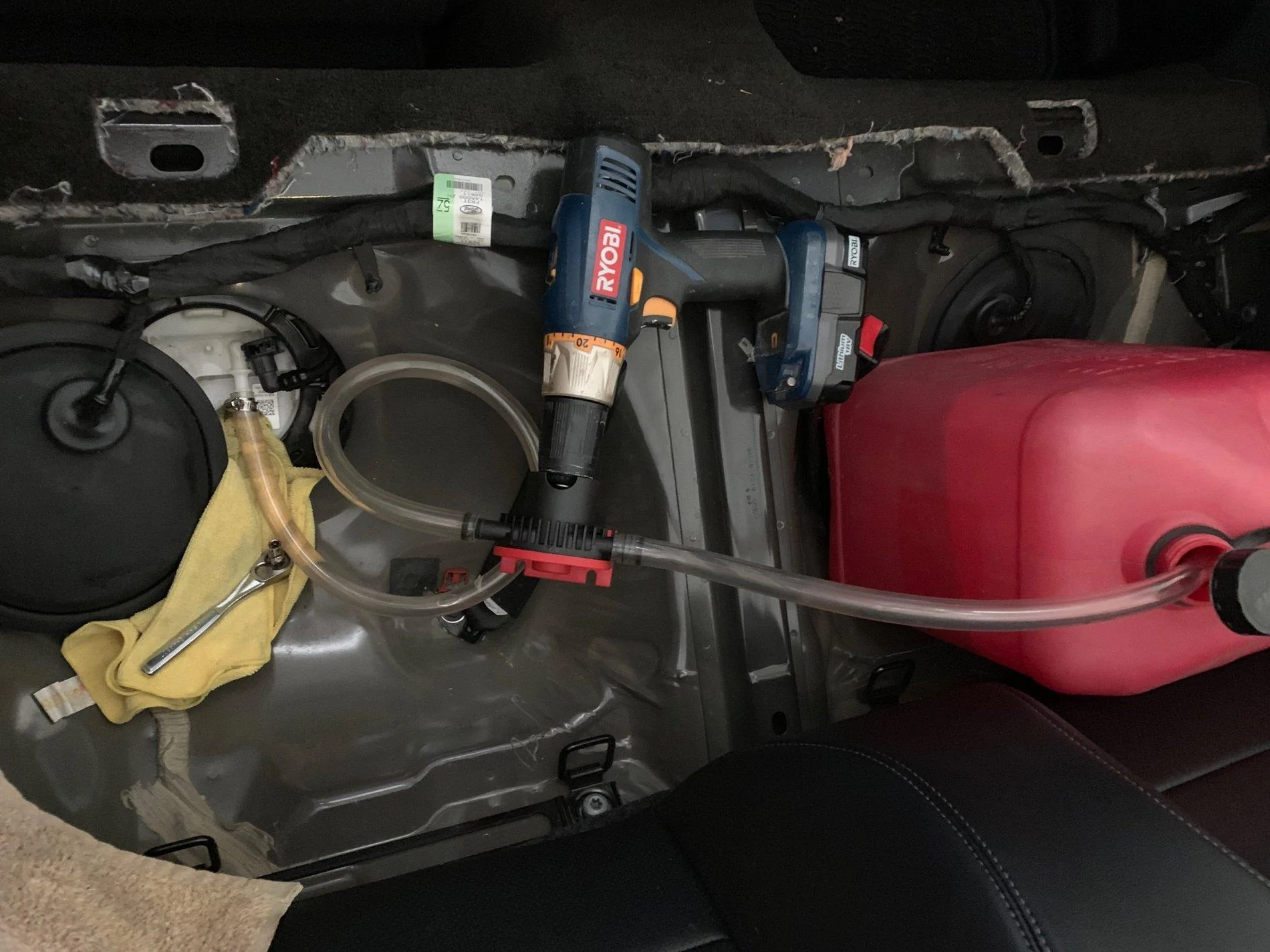

Here is what I do... it is a cheap quick way to drain your fuel... W/O hurting your pump...
yea that a good idea too. Where did you get that pump on the drill attachment?

ebay, amazon just search "drill pump" if you are in a hurry most HW stores have them too... I would get a spare one if you need to count on it... they don't last long. maybe flushing it our with water can help them last longer. However, for ten bucks I don't even worry about it and just keep a spare one on hand...
