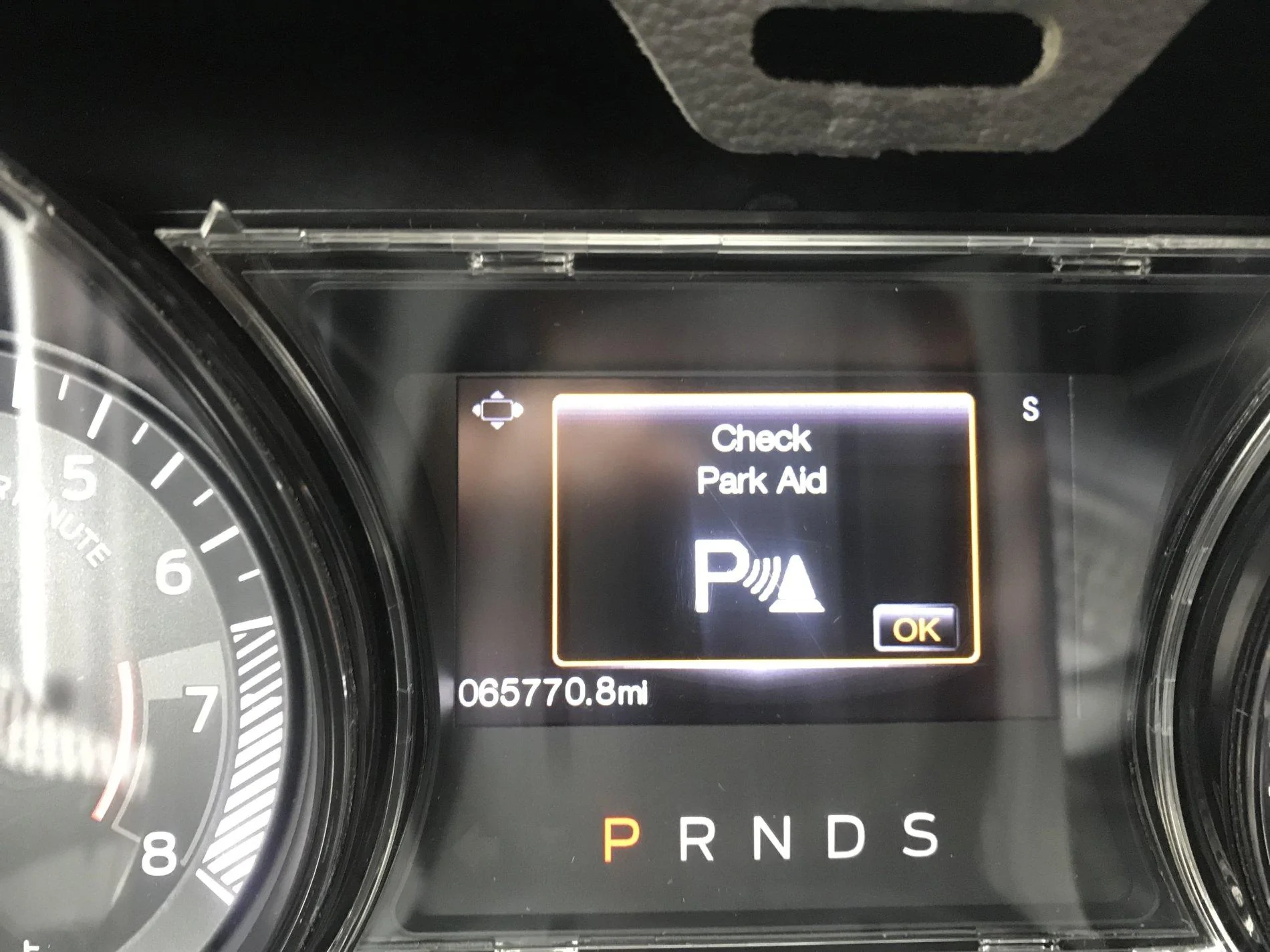

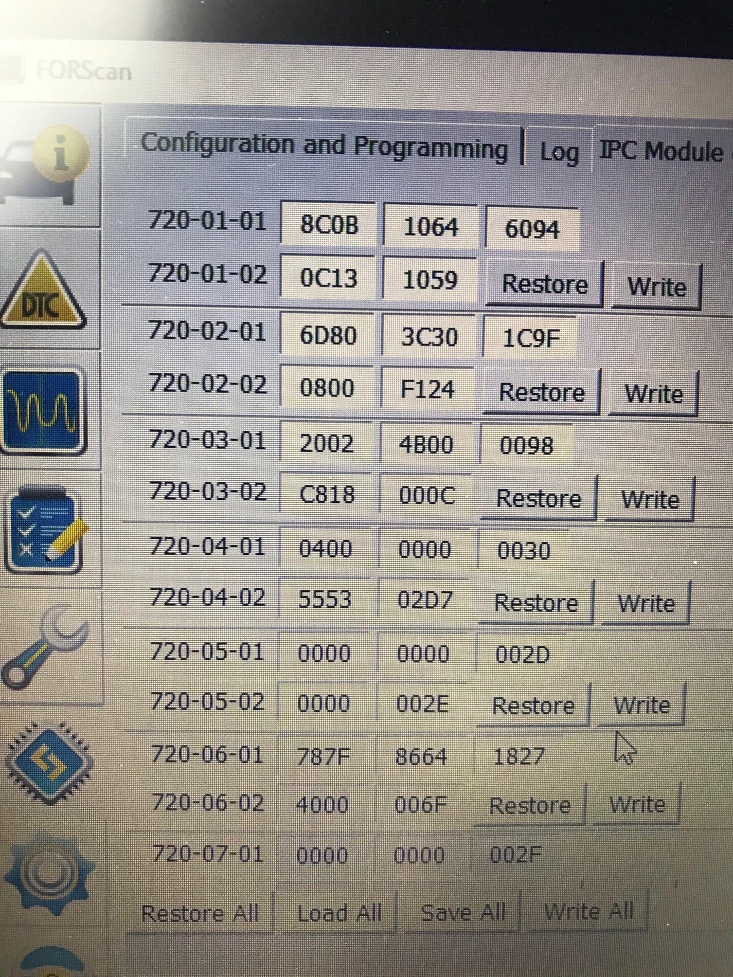

On a side note, I installed my premium gauge cluster with Mycolor. Everything works great, except that I'm getting a "Check park aid" message at startup. Using Forscan, I disabled the parking aid, but I'm still getting the message. Did I miss anything? Any ideas or suggestions?
