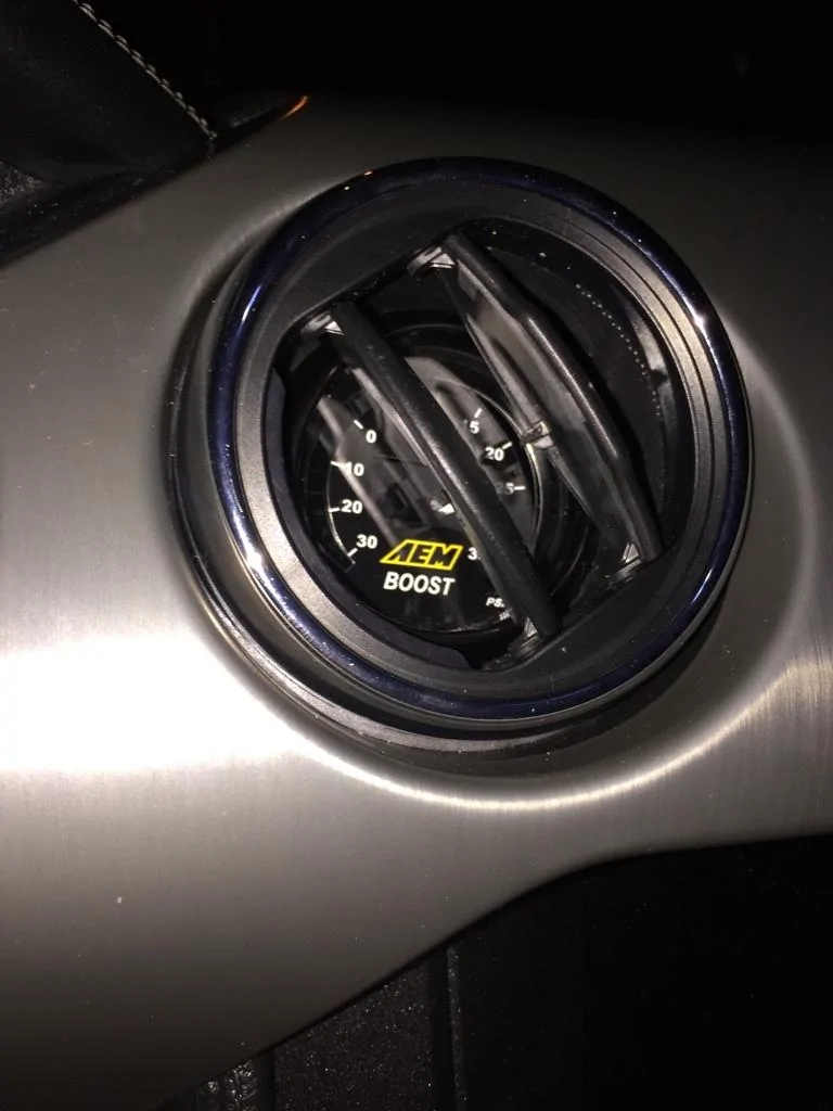

Switched up the gauge to digital and finished running all wires and selecting my 12v switched ground....just have to solder in and it will be done. Also finished the plastic work and sealing/silicone and weatherstripping to divert the airflow to the other two vents with no leaks. Didn't want the gauge to get condensation or make noise. Mao sensor went in unsused 1/8" port that was urged from Whipple.

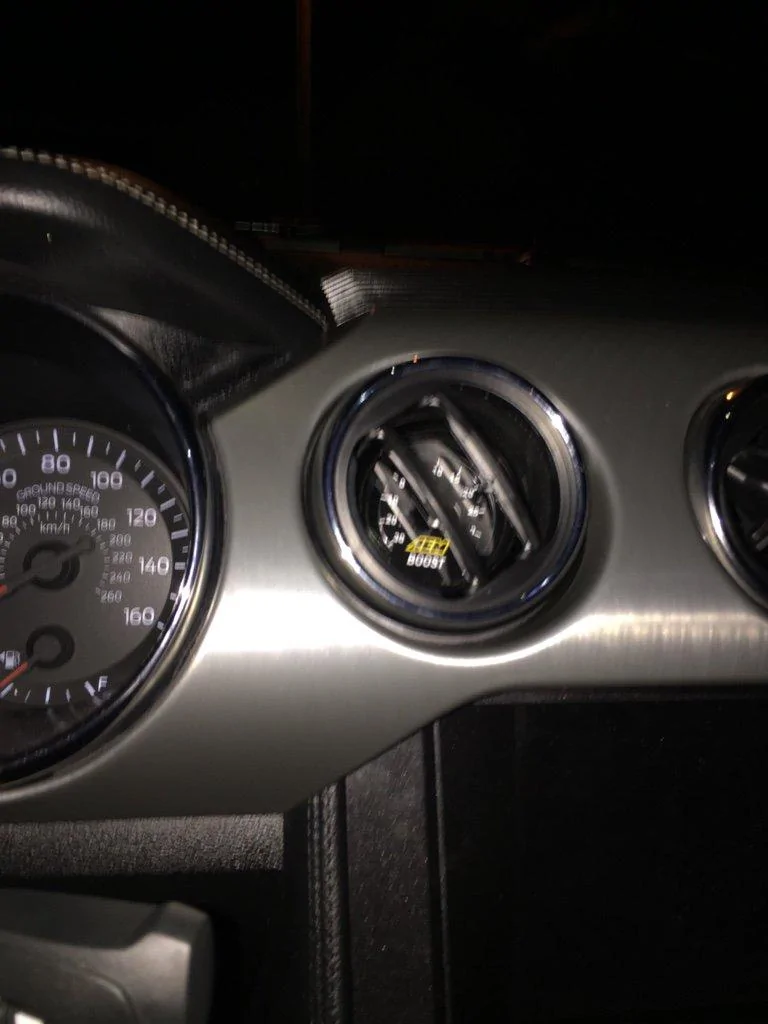

Honestly I love it - is it the AEM gauge? It has a color band around the outside that is vacuum/boost and not a/f and a secondary number reading. . I'm PD with a whipple 2.9 and I only want it for quick glances to verify pressure at WOT. I'm not really concerned not looking at it on decel
Here's a night shot coasting -where did you mount yours?
