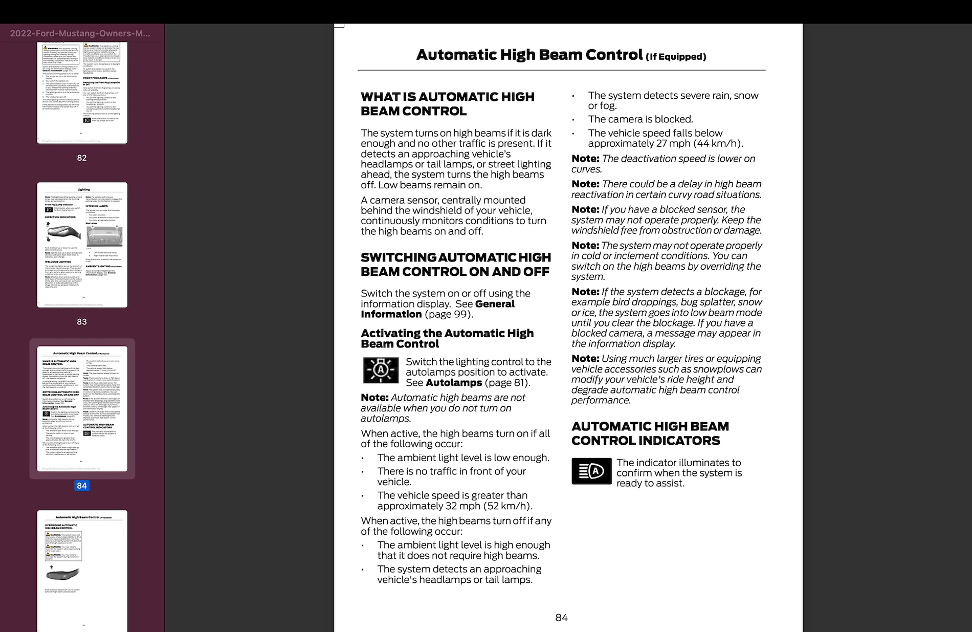

I do not have an answer for you. But the problem did make me think of a feature.
Attached is an excerpt from the US manual. It describes Automatic High Beam Control.
If you have the option, see if you can unselect it. Curious if the condition changes.
The excerpt also lists reasons why problems might occur.
While it doesn't explain why one lamp is doing this, maybe it could help in diagnosing.

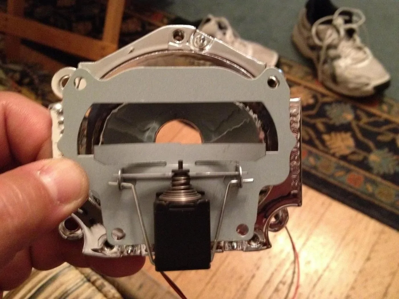

A motor in the headlight that moves a flap.
The mechanics in the headlight, the motor or the current flow to the motor may be the problem if it only occurs on one side.

That's how this works for decades for bi-xenon HID.
It is proven solid and good, no "digital shitification", because hidden for the customers eyes.
There a itterations of this, e.g. with a drum with different silhouettes for different patterns of light output, which is rotated to change the pattern.
If you want "digitalisation", you need to get a car with multi beam led head lights.
