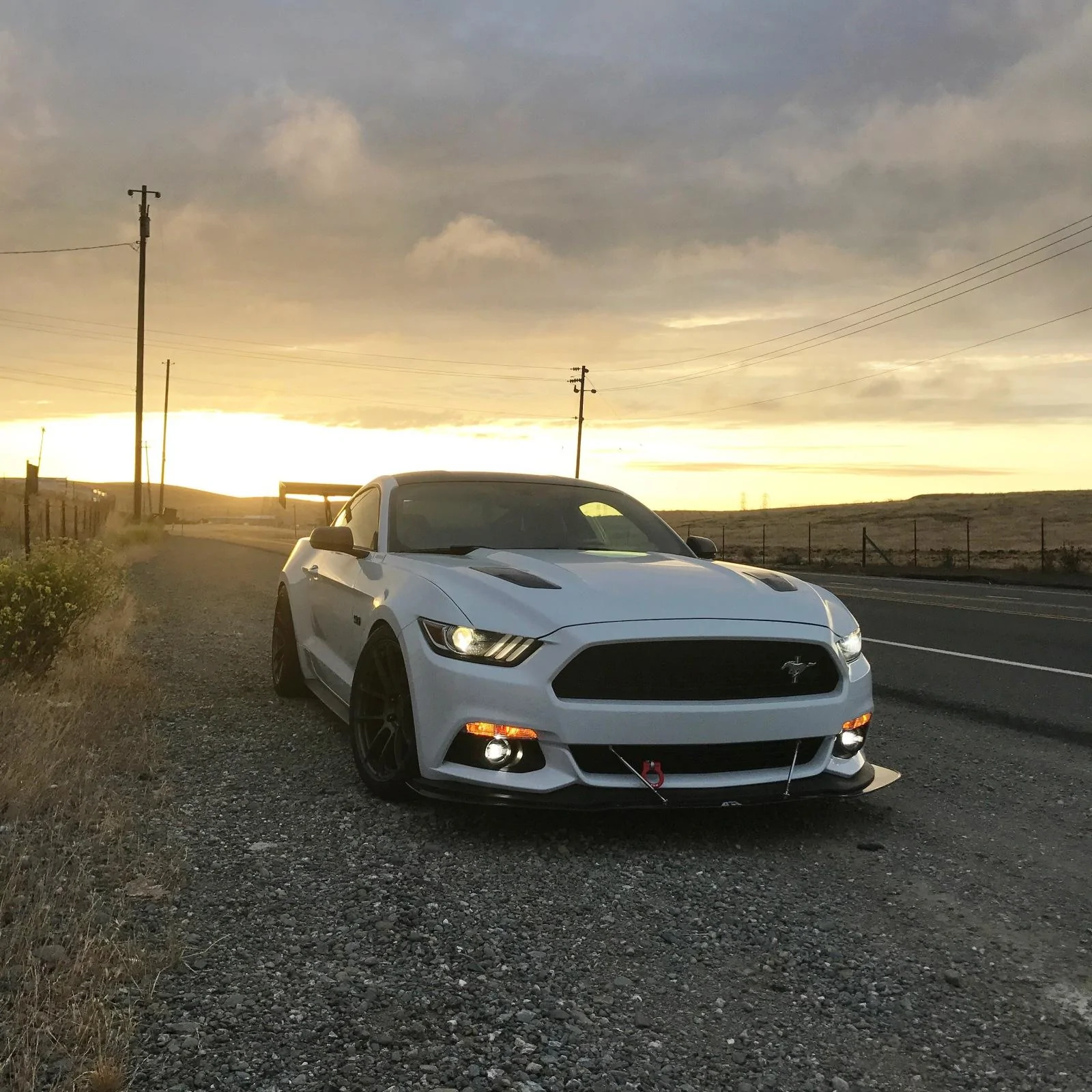

Everything that is installed on the car, I have installed myself. Here is a picture of my car:

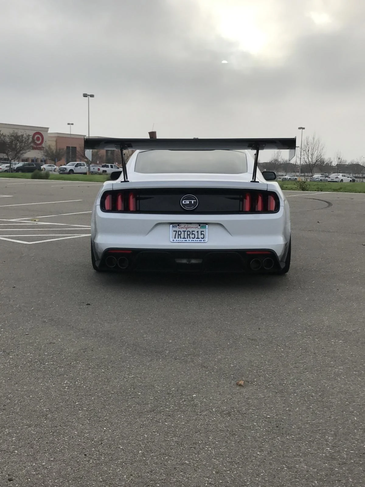

Thanks. Here is a picture from the back:
