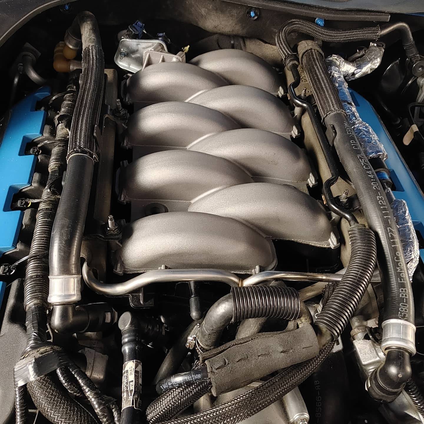

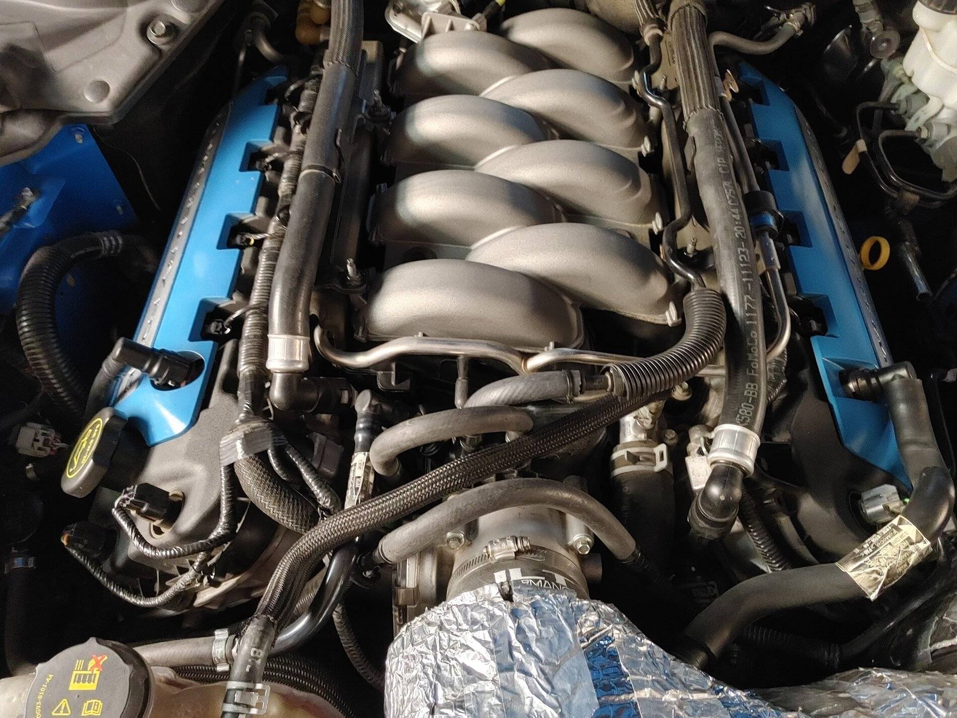

Decided since I went IMRC delete, I'd clean up the vacuum routing up front. Got rid of all unnecessary lines.
Before:
AFTER:
Which was a BIG MISTAKE. Every once in a while the car would stall coming to a stop at a light. Well that's weird I thought. Maybe on a long shot it was cause of the IMRC delete. Nope. In my haste, to put lipstick on a pig, I deleted the idle bypass. So, I made a new one. Lesson. Learned. Haha.
