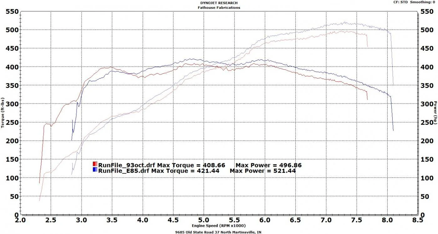

I have flex fuel as well and am a lot less than that difference. Only a ~14hp difference from 91 to e85.
I'd say I'd your dyno atmospheric conditions were the same as the op in this thread that gap would increase. The iat for these was 110°.

Pretty similar, however I have the factory air intake, as far as I know that is the only difference.
Here is my Dyno sheet for reference:
I am hoping to see some more performance parts out soon, I want to achieve 550whp next.
Also I was 466 baseline on 91 and 511.8 tuned on 91.
I think the reason you gained less with e85 is that you looked to have a monster tune with 91. I am pretty shocked e85 didn't get you a bit more, did you happen to drive the car with each? do you have the dyno comparison?

I guess I'm missing something here. How did you get 407rwtq on a bone stock car? Every gt350 I seen stock Dynos in the 370 rwtq range.
You are basically at a 11.5% drivetrain loss on hp 526-11.5% = 466
429 tq - 5% = 407 rwtq.
Something isn't adding up
