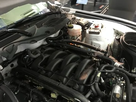

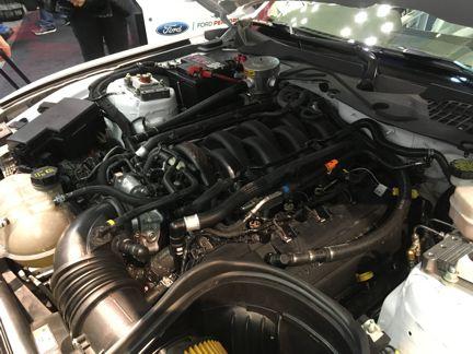

It looks like he copy and pasted it from http://performance.ford.com/enthusi...k-at-the-5-2l-aluminator-xs-crate-engine.html which isn't a confirmation either way. We've known about the 5.2 Aluminator XS since last year's PRI. The press releases for the FP350S don't mention Aluminator at all. They seem to be being intentionally vague on all these race car powerplants. :\
The car gets a version of the Aluminator XS with the GT350 Intake instead of the CJ Intake. Final HP numbers are not known, final engine map is not complete. Final Price is unknow, delivery dates unknown, production 30-50 units.

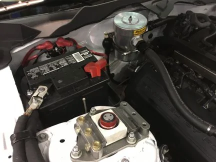

These are some of the changes from the GT350:

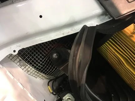

1. OEM Oil cooler is replaced and relocated with a Setreb unit mounted in front of the radiator with new ducting to the radiator
2. OEM transcooler is retained
3. OEM Diff cooler is removed and replaced with a front mounted cooler in the OEM oil cooler location

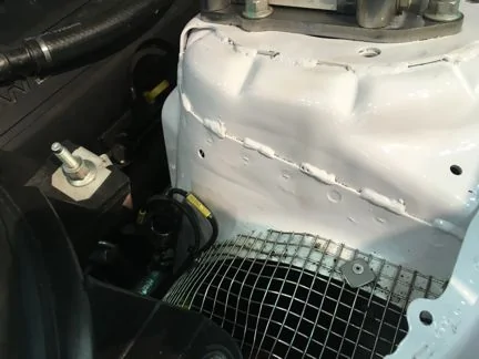

4. Inner fender is cut down for weight savings
5. All plastic fender liners are removed
6. rear package shelf and seat supports are removed

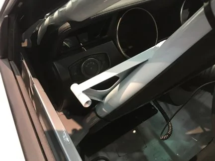

7. doors are gutted and locks are removed, simple cable pulls are added to release door latches
8. Cage is installed by Watson but is not of Watson design and differs from what they are allowed to sell on their site.
9. Cars are prepared by Multimatic, and available for purchase via Ford Dealers

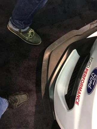

10. Shelby front splitter is retained and a carbon reinforced spliiter with 3/4" air dam is added. rear Shelby bumper and lower fascia are unchanged
11. They are using the Oil separator from Watson Racing site but it is made by Peterson Racing and it serves both heads
12. Wheels studs are from MSI Racing Products, not 100% sure but 99% sure

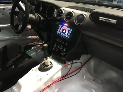

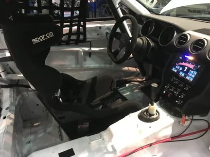

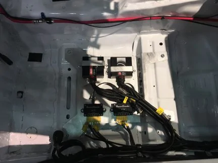

What is all that stuff in the screen can the tech pack car do that?
lol no. Completely different. I'm guessing that's why they changed from an AIM unit to the Motec. For all the extra fancy displays.
No, it is part of the Motec data logging and info display system in the FP350S only, there is very little of a GT350 left in this car, the trans, rear end, radiator, and glass is just about it.
Exactly. Not even the same engine. Just sheet metal and drivetrain minus engine.

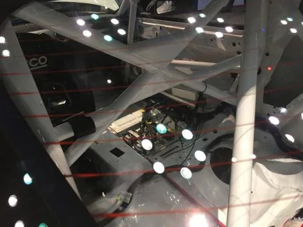

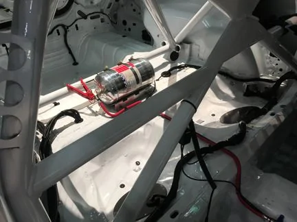

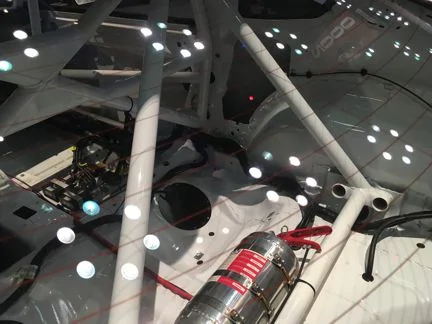

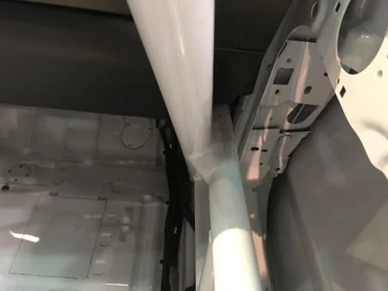

The engineering on the cage design is from Multimatic but manufactured and installed by Watson. The design work was done around 2013 and as installed in this car no longer meets some spec. The bent door bars on the driver side will have to be straight as on the passenger side. It isn't a change favored by anyone other than a certain sanctioning body and will be done differently. Specs also call for a full 360° weld where tubes converge, something that wasn't always done on tbe S or R model cages. The circular holes/patches you see near where the door strikes are were for access to be able to do this.
Cars are not prepared by Multimatic. This one was done at Watson. They could end being done at Watson, Ford, or Multimatic as I mentioned previously.

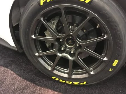

The wheel studs on this car are actually stock R model studs on stock Ford hubs. They are not MSI studs. The production version may end up using MSI studs but not just yet.

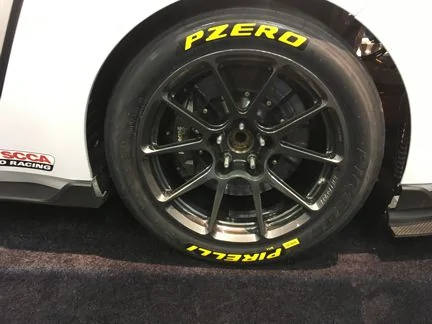

In addition, this car is indeed using the production GT350 aluminum knuckle or upright. This allows a radial mount caliper design, preferable in terms of strength, but also because the GT350's wheel hub assembly is a much more robust design than that of the lesser GT or that of the previous generation S197 cars.

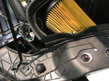

Regarding cooling and in addition to what was mentioned up above, this car is using a stock radiator for engine cooling. Apparently the minor changes made to the block/heads on the GT350 over the previous Boss cars proved to be substantial in terms of cooling efficiency.

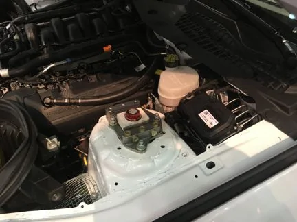

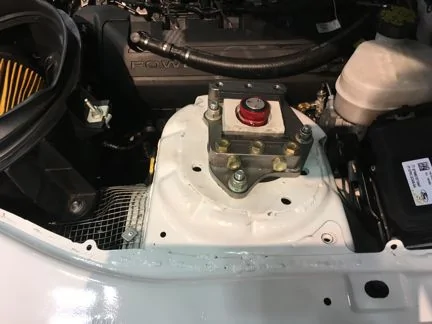

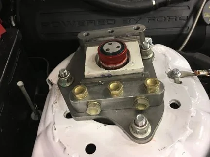

The camber plates...
Alignment is set and caster is fixed ~ 7° positive. These allow you to then loosen the three vertical fasteners (gold plated in the photo), followed by the two horizontal fasteners. You can then remove and move shims around from one side or the other to quickly and accurately change the camber setting to a known degree. Changes can be made quickly with repeatable accuracy. These were done for Ford Racing and just might become available some day. Multimatic has them in a more "finished" form but a bit on the VERY pricey side.

That's pretty "rough" but I agree that shims are far better than slots in terms of repeatability and preventing camber change.
