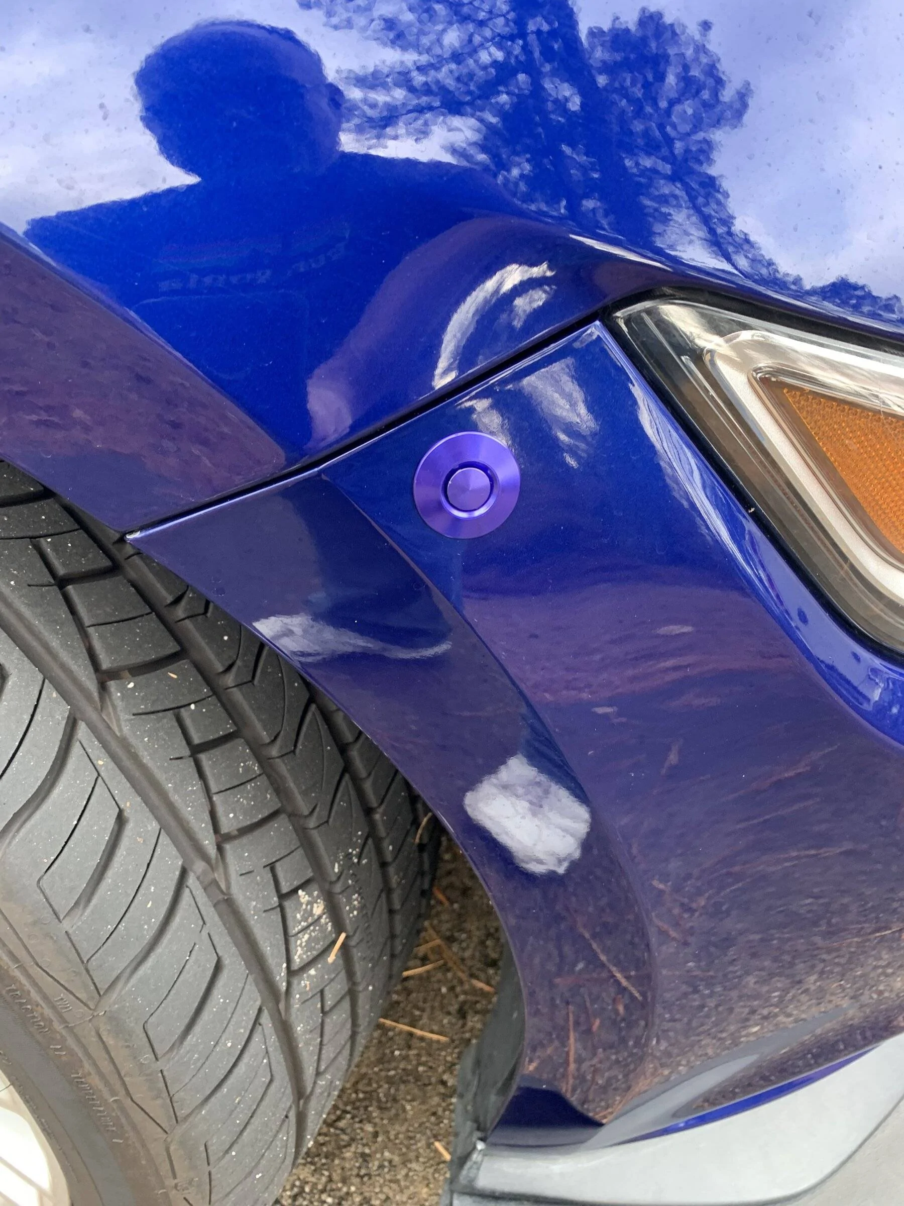

You could try quick latch pins, many of us with 15-17’s use them as the bumper retainer tabs break easily on those years. Both the quick latch and knock offs are sold on amazon. I went with one of the knock offs because it matched my DIB 16 better.

There are many size to pick from. What size is best? I hope to find them in white
I think mine are the 1” size. I see black, red, blue and aluminum either polished or not. You need 1 per side. I would get 4 nylon lock nuts (nylock) from the hardware store and use them in place of the nuts they supply.

That looks good

Thanks, CJ ponyparts has an install video online. It’s not hard to do. Just take your time and remember measure twice, drill once. Luckily if you do mess up there’s a little adjustment where you bolt it in. Some don’t drill the black plastic block, some do. I did as it makes the repair more stable.
