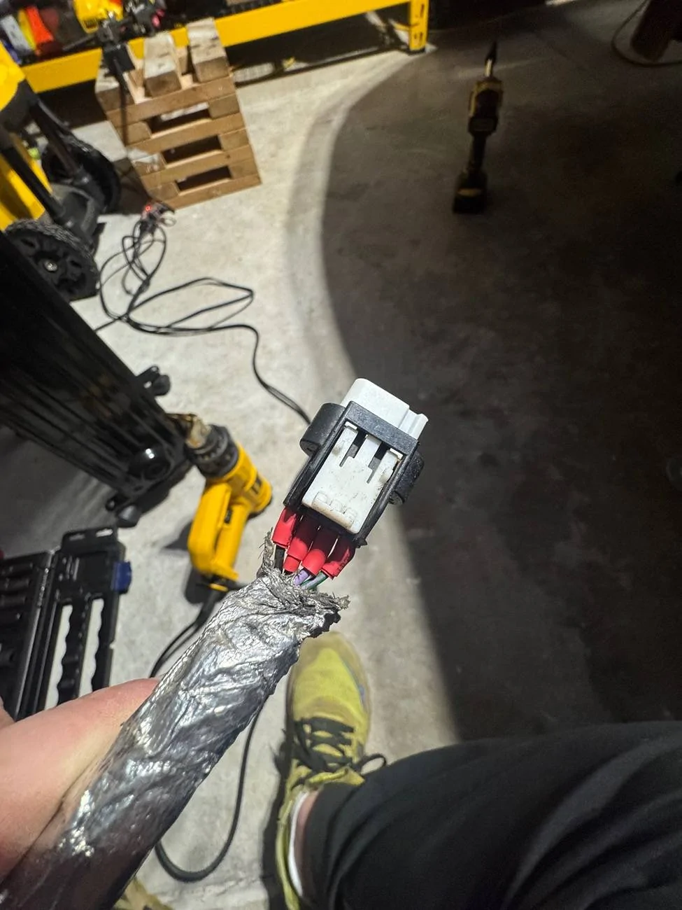

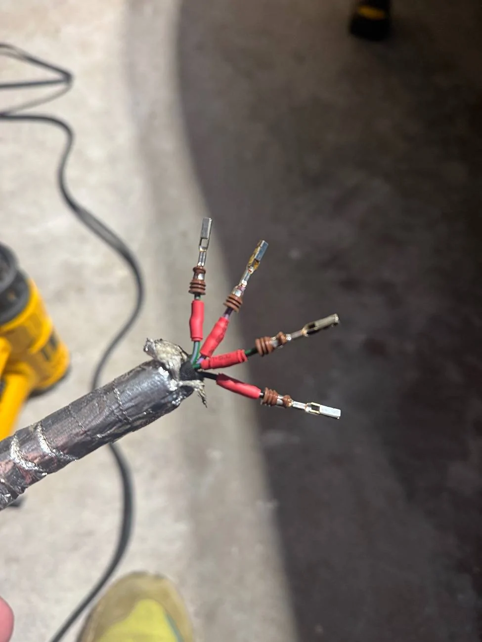

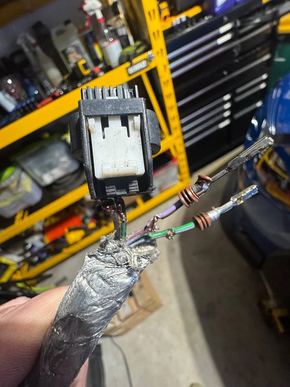

Had this on my Mach with the stock catback after I added the Steeda X Pipe. If you don’t have enough play in the system to shift everything back you might need to trim a little bit off of the mid pipe or catback to give yourself enough clearance.
Then you’ll need to address the wiring. I depinned the wires from the connector, straightened them out, isolated them from each other, and then double heat shrinked each wire. You’ll be good to go after that.

If you went that route you are not addressing the root cause and in my opinion it’s only a matter of time before you encounter the same issue. I did not see the need to buy a whole new harness when the exhaust was off the car and I could fix it for $free.99 with stuff I already have. You are going to have to drop the exhaust regardless to determine what the problem is.
The catback needs to shift back 1/2”-3/4” to gain proper clearance.

I don’t know why this is so complicated 🤣!
1. Loosen up the catback hangers and unhook them on the passenger side.
2. Loosen the coupler from the mid pipe to the catback on the passenger side.
3. Disconnect the harness for the active exhaust.
4. Remove the passenger side of the catback from the vehicle.
5. Inspect the wiring right before the connector. If it’s frayed a worn through the insulation your exhaust is sitting too far back and you need to move the exhaust towards the front of the car.
6. If you don’t have enough play to move it 1/2” to 3/4” towards the front you need to trim either the catback or midpipe to allow this. If you don’t you will encounter the same problem, it’s only a matter of time.
Extra heat wrap won’t help you, a new harness will fail again, etc….
