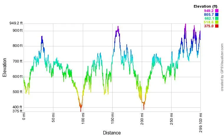

First leg of the trip complete. Tank included 24 miles of my normal commute (90/10 highway/city) and 13 miles of stop-n-go traffic getting out of town today. Traffic through Austin was 35-65mph, but the remainder of the trip was at 80mph on cruise control. Headwinds varied from 10-20mph nearly directly out of the south, so head-on. Ambient temps started at 101, dropped to 90 at the end. Load in the car is me, a full tank of gas, a bag of chips... well, a small duffel bag and a backpack. And my fly rod.
Elevation difference start/end is only about 575 feet:
20180825_80mph-profile by clair_davis, on Flickr
Fill-up saw 14.117 gallons over 337 miles, for 23.87mpg actual, 25.5mpg per the trip computer. Would likely have been at or above 25mpg if not for nearly 30 minutes of stop-n-go a the start of the trip. That would have been on par with my last 80mph trip.
Return trip will be a little longer, with more elevation changes mid-way, and I'll make that drive on Friday.
Wow. Very comprehensive -- color me impressed.
