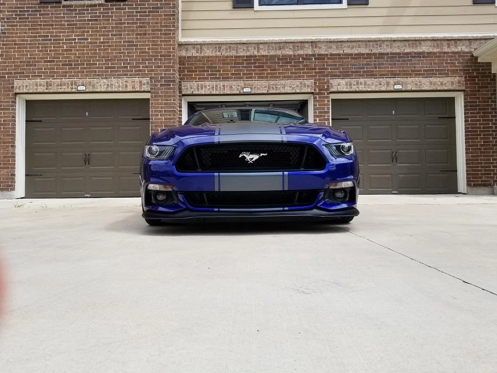

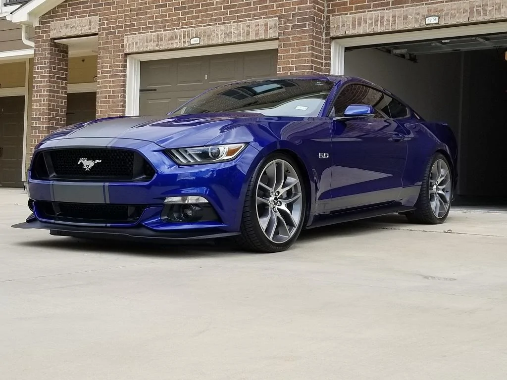

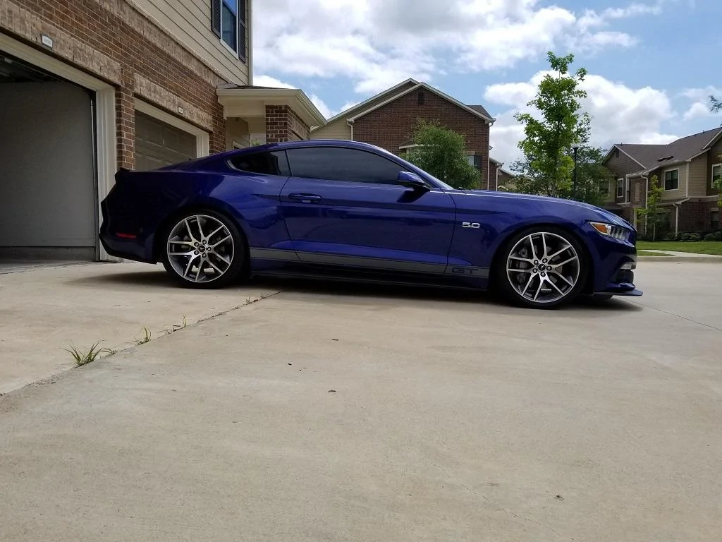

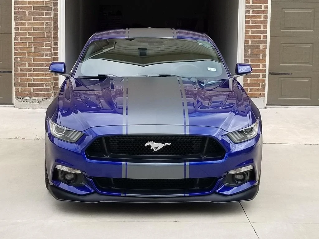

Installed this over the weekend. A few notes:
This Lip does NOT fit the PP cars, I guess the PP cars have a different set up on their Undercover. I only know this as the guy I bough it from has a PP Car. My car is a 15 Premium. Was a direct bolt on. The MMD Site does not specify this.
Install only took an hour from start to finish with hand tools.

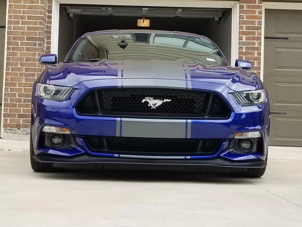

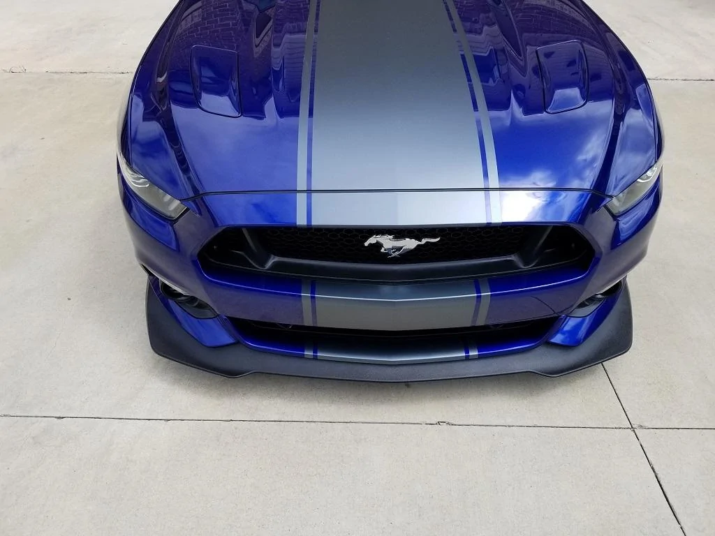

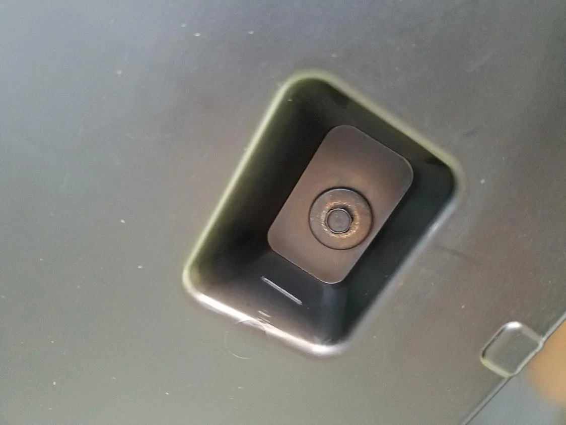

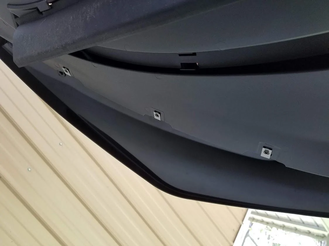

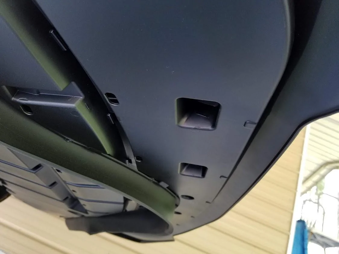

I just installed this on my 2015 EcoBoost Premium (not performance pack) and the install went well, with a couple of things you discover along the way.
1) The belly pan is not going to connect to this chin spoiler in 6 places, so it's 2x3 spots on left and right
2) It still feels sturdy to me, but I see not other way to reasonably attach it to anything so it is what it is
3) The final 6 screws which all line up center / front are going to go through the belly pan and through the spoiler into the bumper, so do not attach those until last
I hope these pictures help, I think it looks great! I hit a raccoon and had to replace many front end parts this week, so thought I would go with something new (pictured without 10" stripes replaced yet, since I had to get a new bumper).

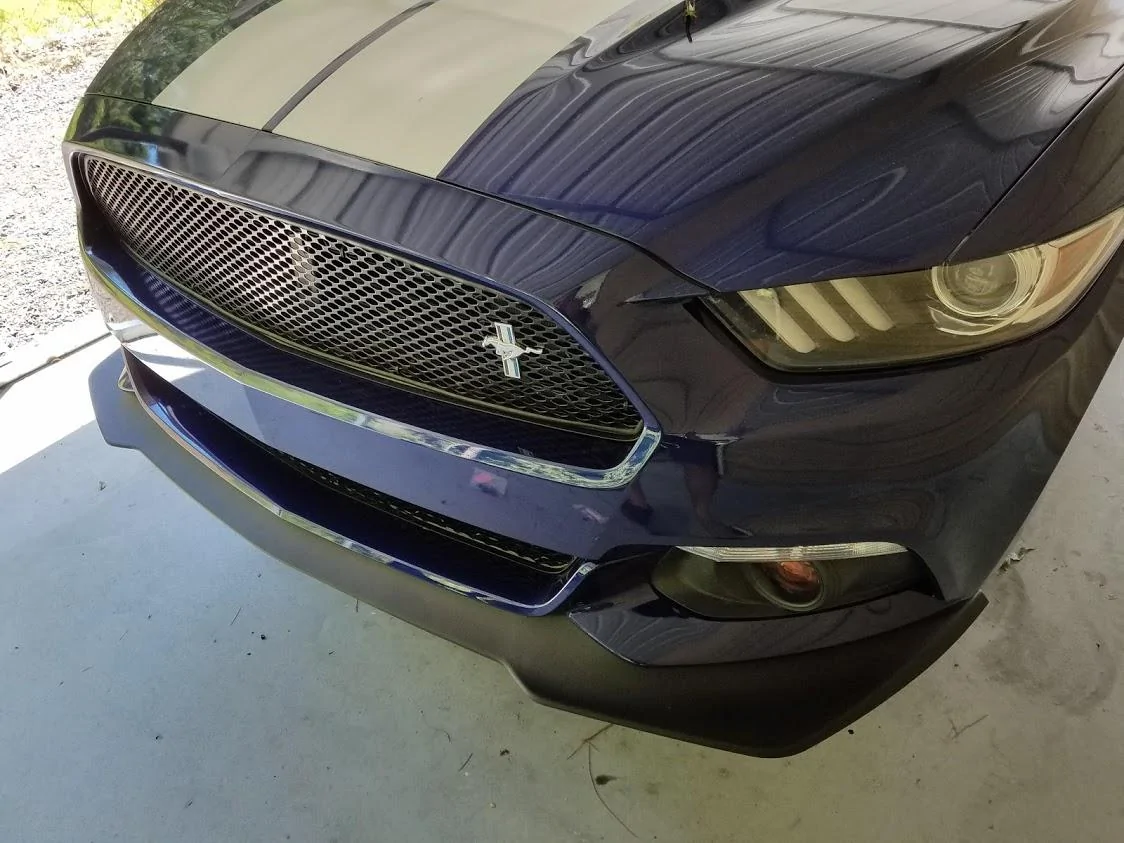

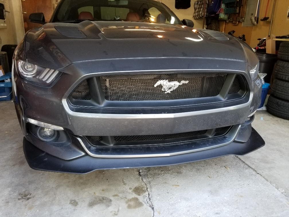

Sorry guys, I forgot to add a pic of mine after the install. I love the more aggressive look. Never going back to another splitter. I ended up scrapping my GT/CS splitter. I accidentally curbed the splitter and tore all the center holes.
I added the new grill from Custom Car Grilles at the same time. Sorry the car is filthy.
