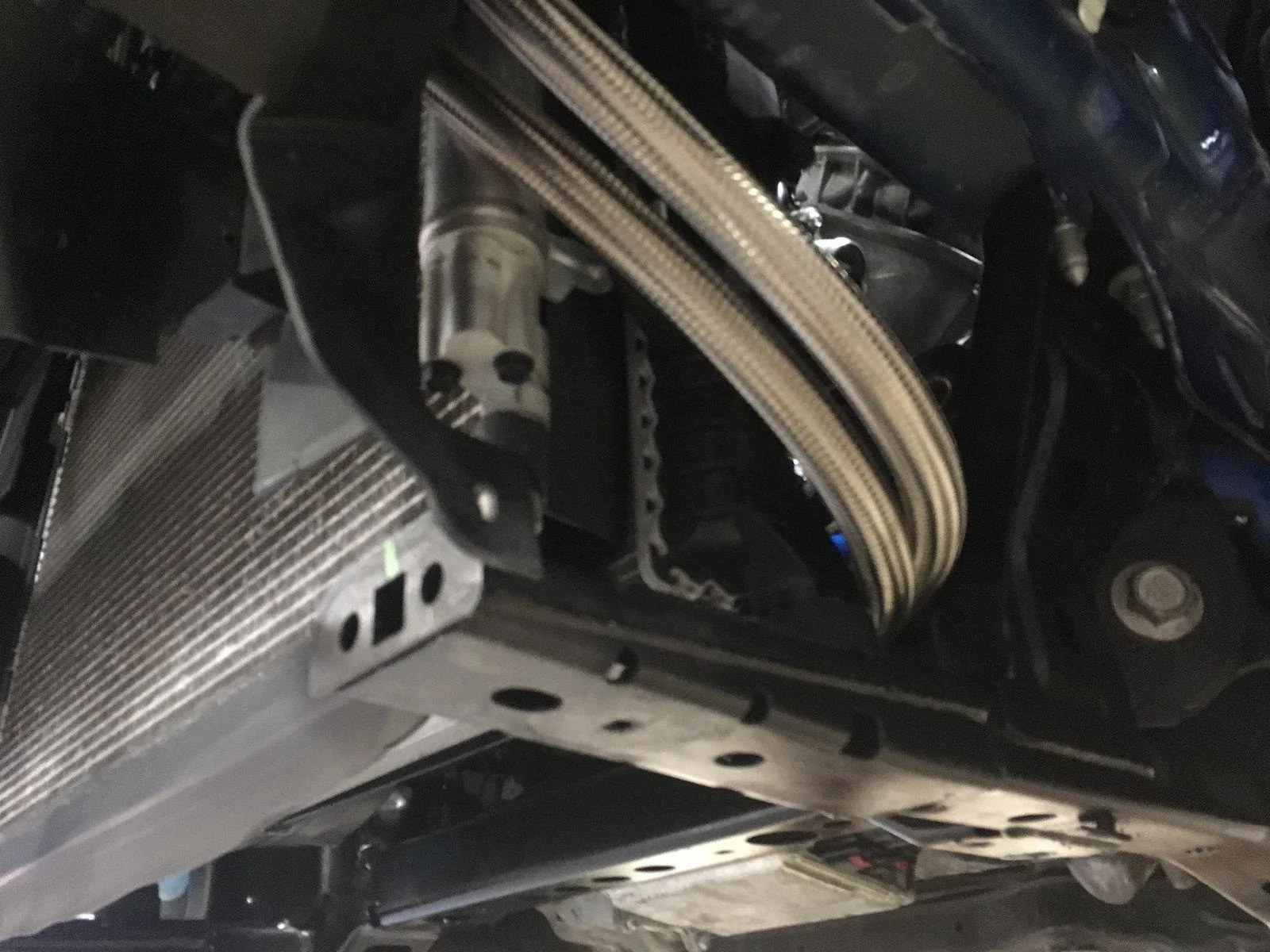

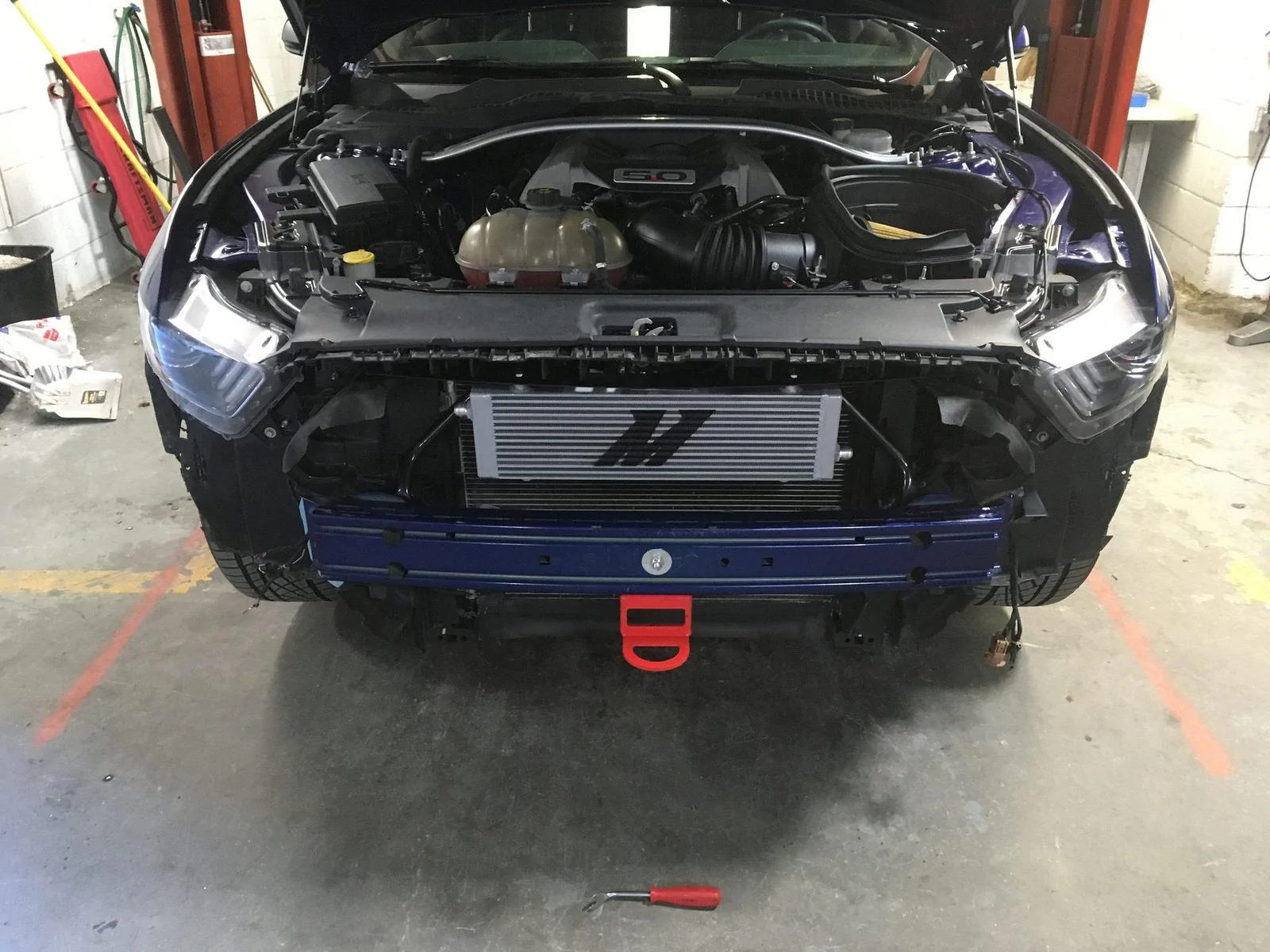

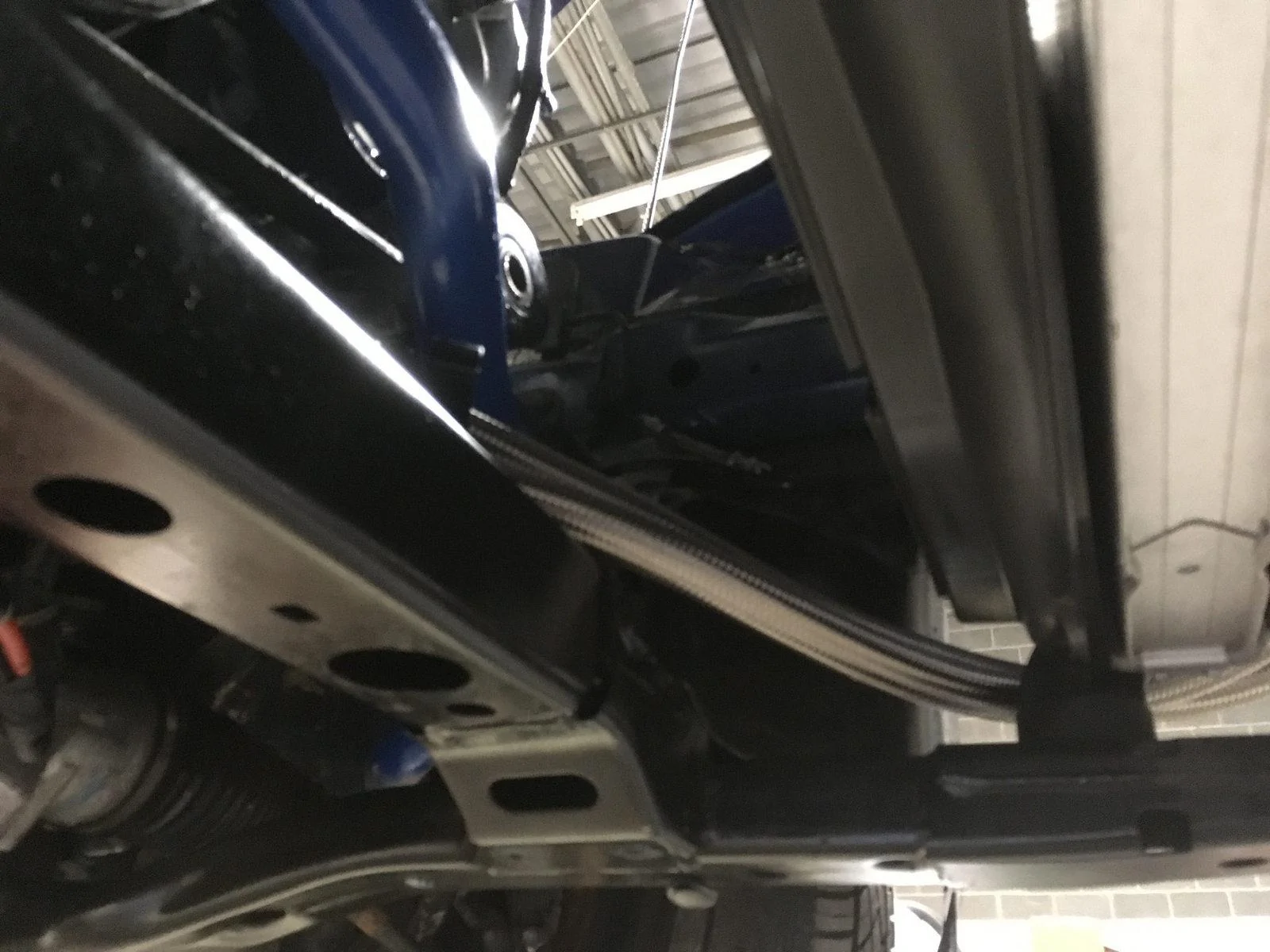

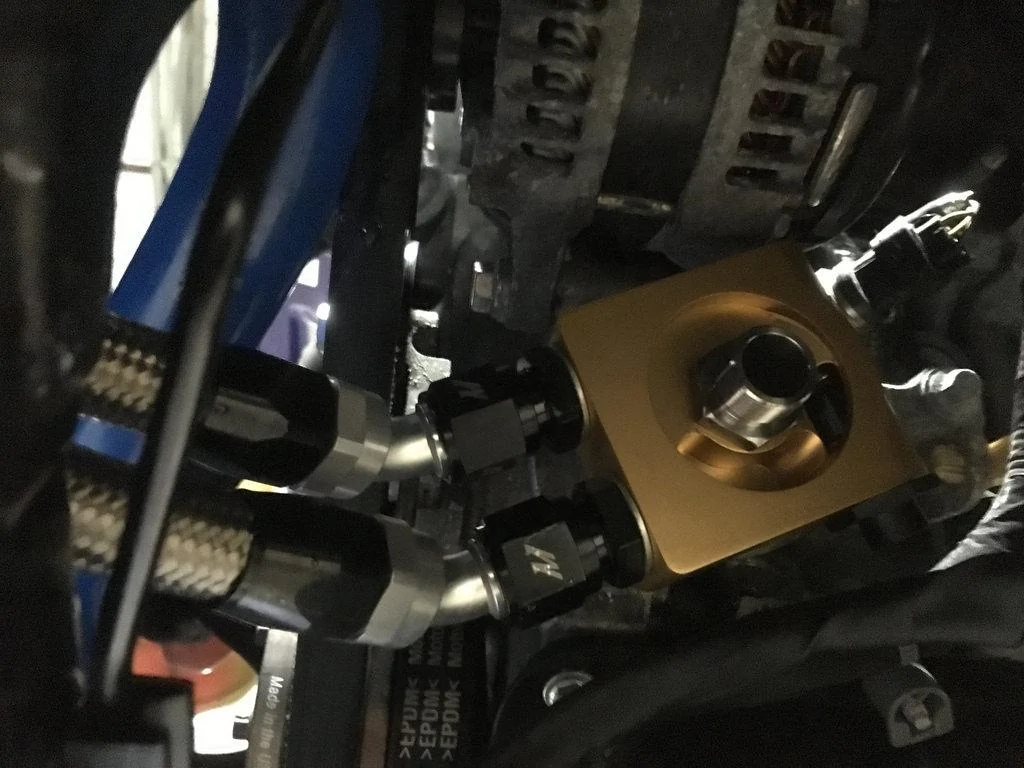

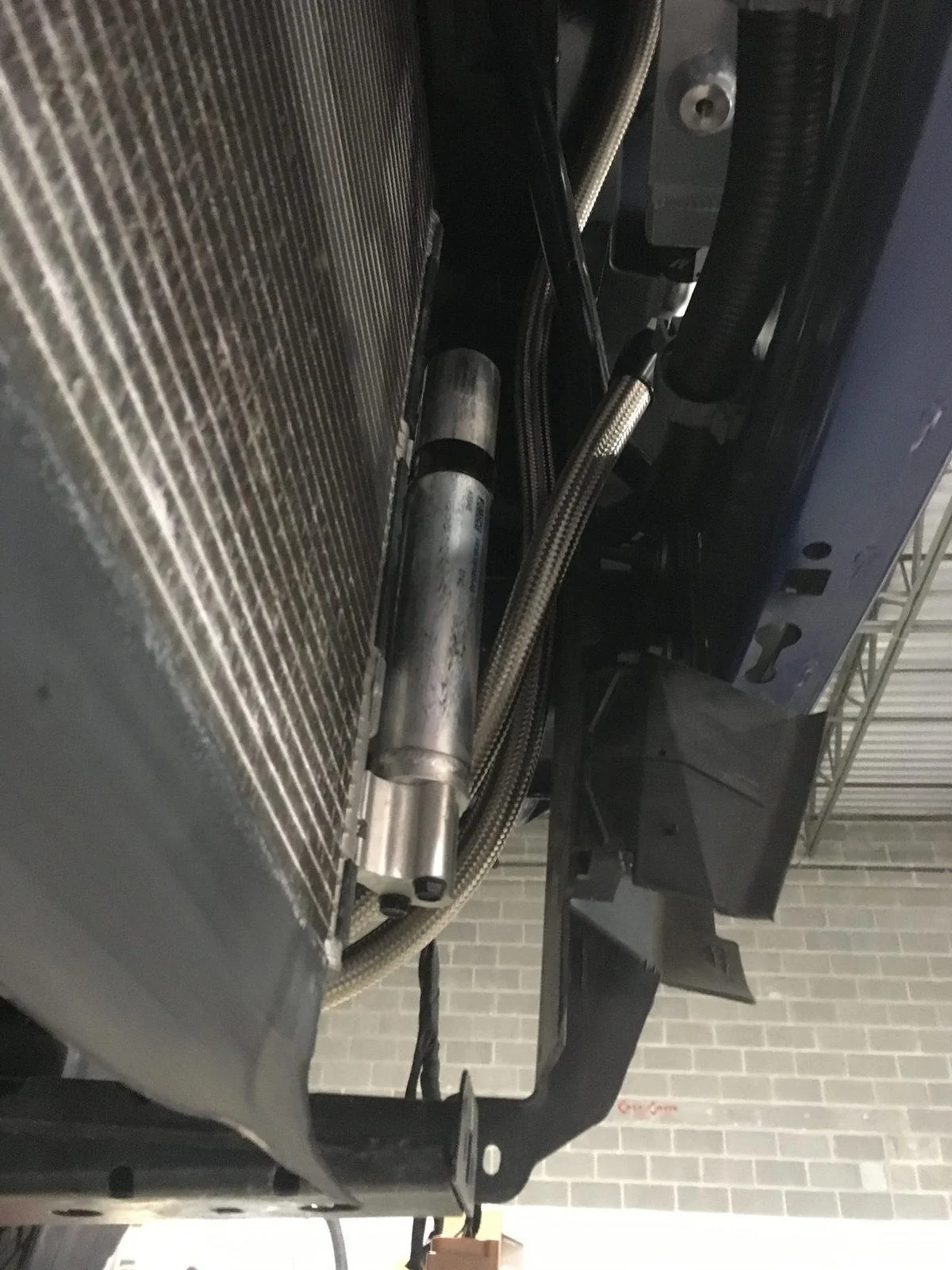

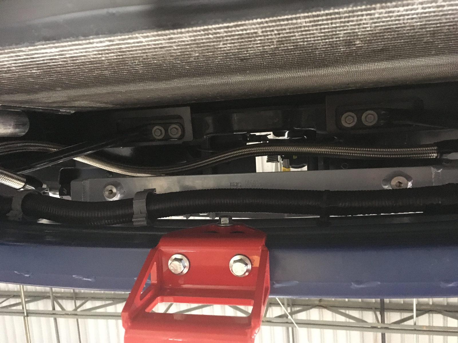

I decided to finally install my Mishimoto Oil Cooler. Overall, the installation went well and the fitment of everything makes sense. I would have really preferred pre-bent hoses, because these metal mesh hoses are extremely abrasive to everything they touch. I will be putting split loom over all of them, which I think will be helpful for long-term reliability, too. I had to tilt the Mishimoto oil filter sandwich plate a little more downward than their installation video implies, but I have a Steeda sway bar there so, to be expected. No leaks, which I was happy to (not) see. I do wish the sandwich plate wouldn't rotate when you torque the bolt that holds it in down. I feel like there could have been some detents or standoffs CNC'd into the design to lock it against something, but oh well. Mishimoto's install video didn't mention you need to remove the two black metal brackets that PP cars have to install the replacement air diverter panel thing that holes the actual oil cooler radiator - wasn't a big deal. You'll need to be careful that the line behind the actual oil cooler radiator thing doesn't interfere with the underside of the hood latch. I kind of wish they provided an oil line that would follow along behind the front bumper crash beam like the wiring harness that's there does, and then come upward to connect to the coil cooler. Or put both oil cooler connections on one side (if possible). There's always ways to make things better, I guess. For what I paid for this (much less than new; bought it off a guy who didn't want to go through with it), it's good stuff.
Hopefully over time it does not develop leaks or problems. It better not.
Oh, and I also installed a 170* thermostat, Ford Performance tow hook (what a bitch that is!), and did a coolant flush at the same time. Coolant that was in there looked fine but I do track the car so I'd rather flush it early. Took me a while to get heat back in the car, but just had to do some high idles. And I installed an oil temp sensor into the sandwich plate, but I didn't get a photo. I will when I do the wiring for my gauge cluster I'm adding soon.

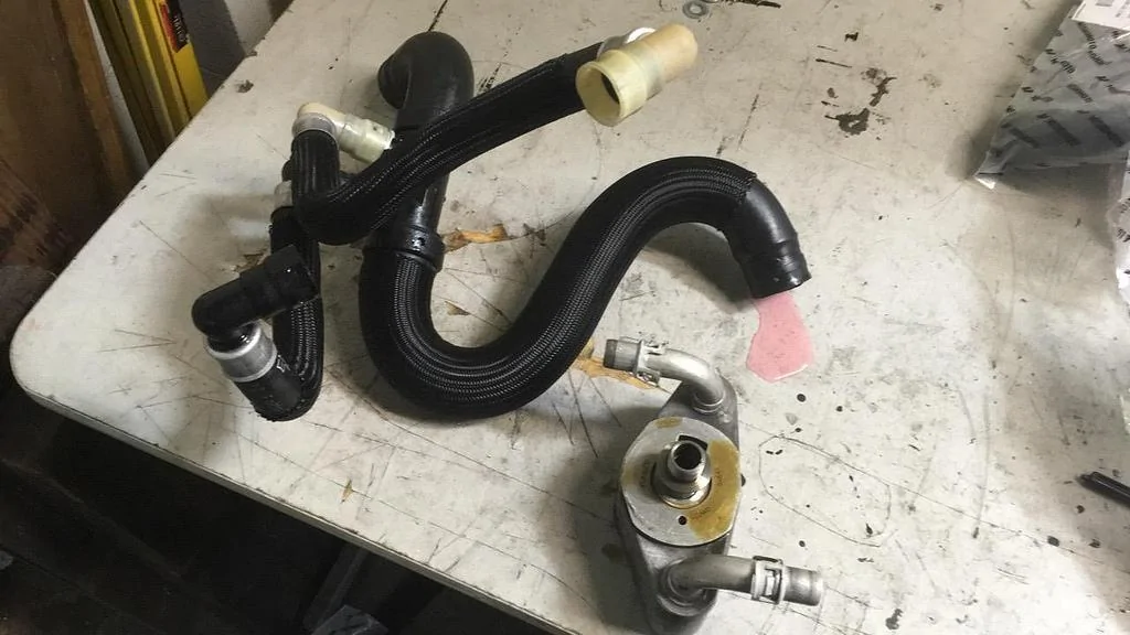

This is what you end up removing from the car:
