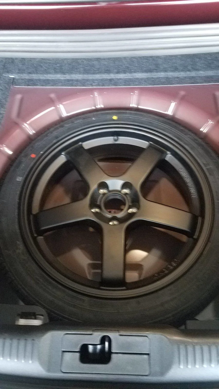

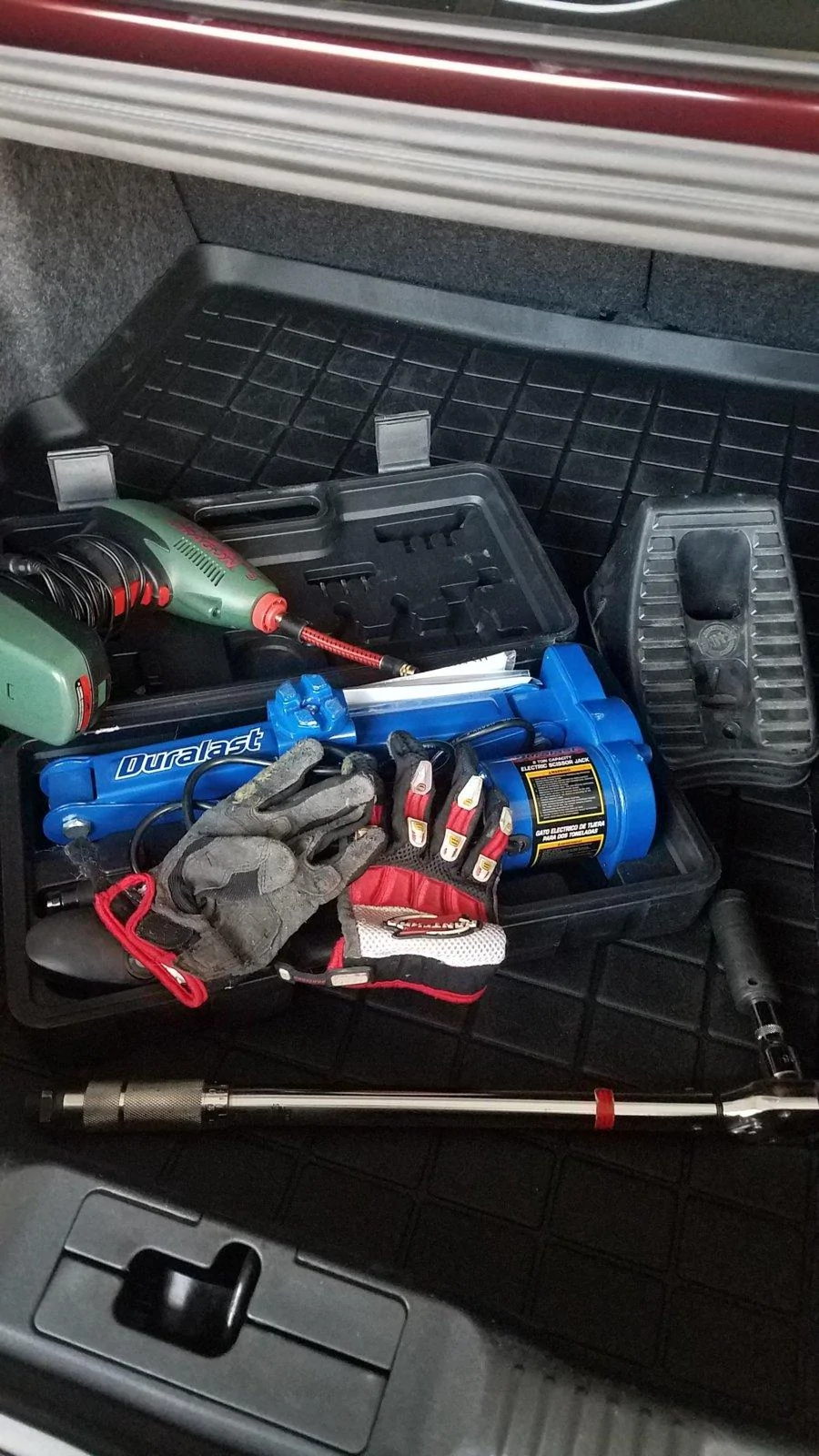

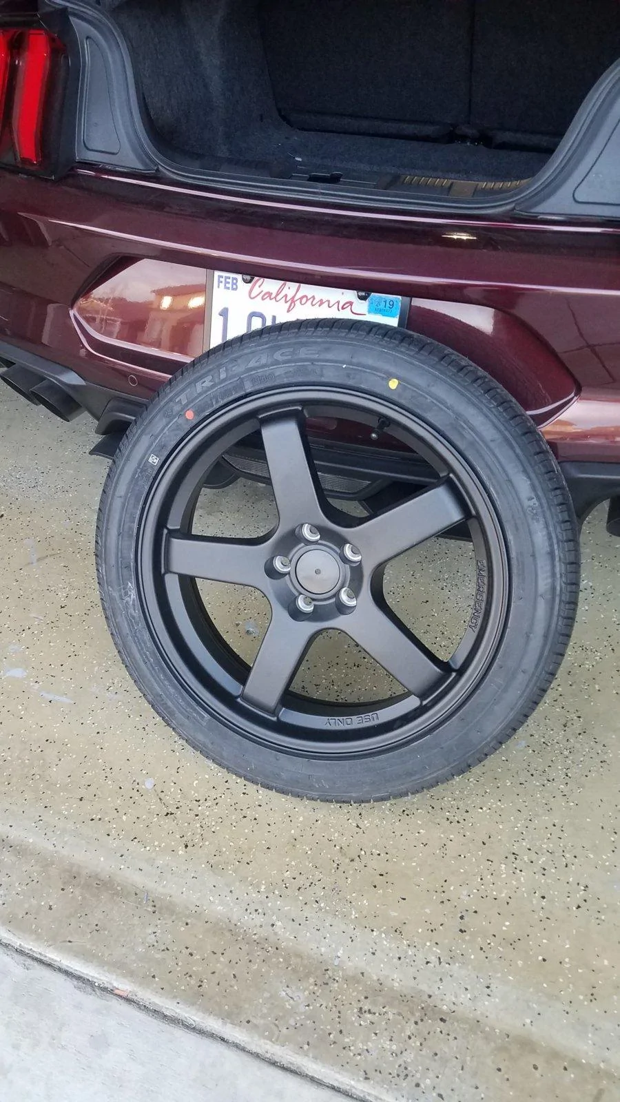

I put together a spare tire kit for my 2018 PP1 GT. Here is what I did . Tire and wheel are from /www.automotiveauthorityllc.com. The jack, torque wrench, socket , extension and tire blocks are from AutoZone, yes it is a powered scissor jack. I added a Air dragon for adding air for slow leaks and finished it up with a tarp and gloves.

How much was it?
1 old racer
Feb 20, 2018
89
1,725
2,376
Fontana CA
Will
2018 Royal Crimson GT PP1 prem., and others
the tire/rim was 399 with free shipping, (check out the link for details), and the jack was 99. the torque wrench was 20 bucks I think the rest I had. If you ever have a flat on the freeway or most streets without a spare the only choice is to have your car towed to a place to get a tire. I had this happen with another car and I will never be without a spare again. very bad memories.
