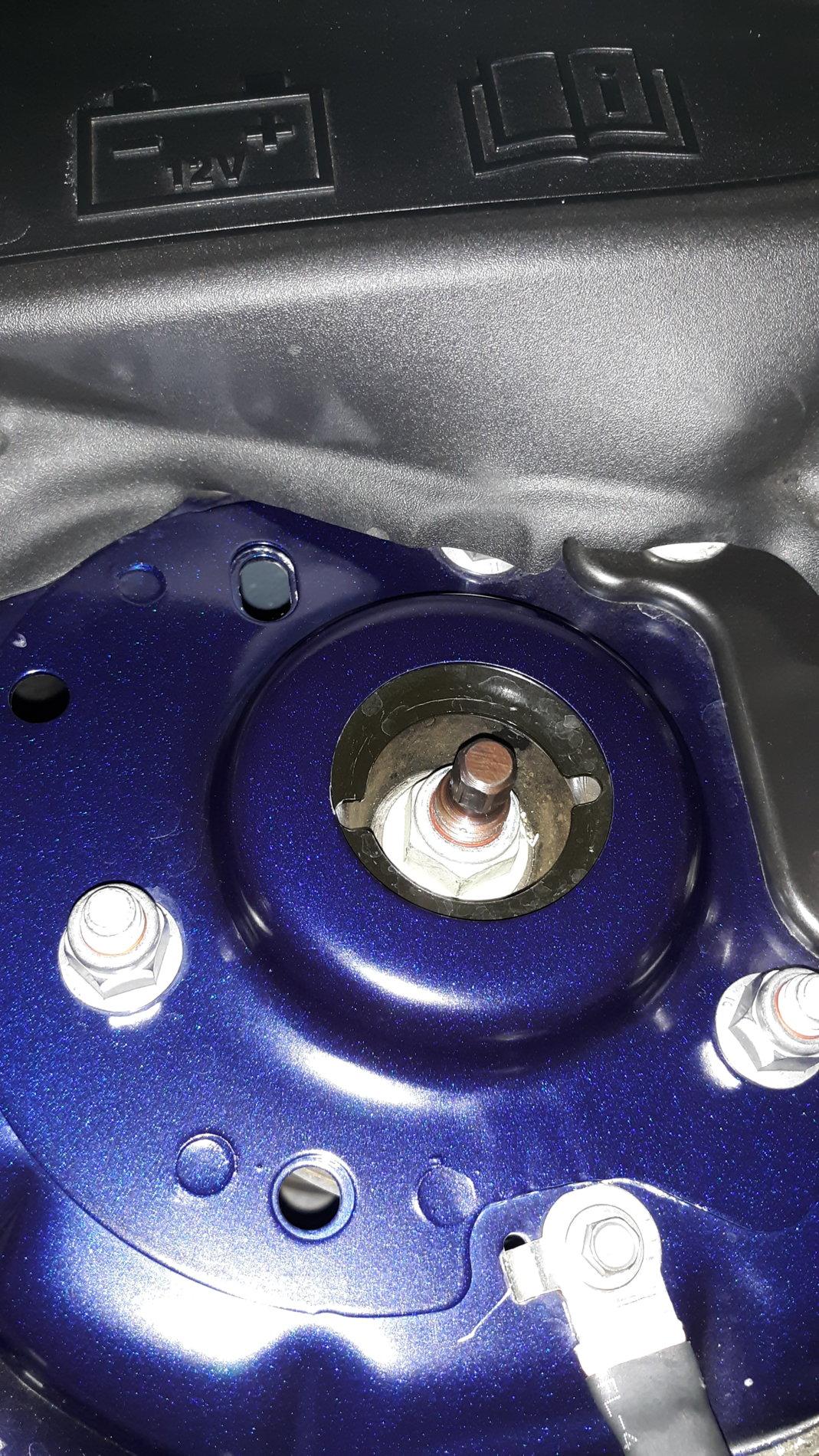

Check the nut tightness on top of both struts. My right front was loose from the factory on my '17 V6. Made quite a racket inside the car every time I stepped on the brake while in motion.

do you mean the strut towers under the hood? or the actual strut? how would I access the strut?

Make sure this nut is snugged down on this stud. Mine was loose from the factory and my strut was banging up and down in the top mount.

do you know what size nut it is?
