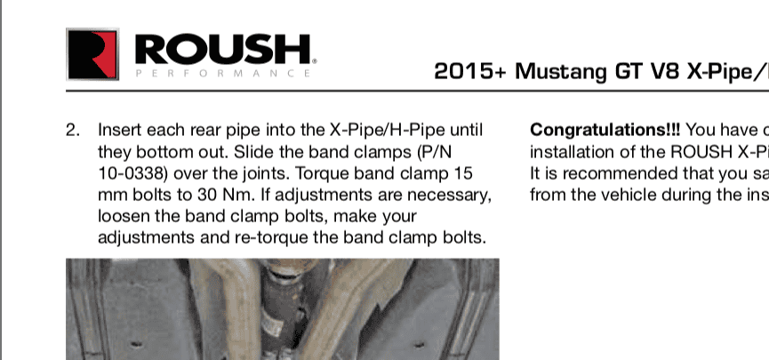

Here is a doc, if you want prof of the torque value. 30nm = 25ftlbs
Greg
