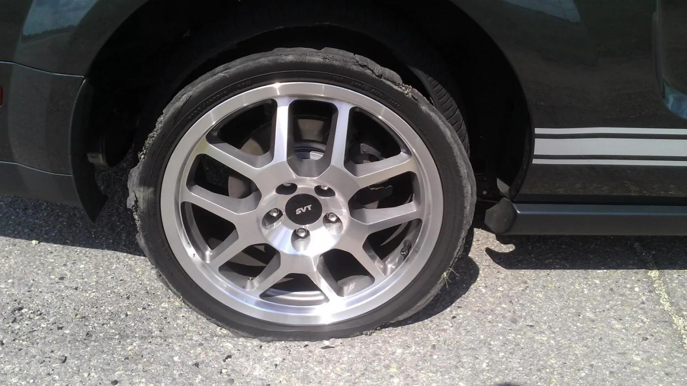

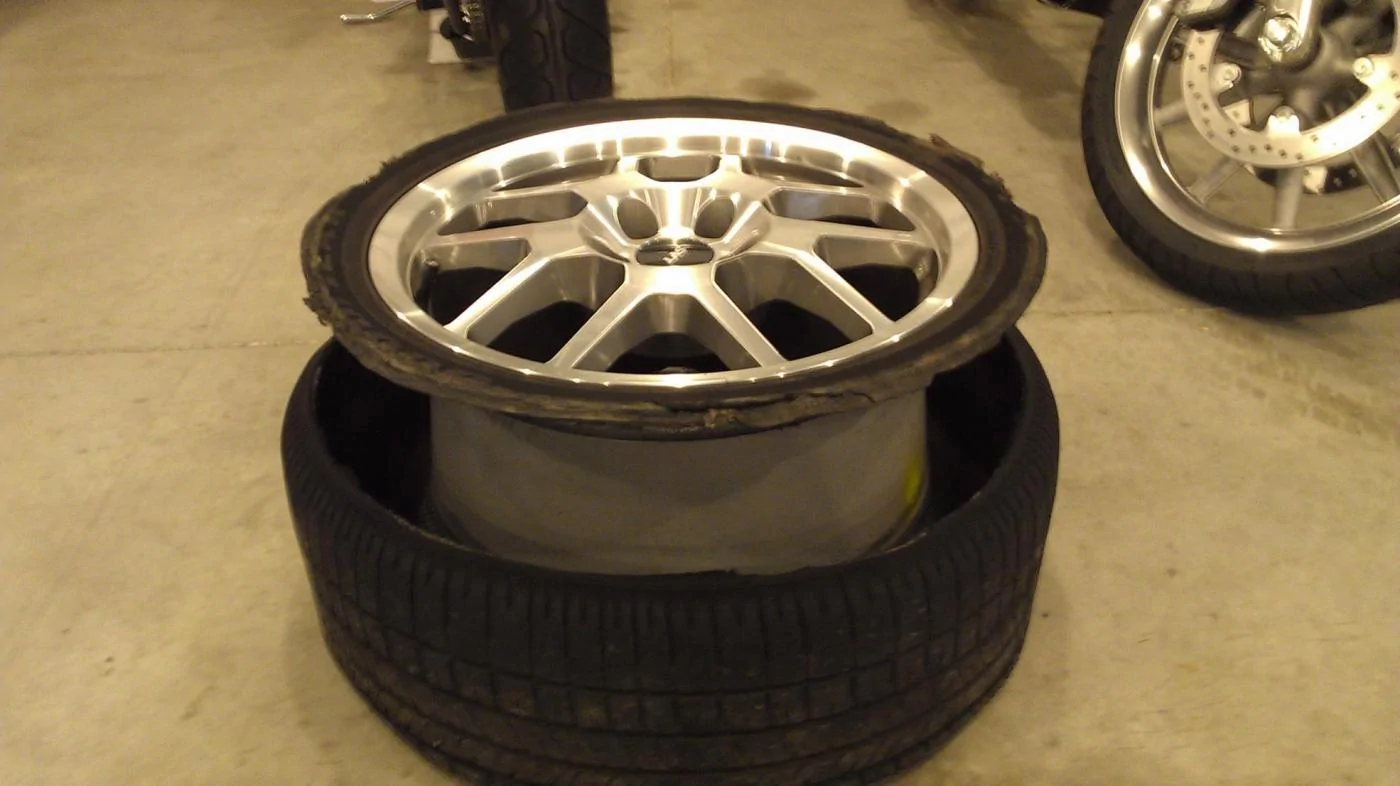

Mine didn't "blow up because of sizing relative to the rim widths", but the level of control following a sudden deflation due to road debris was worlds apart between min and max recommended. It's this controllability that I'm most familiar with, personally.
Heat build-up due to excessive sidewall flexing is a well known phenomenon, and on too narrow rims the heat can become concentrated in a region of the tire not particularly designed to withstand it as well. This from an actual conversation with a tire engineer.
The min recommended fitment wanted to lurch every which way but straight from even the gentlest steering inputs.
The ~max recommended fitment was hardly any less controllable than the car's OE wheel and tire fitment and more capable than I could explain and expect you to believe (so let's just say it was harder than most people generally drive and leave it at that). But I do have a picture that should give you some idea how much tire damage we're talking about by the time I had even a poor place to pull over and change it (and how much the extra lateral stiffness on the other tire on that axle matters). I did have to cut a few carcass cords to completely separate the outer sidewall from the rest of it, but only a few. Didn't hurt the rim at all.

Slightly related semi-threadjack, but I had a stock size rear on my GT500 have a similar failure mode (car was very controllable despite it).....

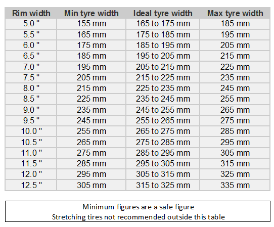

You really shouldn't be putting passenger car 295's on wheels that are only 9.5" wide. 10" minimum.
285/xx is the widest passenger car tire that 9.5" wide wheels should ever have to support, and 9" wide wheels are good for up to 275/xx - per Tire & Rim Association tables.
A 295/xx LT tire would probably be OK'd for 9.5" wide wheels if you can find any, as LT's are designed to somewhat different needs and requirements and allow fitment to narrower rims. But Light Truck tires on a Mustang???
Why people are so ready to throw away any of the performance that their wide tires promise by squeezing them down onto too-narrow rims has never made much sense to me.

So would it be best to put a 305 on an 11" wheel instead of a 10"? I am looking at having my stock rear PP wheels widened to 11" or maybe 12" and run a 305/35/19.

Would you guys recommend a 285 or 295 on a 10" wheel? I plan on doing quite a bit of road course events.
Yup. Maybe even 11.5". Depending on profile, 10" may not even be wide enough to fall within the recommended rim width range for a 305 tire.
For any road course duty I'd rather see the 285 on 10.5" or even 11" and the 295 on 11". Slightly wider than "measuring width" is going to favor response and linearity, generally at a slight ride quality penalty. For 100% street-only duty, 285's on 10's and 295's on 10.5's are probably better combinations for most folks.
