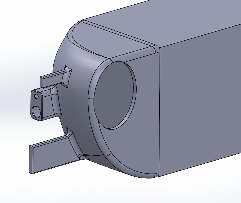

INTERCOOLER
When you slide in the MAP intercooler it will go in much easier as the end tanks are not square like the stocker. I was very happy to see that the MAP intercooler does not rubb against the mishimoto oil cooler lines. I think this is one of the better options as far as intercoolers go because with the mmr and fftec you are going to be cutting and removing the bumper as well as potential rubbing of the oil cooler lines. TBH I was going to get a mishimoto intercooler as it is a similar design, however I did not and part of that is due to the quality of mishimotos products.
