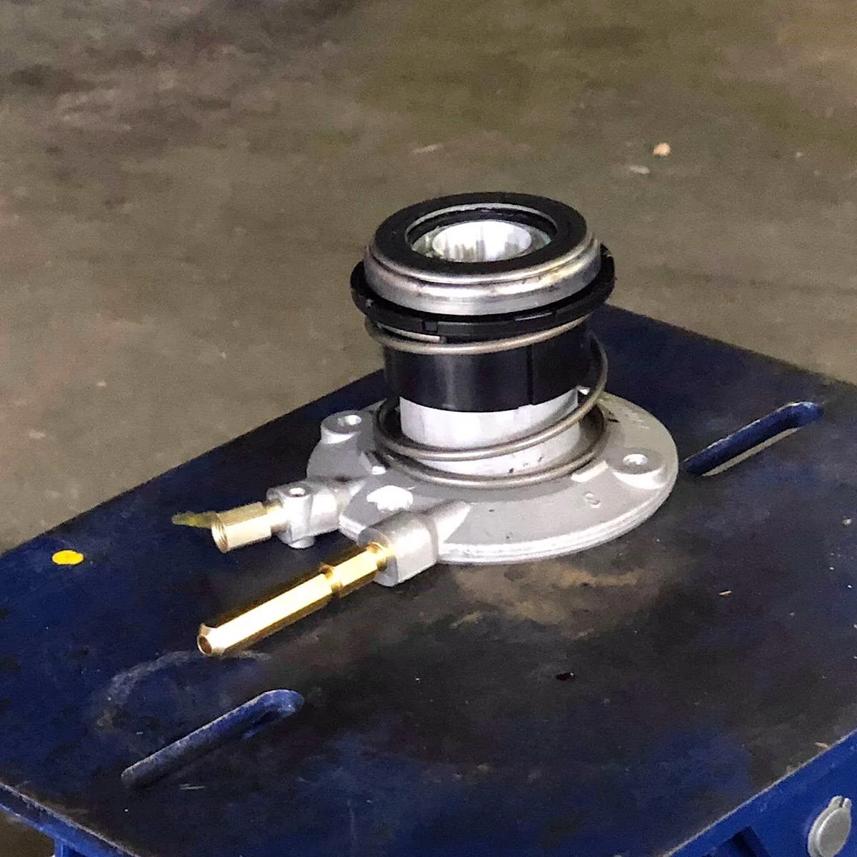

Ok, when you say you “bench bled” the TOB, I assume you mean that you immersed the hydraulic tube in hydraulic fluid and fully stroked the TOB repeatedly until air bubbles stopped appearing?
From personal experience, vacuum bleeding in the car does absolutely zero. I know that Ford have a procedure but I’ve yet to see it work.
I’ve had my box in and out a few times also. On one of those occasions it was obvious that there was a significant amount of air in the line. Vacuuming repeatedly for HOURS didn’t yield a single bubble into the reservoir.
My thoughts are that once an air pocket reaches the points in the TOB that are higher than the inlet, you’re wasting your time with it.
The inconsistency you refer to sounds to me a LOT like a system that is marginal, with heat being the determinant as to whether it will provide enough displacement to adequately disengage the clutch. That’s exactly what my mate was finding.
He’s recently replaced his TOB for an entirely different unit (from NPC) and hasn’t had further issues yet.
With the original (OEM) TOB, his clutch engagement was high, like mine. Over time, it moved closer and closer to the floor until he started having the crunching issues you mention.
No sign of leakage from the TOB or any other part of the system.
For clarity, if I push on the clutch pedal in my car, the clutch will start to disengage within the first 1/2” from the top.
Coming from the bottom, the clutch pedal needs to be almost fully up before the car will start moving forward. It’s absolutely awesome for quick shifting.
Maybe you do need a ship of some sort :question:
Pics of NPC TOB below

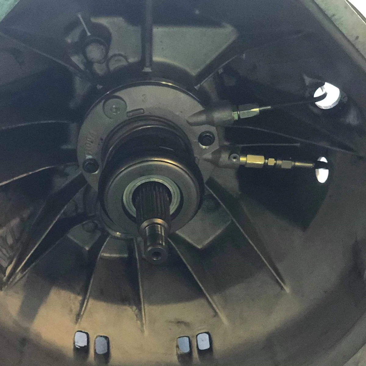

Also - I did bench bleed the throwout bearing by keeping the tube in fluid and running the air bubbles out before installing the new one - made no difference as I don't think air was the issue. But with a single inlet throwout bearing - I guess we're in the dark as to whether there's an air bubble moving back and forth that we can't get out.
That NPC throwout bearing - is that the bleeder valve coming out the second opening on the trans? Or is it adjustable for engagement point? I haven't looked at alternate bearings yet. But with Mantic the beginning of the engagement point is about 1/2"-3/4" inches off the carpet. With my stock clutch the engagement point is about half to 3/4's to the top of the stroke by comparison.
