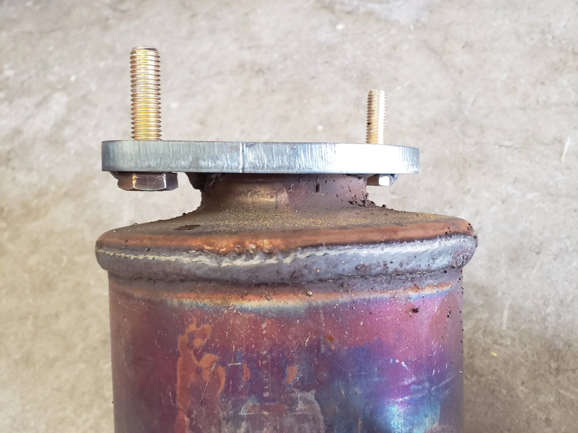

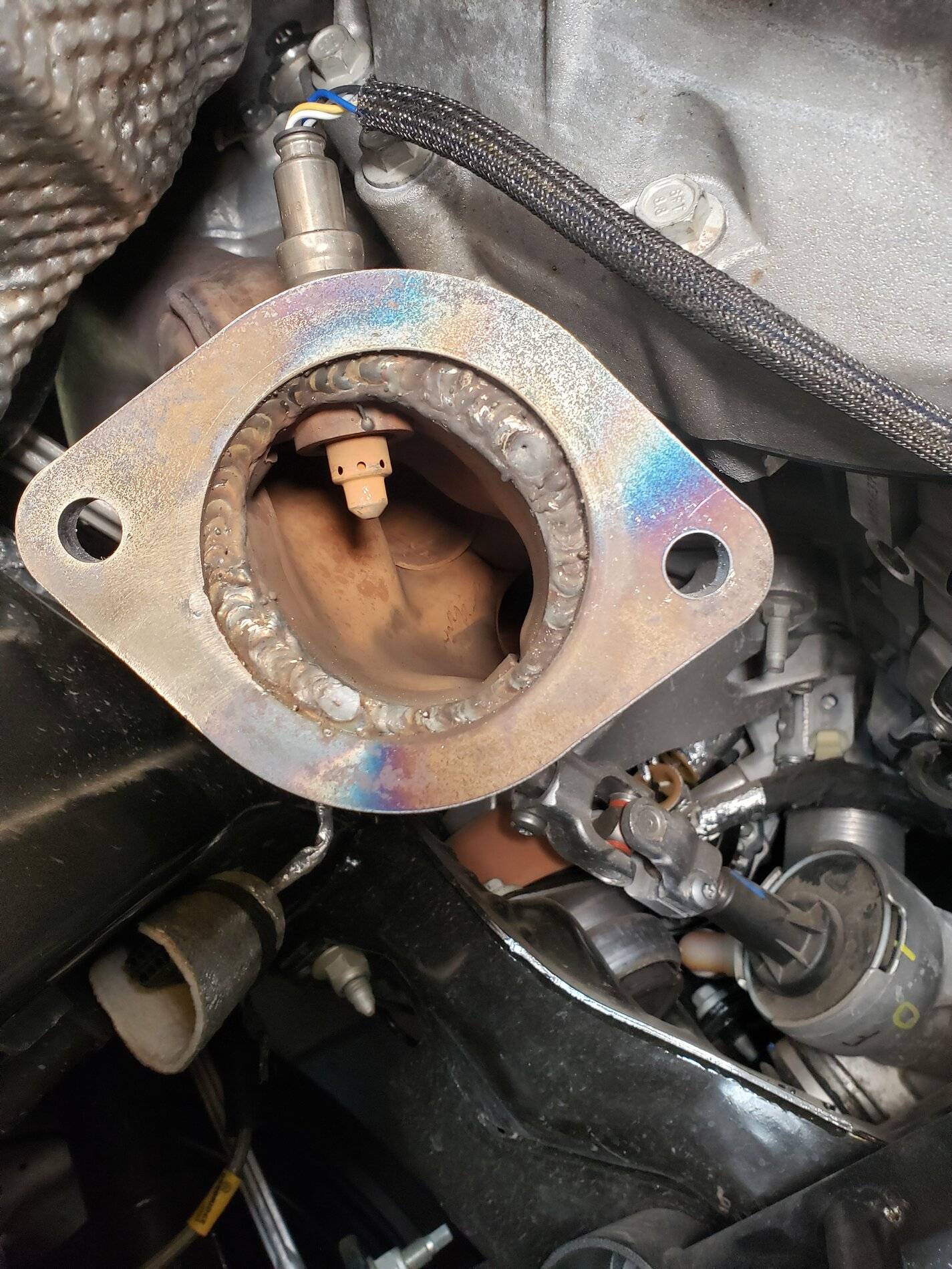

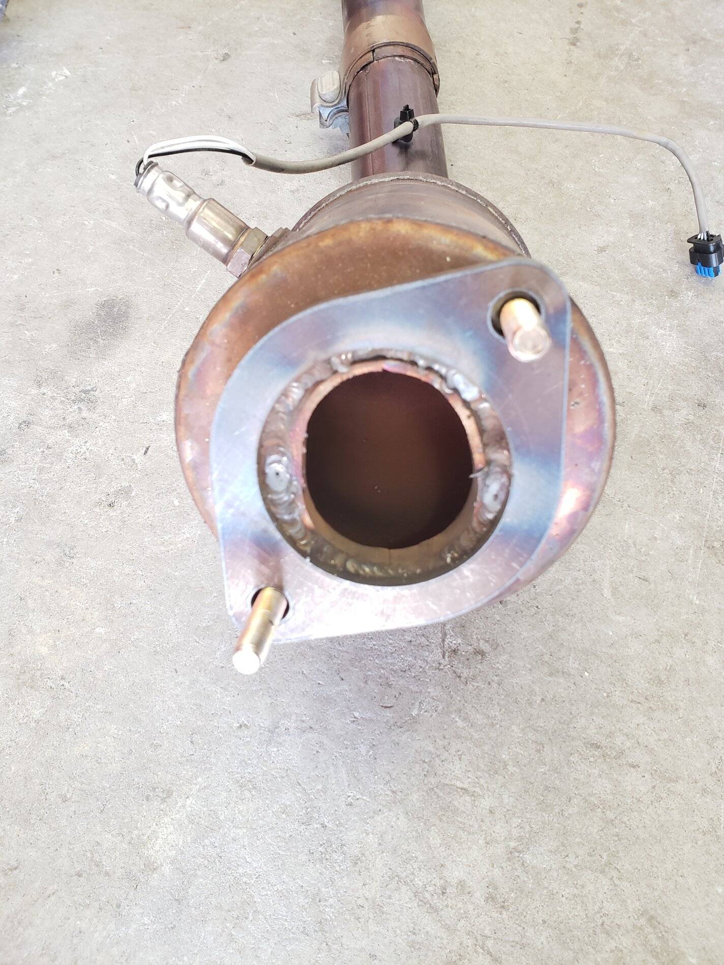

I got the cat cut off of the manifold and flanges welded on everything. The car was done yesterday. I installed the MAK pipes this afternoon. The passenger side was kind of a pain, had to use a 20" and a couple of 6" extensions in 3/8" flavor, along with a swivel joint and deep socket from the top. An extra pair of hands guiding the socket on the nut would have made things a lot easier. The muffler shop did a good job cutting and welding.
I've got the Borla S-type catback along with their resonator. The sound volume with the cats was just a tad quiet. Now with the cats gone, the sound volume is lot more at cold start, but mellow if you're easy with the throttle. Stomp on the gas and it sounds mean. Highway cruising at 70 is droneless. I'm glad I got that setup before I did the cat delete. Anything louder would probably piss off my neighbors at 4:30 A.M. Overall, I'm happy with the MAK cat-delete kit.
I also installed the Vibrant "J" defoulers, with the middle restrictor, went for a 40 mile drive and no CEL. I'm keeping my fingers crossed that the CEL stays out.

I've received an estimate from a local shop to weld the flanges on the manifold and cat. The estimate was really reasonable. I will post pictures when it goes in, just in case anyone local is looking to get theirs done, as a reference to their workmanship. Just have to wait for the kit to come in.
