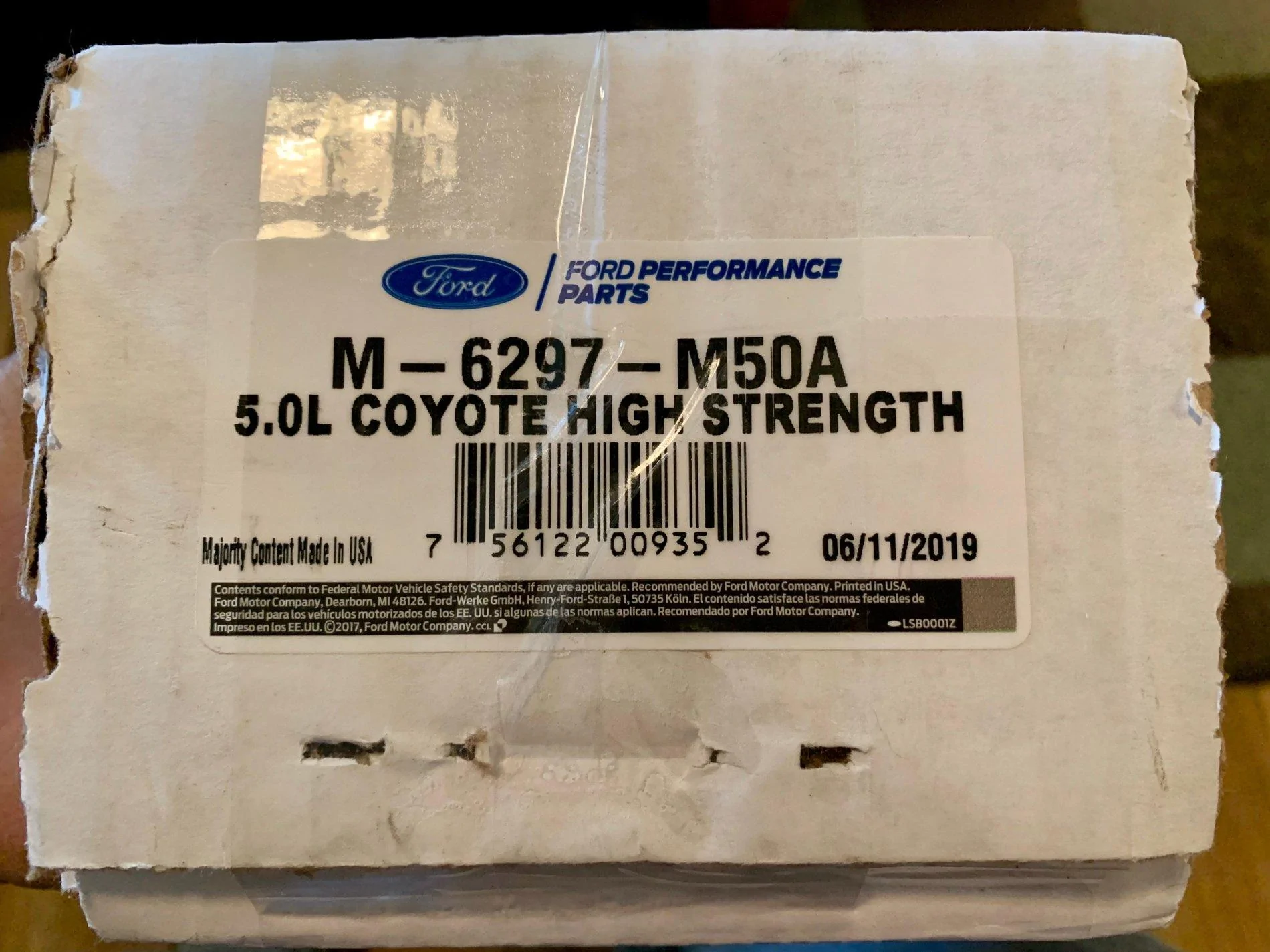

UPDATE: I changed the plugs - no success ... cleaned the MAF and filter - no success ... going to throw the stock airbox and tune on tonight and see if it still is an issue. If it still does it then I guess I will have to visit the stealership and ask about this TSB ... TSB 15-0128 - https://ford.oemdtc.com/1263/idle-dip-or-loss-of-rpm-with-clutch-pedal-depressed-2015-ford-mustang This is a seriously aggravating issue.
Installed four VCT solenoids Saturday and the idle is rock solid. I honestly dont remember the last time the idle sat so still, it has always wiggled on the gauge a little.
