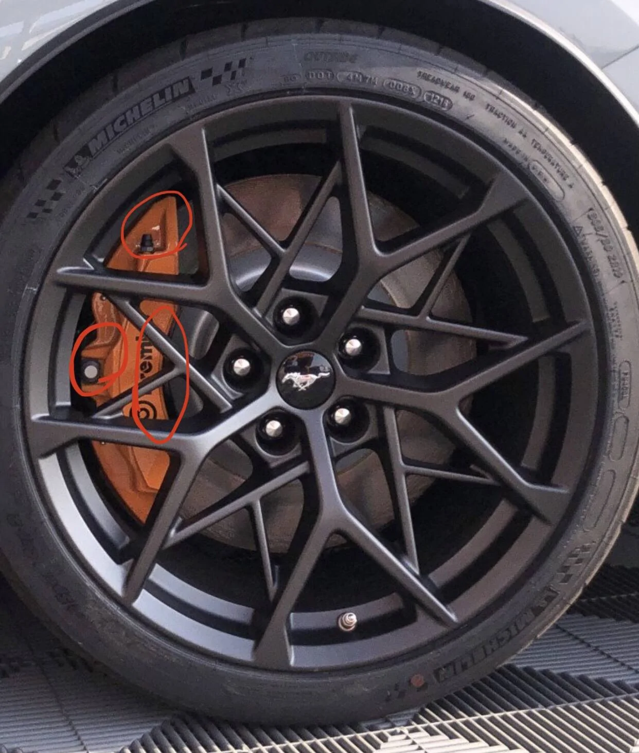

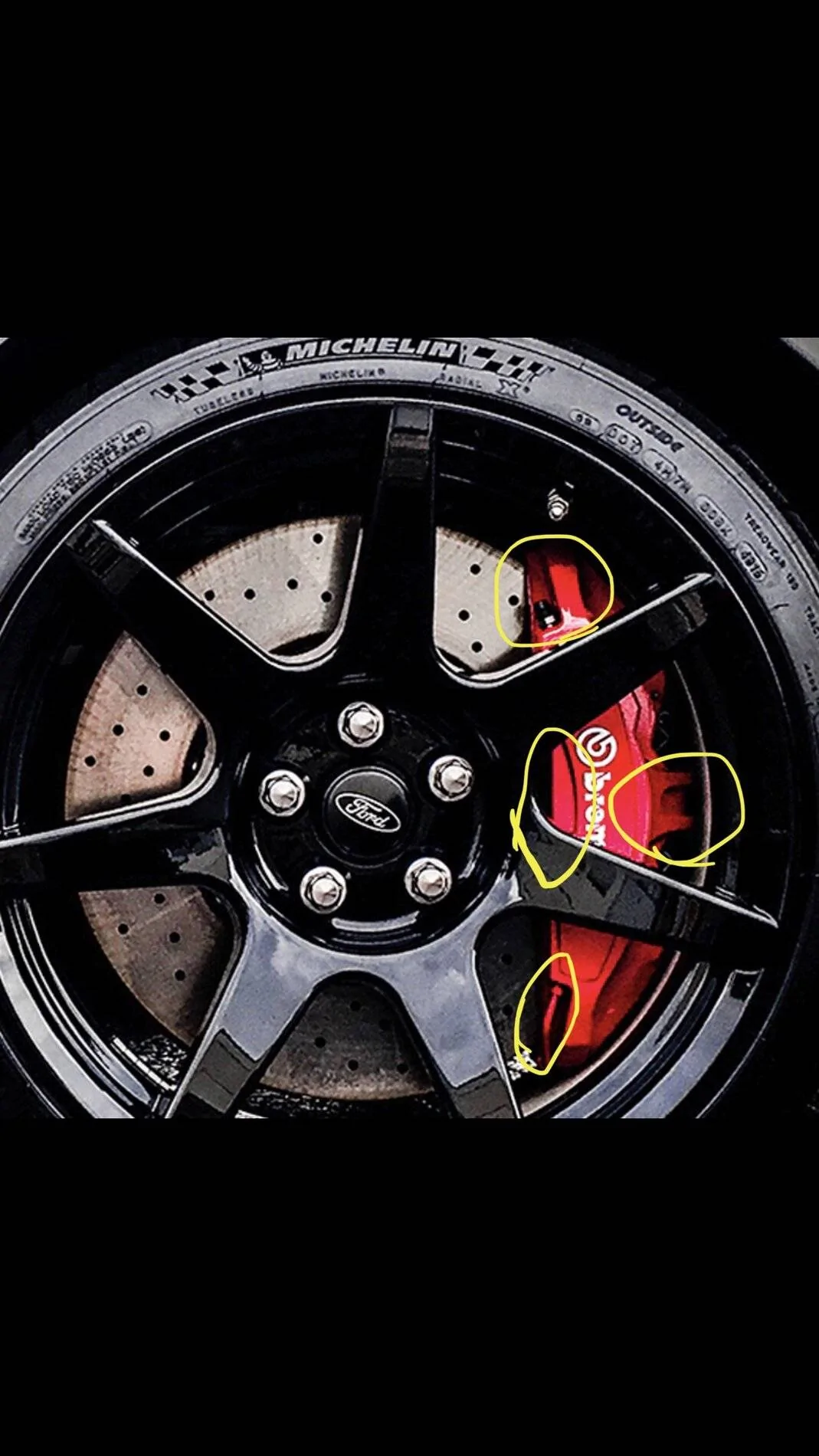

I believe you - just wondering how you know about these details of the Mach 1 so in the future I can learn to know without asking.
Circled are the most evident visual differences between the 2 calipers. It’s also easy to identify the difference between the 2 with the rotors, since GT350 has 2 piece rotors and GT has 1 piece. There are more mechanical differences between the 2, such as the staggered pistons in the GT350 caliper and, as I mentioned earlier, the GT350 caliper being a radial mount. Hope this helps
