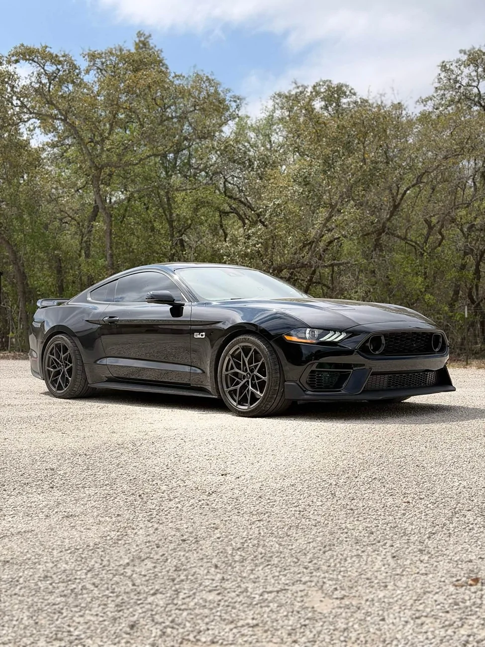

Hey, I bought a ford oem Mach 1 bumper and on my GT the stock turn signals don't fit. anyone ever ran into this issue, The Mach 1 stock turn signals look very similar to a gen 2 or gt500 style turn signal. anything helps thank you guys.

2015-2017 turn signals us different electrical connectors due to the divorced fog lights vs 2018-2023 signals with the integrated fog light option. 777 and the rest of the clones are all made by the same source and they have an adapter bracket to fit the 2018 style turn signals into the knockoff Mach 1 bumper. I don't know if the brackets fit into the OEM Mach 1 bumper but the rest of the knockoff trim pieces are interchangeable with the OEM pieces. (My son installed a 777 Mach 1 conversion on his 2022 GT and he used my spare OEM Mach 1 upper grill instead of the plain 777 upper grill.) OEM pricing for plastic parts is ridiculous but the quality is noticeably better than aftermarket.
