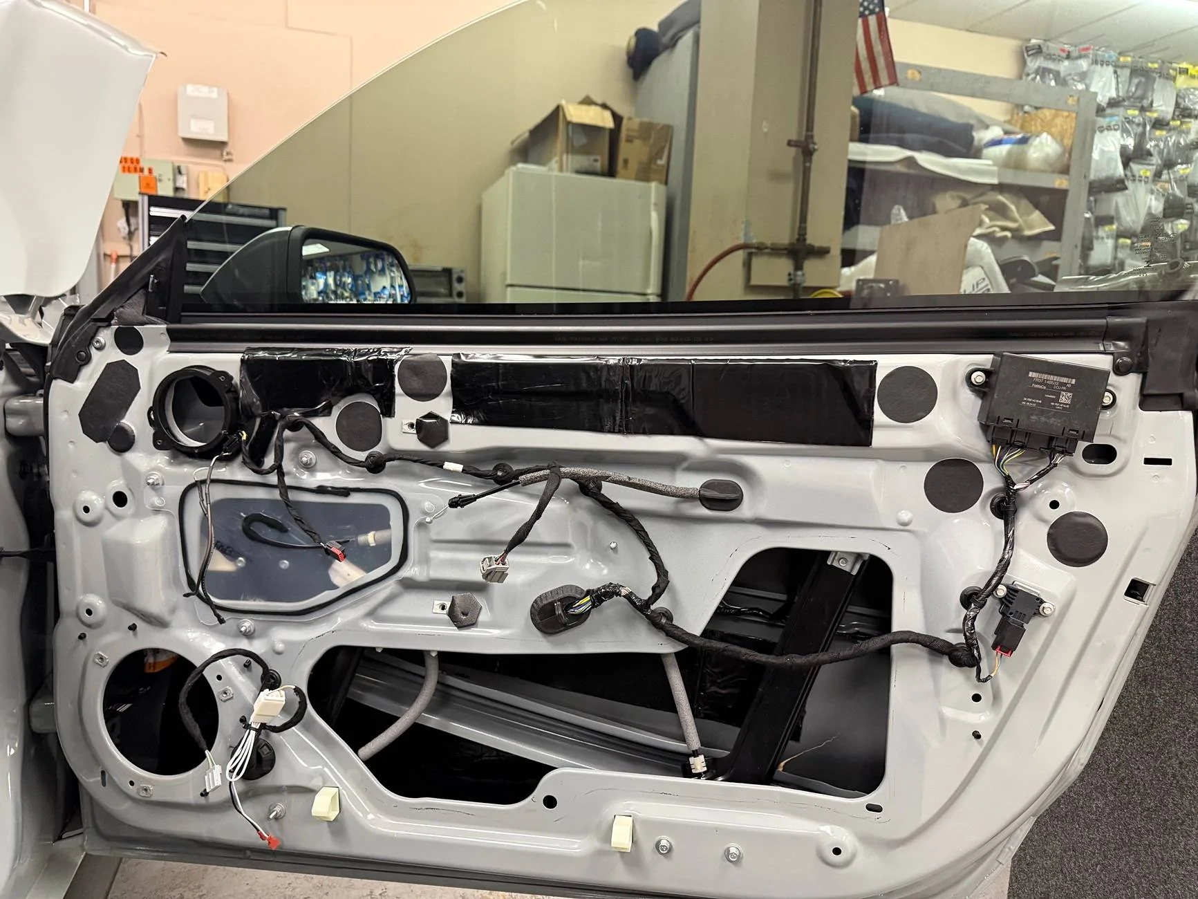

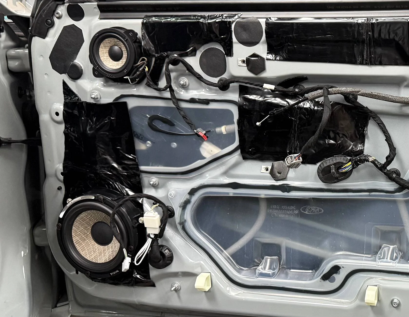

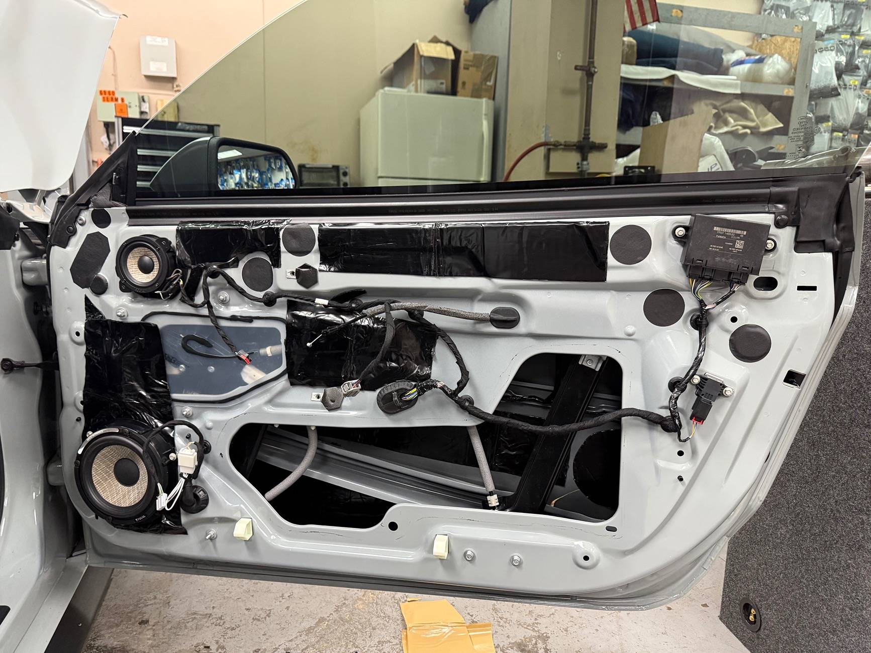

The Focal Flax Evo installed on the door. Using a precious small amount of sound deadening material to limit rattling and vibrations.
Don’t want to add too much weight to the car if I can help it.

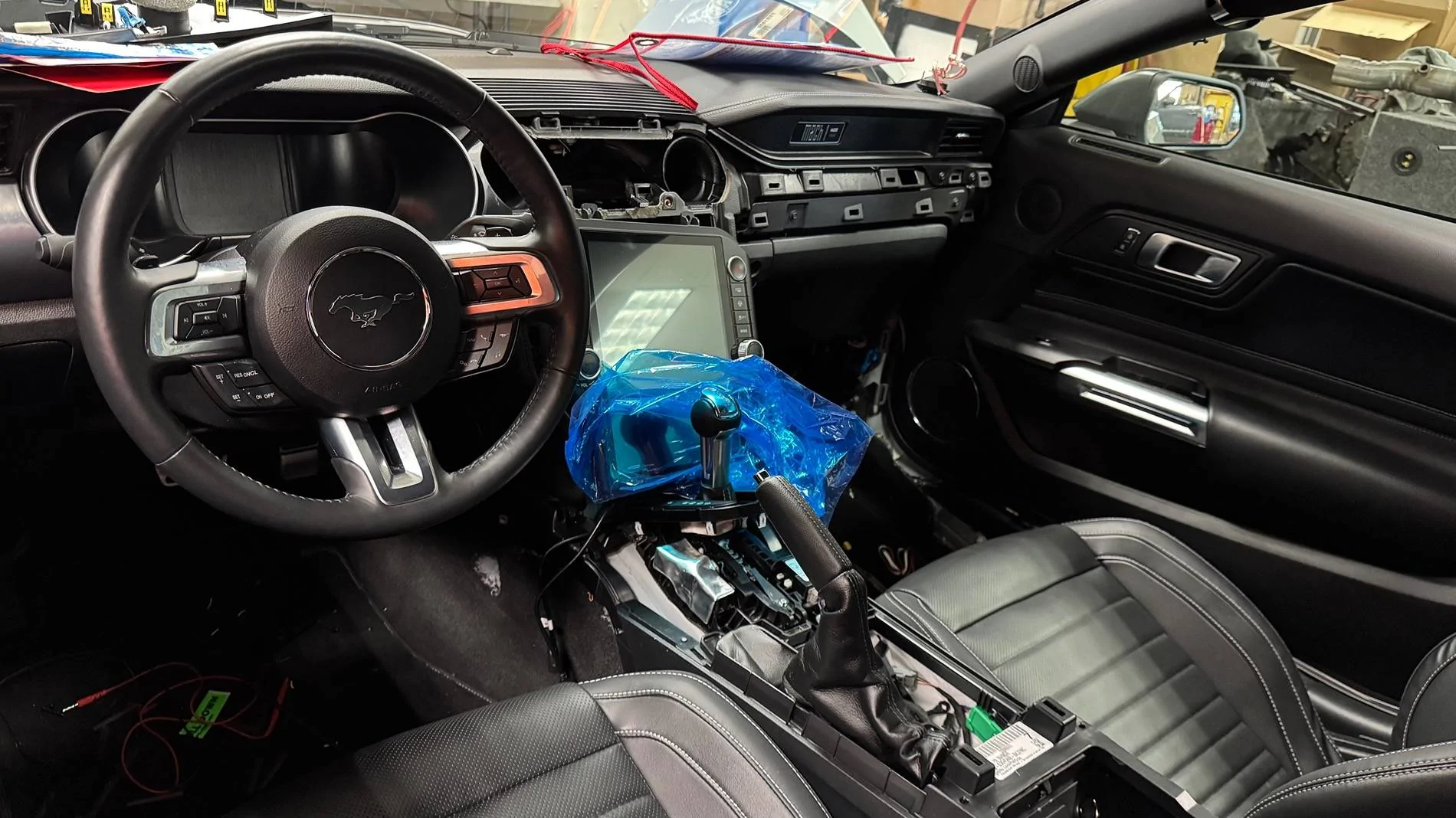

Current progress.
New head unit going in.

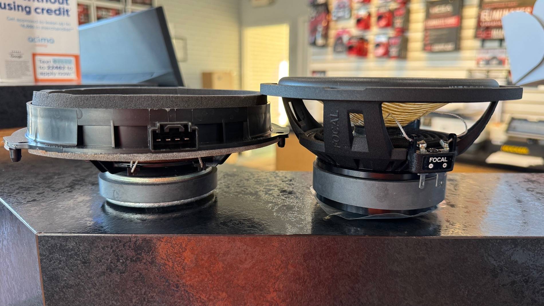

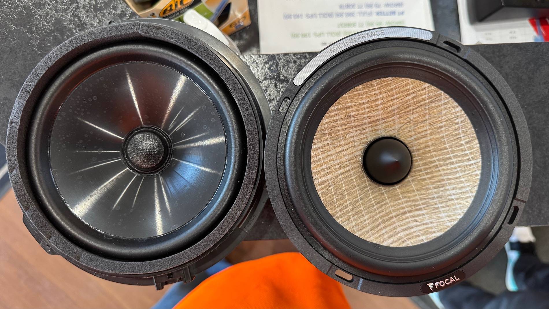

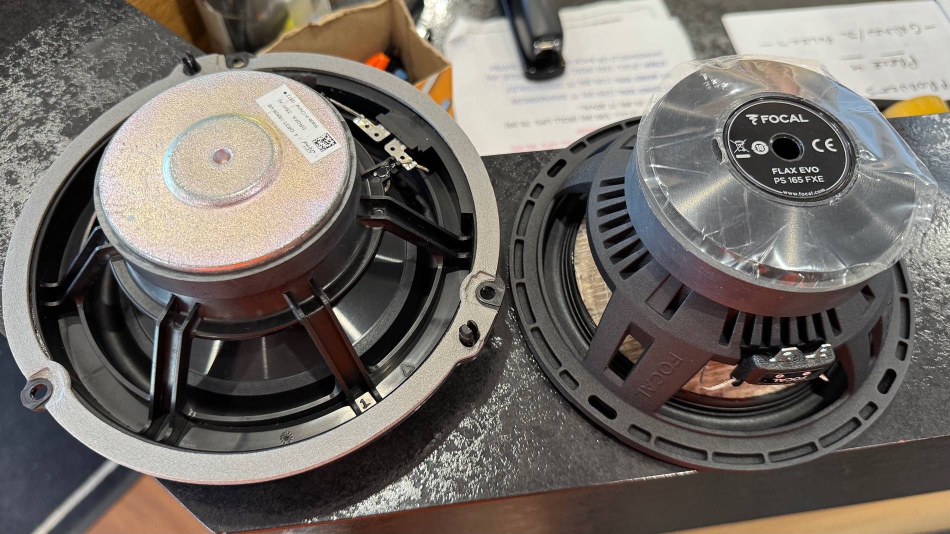

Lets take a look at the factory 6.5 inch woofer for the door and the Focal Flax Evo replacement.
Notice that the Focal looks smaller but it is not. It’s the difference in color that makes it seems smaller. In fact, the rubber surround allows for a longer throw for deep bass response.
Secondly, you can see both speakers are vastly different in terms of depth. Therefore, the install required the Focal Flax Evo woofer to be spaced out further away from the window for roll down clearance.
The rear shows a more robust frame and larger magnet. Not that this can be seen but the Focal speaker is in fact heavier than the Ford original.

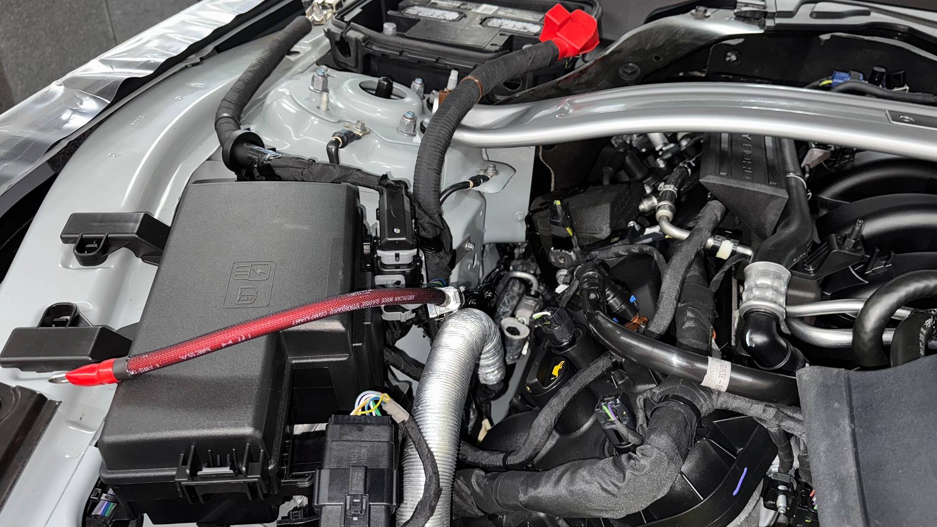

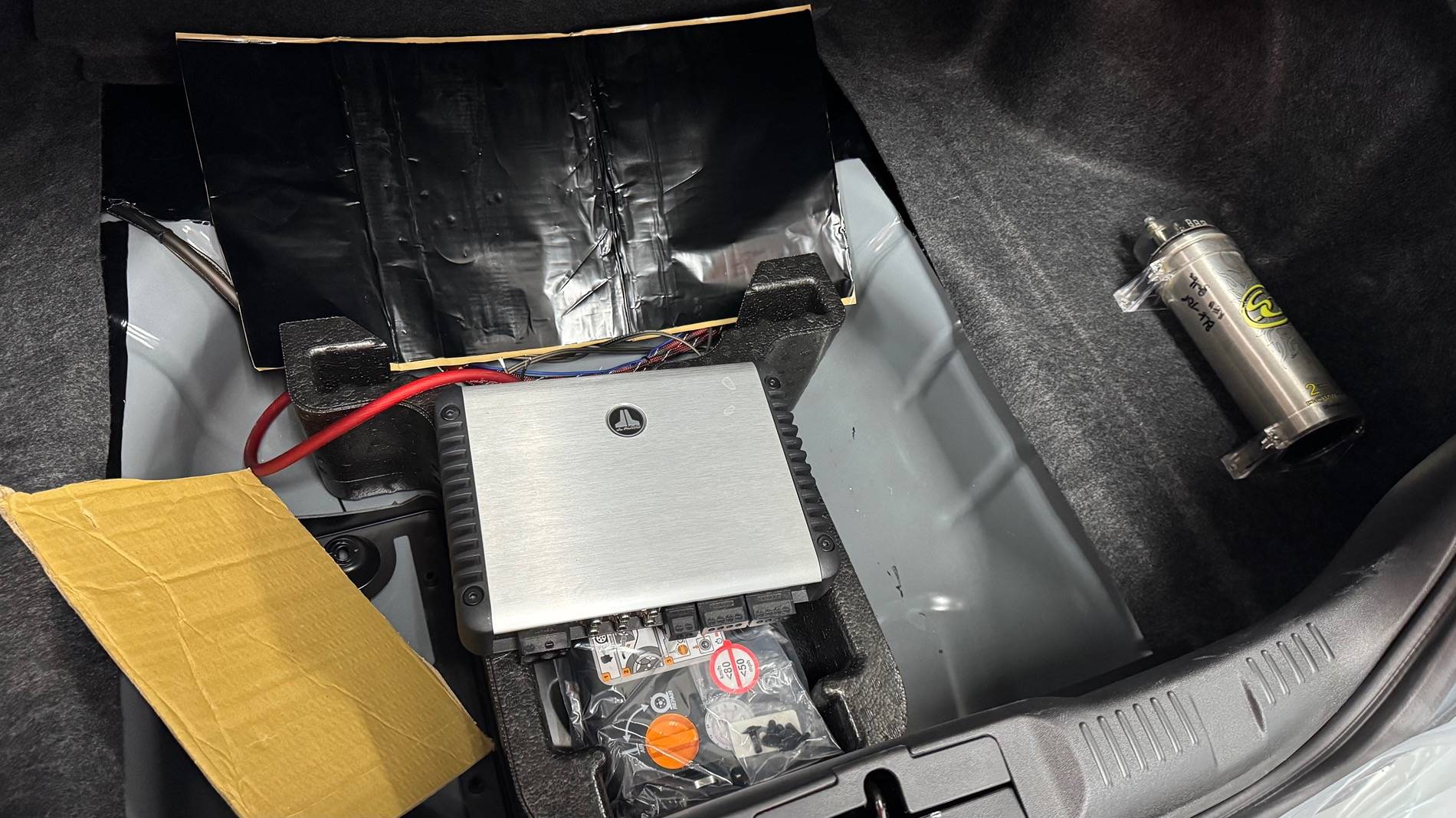

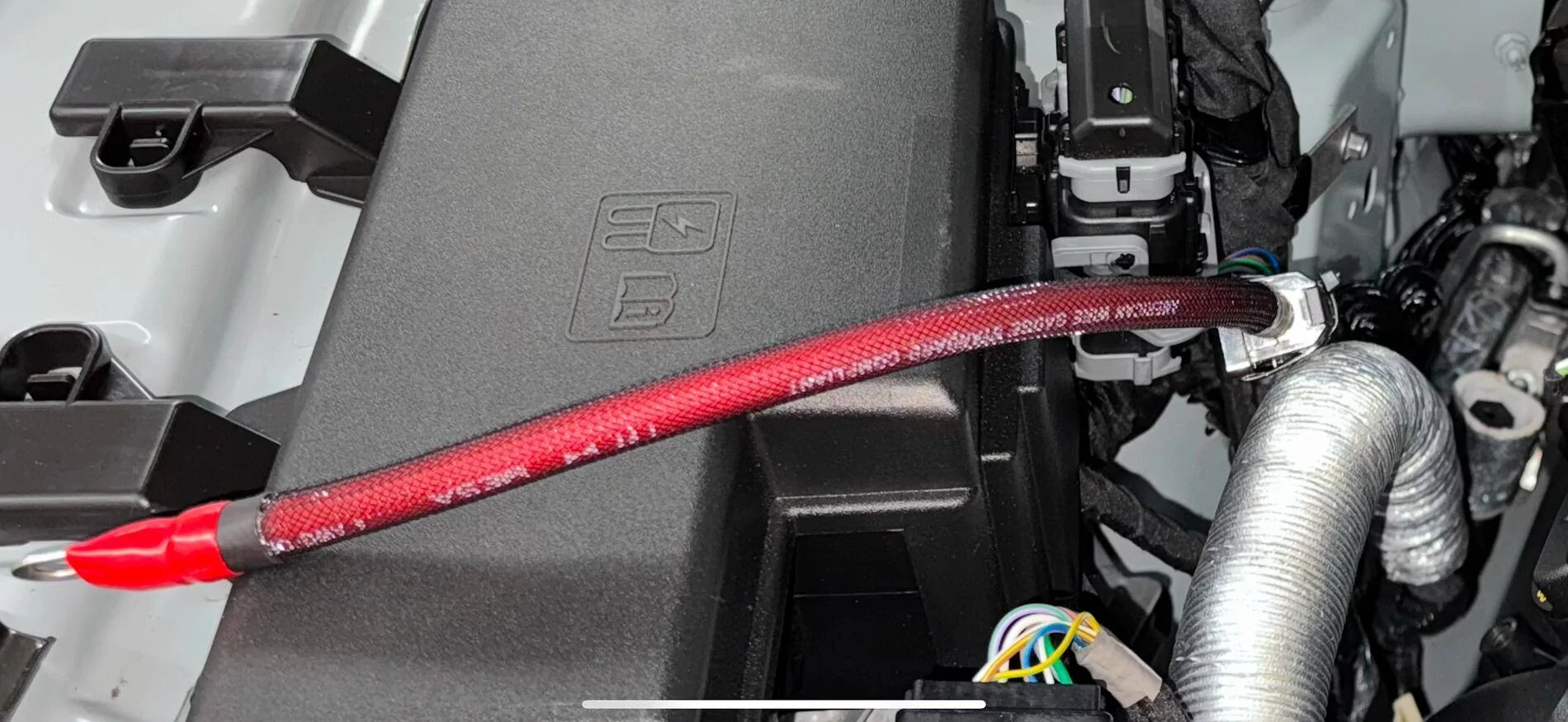

Progress right now.
Power Wire has been ran with in line fuse and fabric mesh wire loom/sleave.
Preparing to mount amp and 2 farad capacitor. Also added a small amount of sound deadening. Not sure how the installation of this is going to look but I want everything down in the spare tire well.

With everything in the well be sure to have air surrounding the amp and some airflow....gets hot in there.
You got a point. I was thinking the amp being D-class would run cooler do to its inherent efficiency.
My old school AB-class amps (Rockfordfosgate, Eclipse) had fans and could boil an egg on them when push hard. I was younger then and loved to “demonstrate” everywhere I went. I’m more focused on Sound Quality instead of SPL (sound pressure level) now.
Whatever we come up with, I will also take heat measurements and share them with you all. If I have to move it, I will do what’s necessary.
Please share any other thoughts, insights, knowledge you or any others might have.

What is that amp and what's your amp / DSP plan?
If you have the funds it's way easier / simpler install to get a compact DSP amp installed in footwell OE location plus a mono block amp in the trunk area....

Per JL "vertical heat sinks located at the sides of the amplifier should be exposed to as large a volume of air as possible".
Can always move it from well to seat back or other if not getting enough convection cooling, which may not be obvious since it reduces performance on overheating VS a hard shutdown.....
