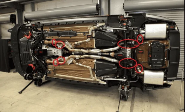

My brother was having false knock issues as well with his 14 GT with 47# injectors and Steeda intake, and GT500 axle backs on the flex fuel tune from Lund. We couldn't figure out where it was coming from. So we ended up adjusting the exhaust and steeda intake and still had no luck because whenever I looked at his logs it was always showing knock up top after about 5k rpm. My brother had taken the car to ford before for an exhaust leak where the H-pipe connects to the headers and turns out that was the culprit. After he got a new stock h-pipe and replaced the old one we checked everything once more and I looked at his logs and the knock was gone. He checked with Lund after and everything looked good.

None of my lund tunes have ever seen positive knock at WOT. I did get some when I had a BAMA tune, but that was from false knock. Header was contacting the ac bracket bolt. Once I fixed that, no issues again. Like I said, the fact that it's knocking on E85 at 30ish and pulling that much timing leads me to believe that it's fuel quality, or false knock.
