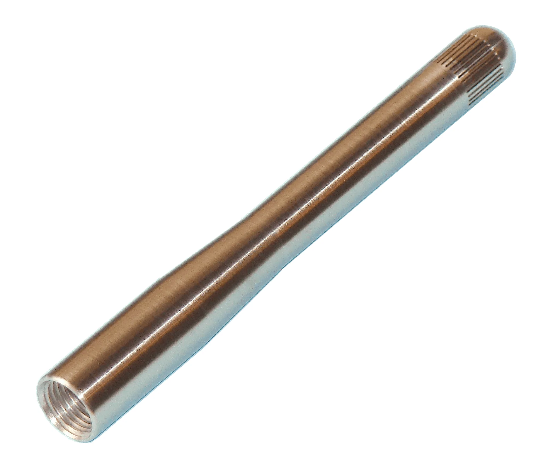

Does anyone have experience using female threaded guide pins? These things save your rims from getting scratched and protect the stud threads when putting your tires/rims on. I always have a hard time lining up the heavy PP1 rims and I have scratched the inside of the rim barrel a couple times.
https://reverselogic.us/lug-guides/Female-Threaded-Lug-Guide-Tool-p33249836
Are there any other companies that make such a thing?

I bought the ones you mention from reverselogic some weeks ago, after seeing them mentioned favourably by the GT350/GT500 guys here. Since all trackdays are currently cancelled here I've not had any experience with them yet unfortunately, but they seem like a good idea to me.
Bought them since the wheels are quite heavy, so a bit of work to get them on carefully without scratching my painted calipers (already scratched them a few times).

I used them on my Porsches, since they have lug BOLTS. But didn't know they were available for lug nuts, meaning the threads are on the inside. They have to be larger, obviously. They're not crucial to have like with lug bolts (nowhere to rest the wheel until the hub-centric 'hole'), since you have a good 2 inches to get the wheel going. But it's not nearly enough to clear the front calipers, so not a bad idea. I'll check that link out. And yes, you need at least 2 to save the calipers. Learned something new today :).
EDIT: Just ordered a pair. Need to remove the wheels to clean them, and to check torque on rear axle nuts, so will wait for those suckers to arrive. Thanks for the heads-up :).

Of course. They should arrive until Tuesday, according to the tracking. So probably by the following weekend. I'm not going to let the entire weight of the wheel/tire over the studs, since they don't look that sturdy, and don't want them to break. I need them mostly as a guide, especially at the front, to avoid hitting the calipers. Will also barely raise the tire from the floor, to have minimal drop. Don't want to hurt my back either. Ha ha.
