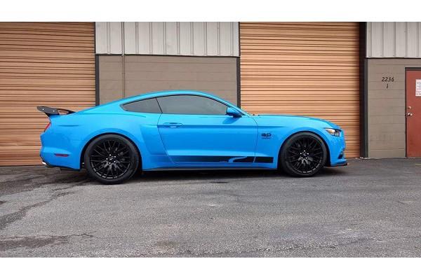

The picture above with the car from steeda is the exact look I am wanting. Do you have a recommendation for shocks and struts?

What are the specs on the Steeda car above. Springs, tire size, wheel size and offset. That is the stance and look I'm after as well.

Yes, the fixed pro action shocks and struts.
Those are the progressives & were taken with the Steeda Adjustable Pro-Actions. I will have to get the specifics on the wheels, tires & offset.

As TJ mentioned above that is our Steeda adjustable pro-actions paired with our progressive springs. Wheels are Steeda STR 20x9.5 w 275/35/20 and 20x11 w 315/35/20. I will have to get you the offsets in the morning can’t think of them right off the top of my head.
Thank you... with that wheel and tire combo do they rub? Looking forward to the backspace/offset on those wheels.
Any luck finding out the offsets on those wheels?
