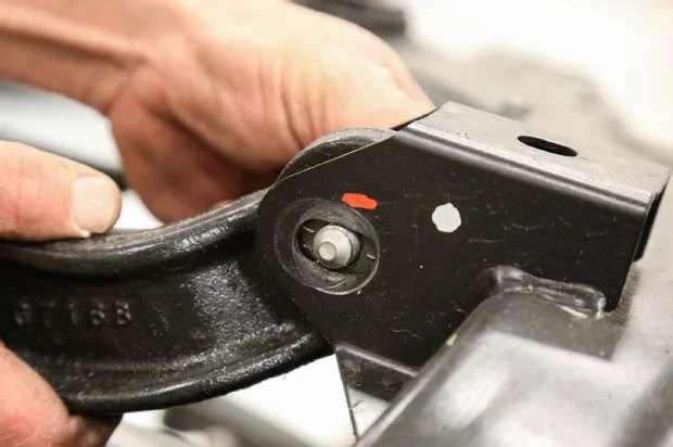

Initially my rear camber was -2 and -2.5 however there is some adjustment in the rear, when you un do the top arm bolt there is a slot which allows movement. I pulled mine right out and now Im on -1.05 in the rear on both sides which is perfect. I machined my wheels in 6mm which then gave me enough clearance with the guard for the straighter camber.

Just reading through thought I would repost this for some of the guys who may have missed it in other forums or on the facebook sites. This actually highlights where the rear camber adjustment is located on our cars. I have had and still have so many alignment shops who are not aware that there is camber adjustment on the rear end. It is hidden behind the nut of the bolt but you will see it once the nut is removed. Hope this helps. Any questions give me a call on 03 9553 6915 or email [email protected] Cheers Fred
