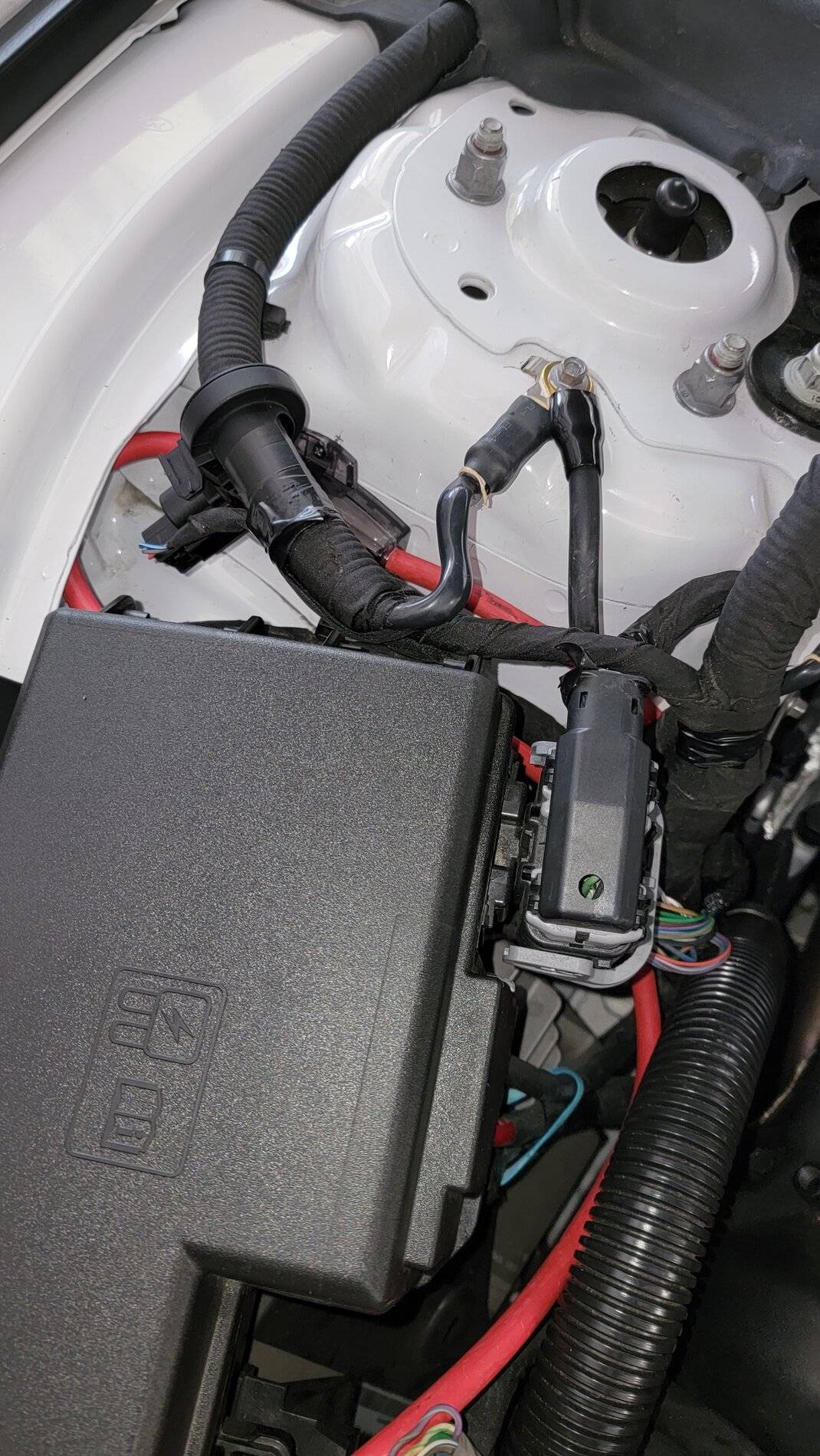

Did anyone install the Lethal Performance "The Box" power setup for their Leathal fuel system? Where did you install the power and ground wires?

Grabbed ground by the strut tower and power from the distribution box, seems to work fine, 12.7V with key off, 14v when car running.
Where did you route the 4g wires along the car.
