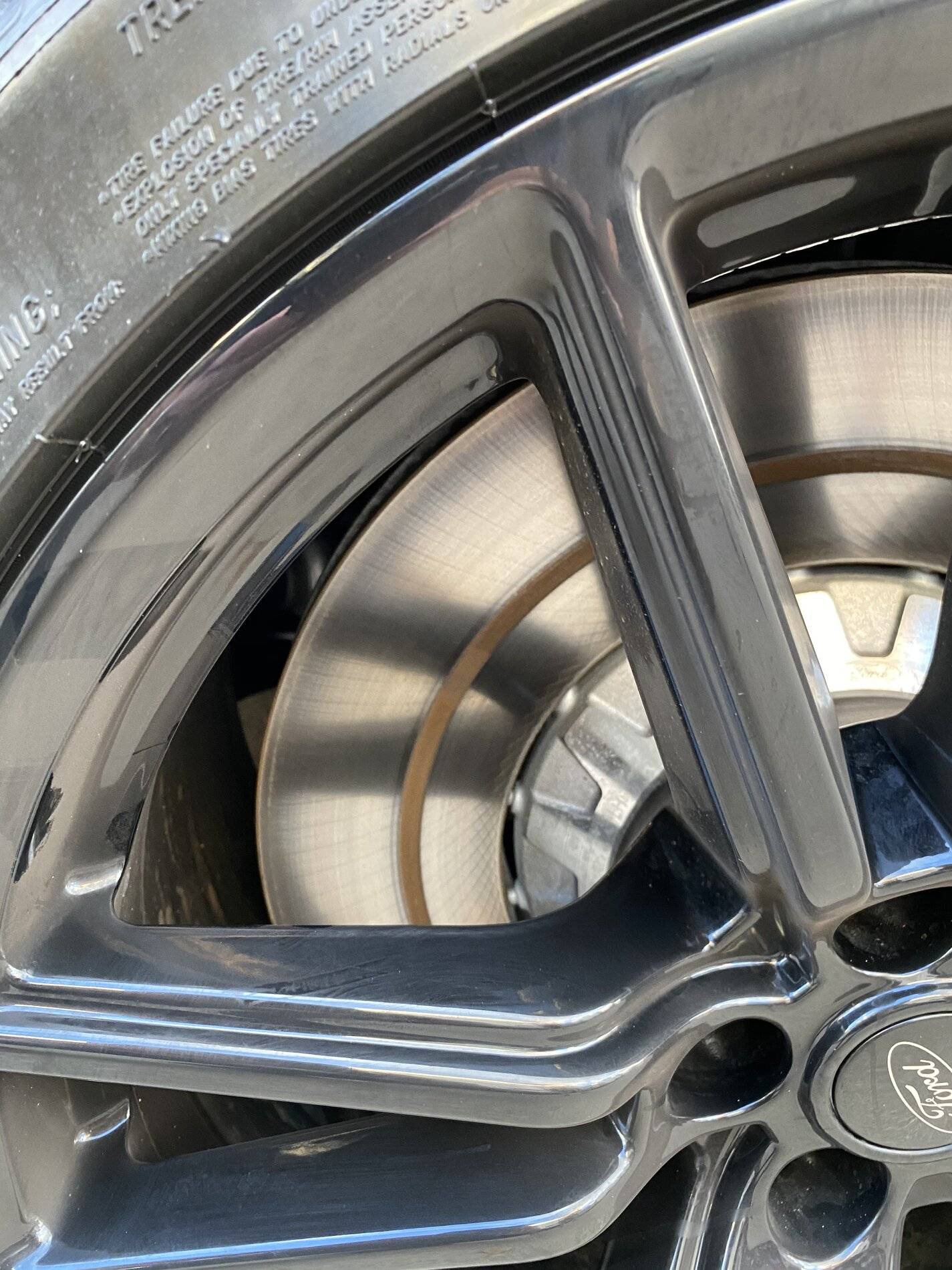

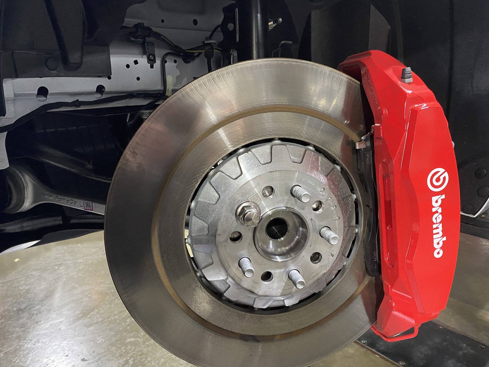

It appears my brake pad is not contacting the rotor. The pic shows a perfect circle of rust where the brake pad is not contacting the rotor. My guess is defective pad. I noticed it when I got home after the 120 mile drive home. No noise and the car stopped fine with no pull to one side or the other. This is the drivers side rotor. All other rotors look as one would expect.

HK: I'll bet money there's a rust cavity on the left pad at least.
Mine looked like this and it is from getting wet during washing and not driving the vehicle immediately to warm them up and dry them off. It's the iron particles in the pad causing the rust and along with too much dust, it's ther reason I switched to the ceramic version from PowerStop.

Interesting. It’s something with the pad no doubt and is certainly a rust line from lack of use for an extended period. Not just a day or two. It’s higher than the smooth part of the rotor on either side of the rust but just by a very small amount you can feel with your fingers (.5 mm). It is not a result of something digging into the rotor. It’s a lack of pad contact that has to run the entire length of the pad.
I turn my own wrenches and have done too many brake jobs to count. I’m familiar with how they work and pad/rotor/caliper issues. Lack of contact based on what I’m seeing and feeling is what makes sense to me.
What is causing the lack of contact is the question. I could pull the wheel off and figure it out, but the car is brand new so it’s Ford’s problem to diagnose and fix. It’s headed to the dealership today.
Sounds to me the brake pad was chipped when being installed or simply a mould defect. There is probably a piece of pad material missing, so the pad is not not contacting the rotor in that particular spot. A pad slap will take care of that in a hurry. I agree, let the dealer eat it.

@kilobravo for the win. Talked to the mechanic just now. Said pad looks to have stuck to the rotor and pulled a chunk off.
Hope to get a pic of the pad tomorrow when I pick it up. Pads had to be shipped from Detroit.
