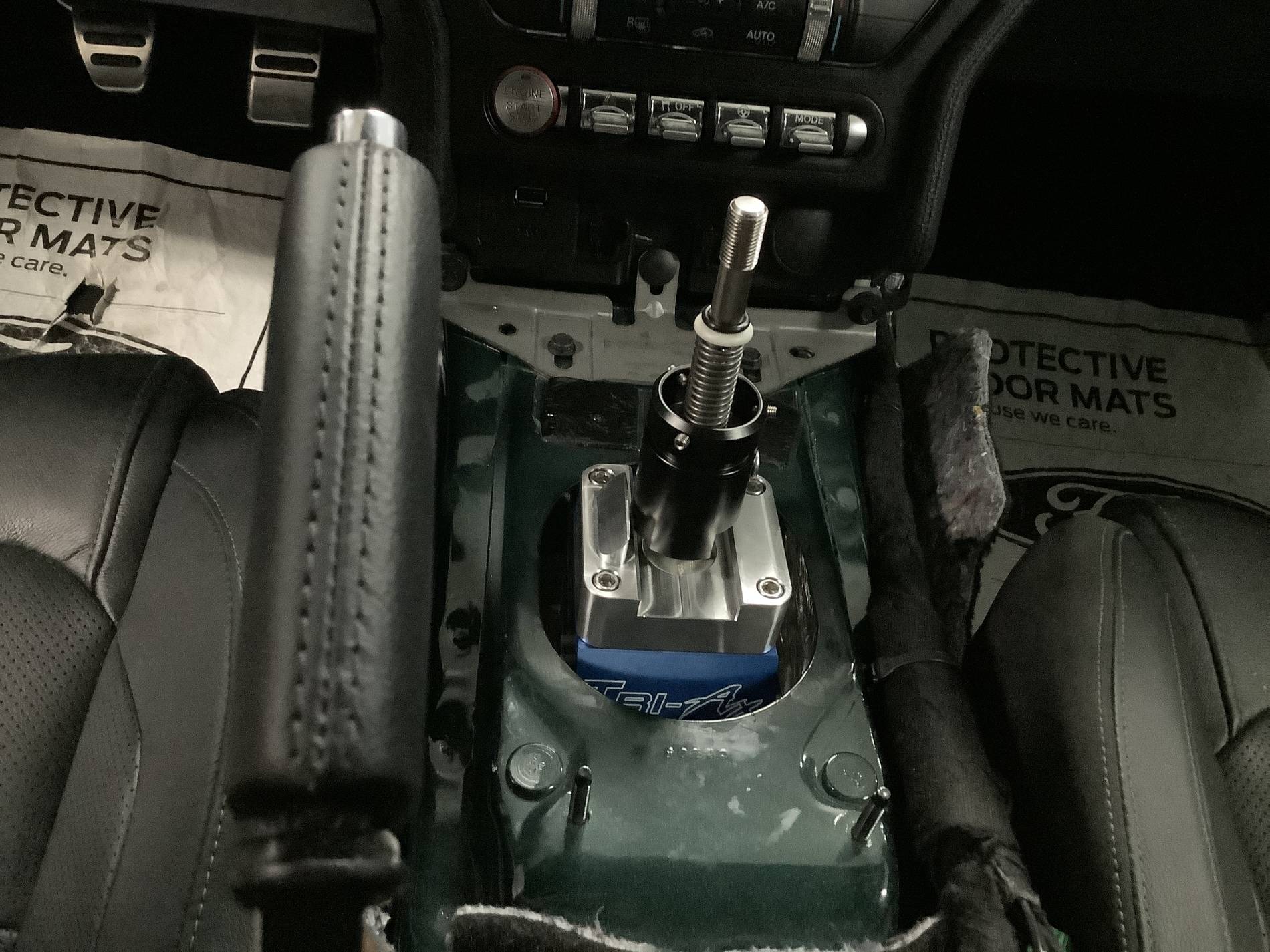

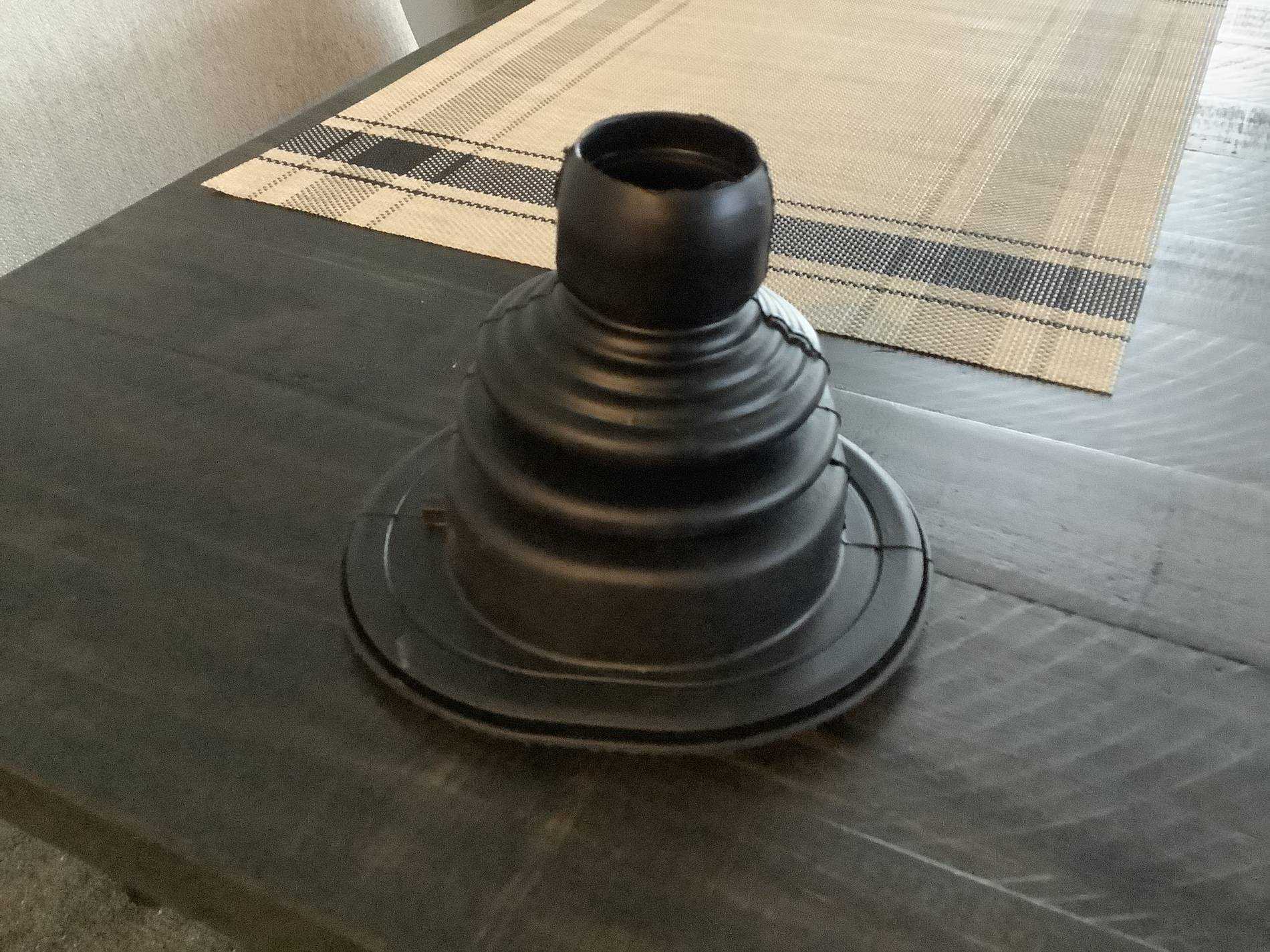

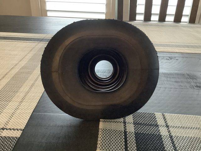

The Tri Ax Race Shifter is a very nice addition. I installed one in my 2019:Bullitt several months ago. I also have their billet aluminum shifter collar too, but haven’t installed it. I attempted to, but when I cut the threads on the vinyl shifter boot to allow it to pass through, they unraveled more than needed and the install was botched. I had to buy a new factory vinyl boot, so the billet collar sits in my drawer for now.
OP, how‘s the interior noise level in your car after the install? Did Steeda have to cut your inner rubber boot, in order to install it over the Tri Ax shifter base, or did they install an earlier model boot on it? When I installed mine, I discovered that the Bullitt inner boots are one piece, whereas earlier models were a two piece design.

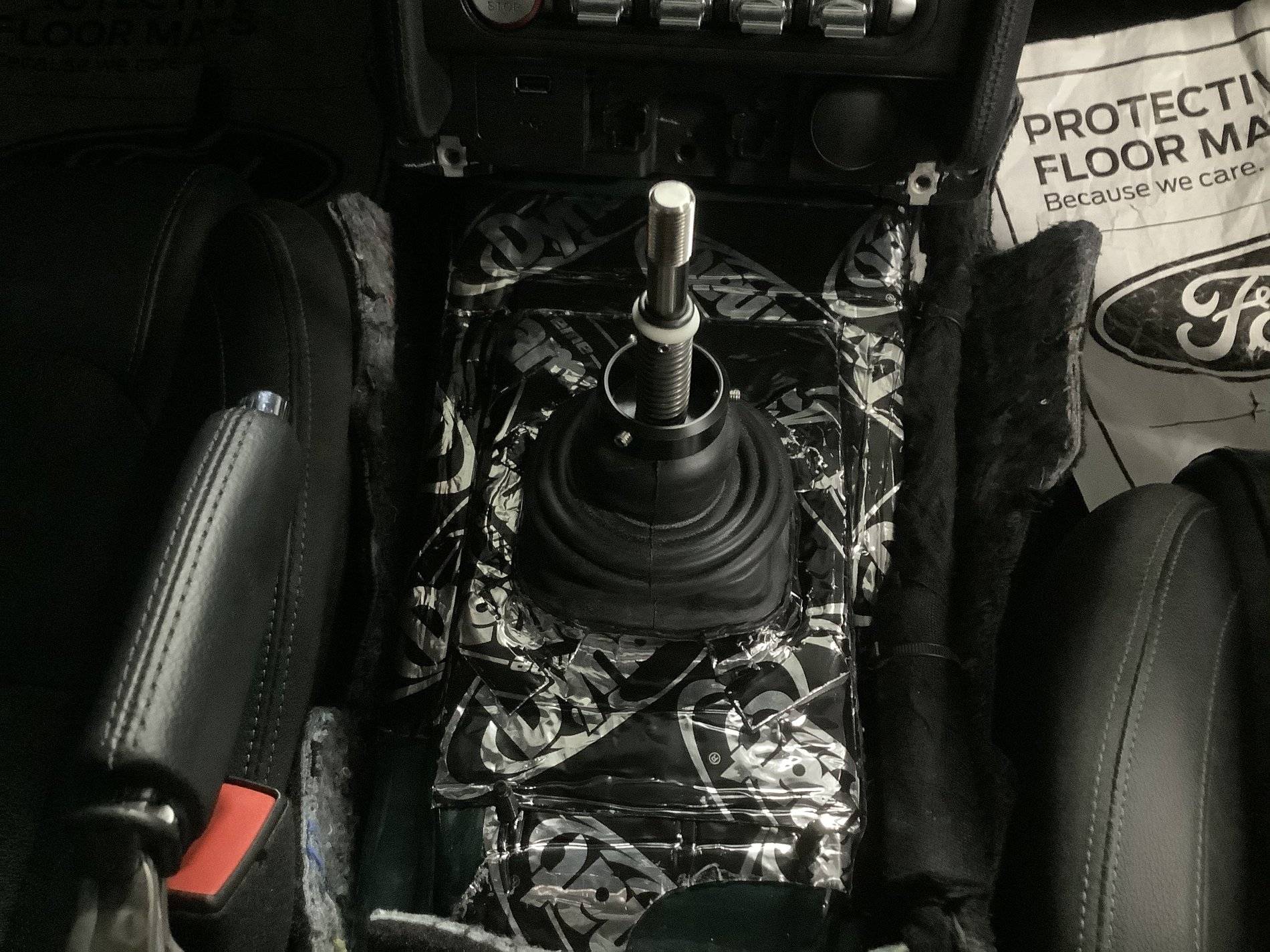

After putting 1501 miles on my Bullitt, I have had a little time to evaluate the noise level and I have to say that my car is super quiet, given that I have a lot of Steeda’s Hardcore parts on the car (motor mounts, stop the hop kit, race shifter, poly transmission mount insert, RLCA spherical bearings, billet vertical links, differential support bracket, differential support bushings (black hard version) with through bolt kit, subframe bushing support kit, drive shaft safety loop, jacking rails and subframe alignment kit. I installed all of these parts at the same time, but if I had to say how much NVH I have on a scale of 1-10, it’s about a 3. I encounter very mild vibration through the shifter knob, but only at 40 mph and again at 70 mph. Once I pass those two speeds, it goes away. I did Dynamat mine very well and I also cut the factory boot to install it over the Tri Ax to make it as quiet as possible.

That’s actually two layers of Dynamat in the area surrounding the shifter itself. It also runs around the bottom of the boot too. I did this to tightly seal the interior from the elements.
