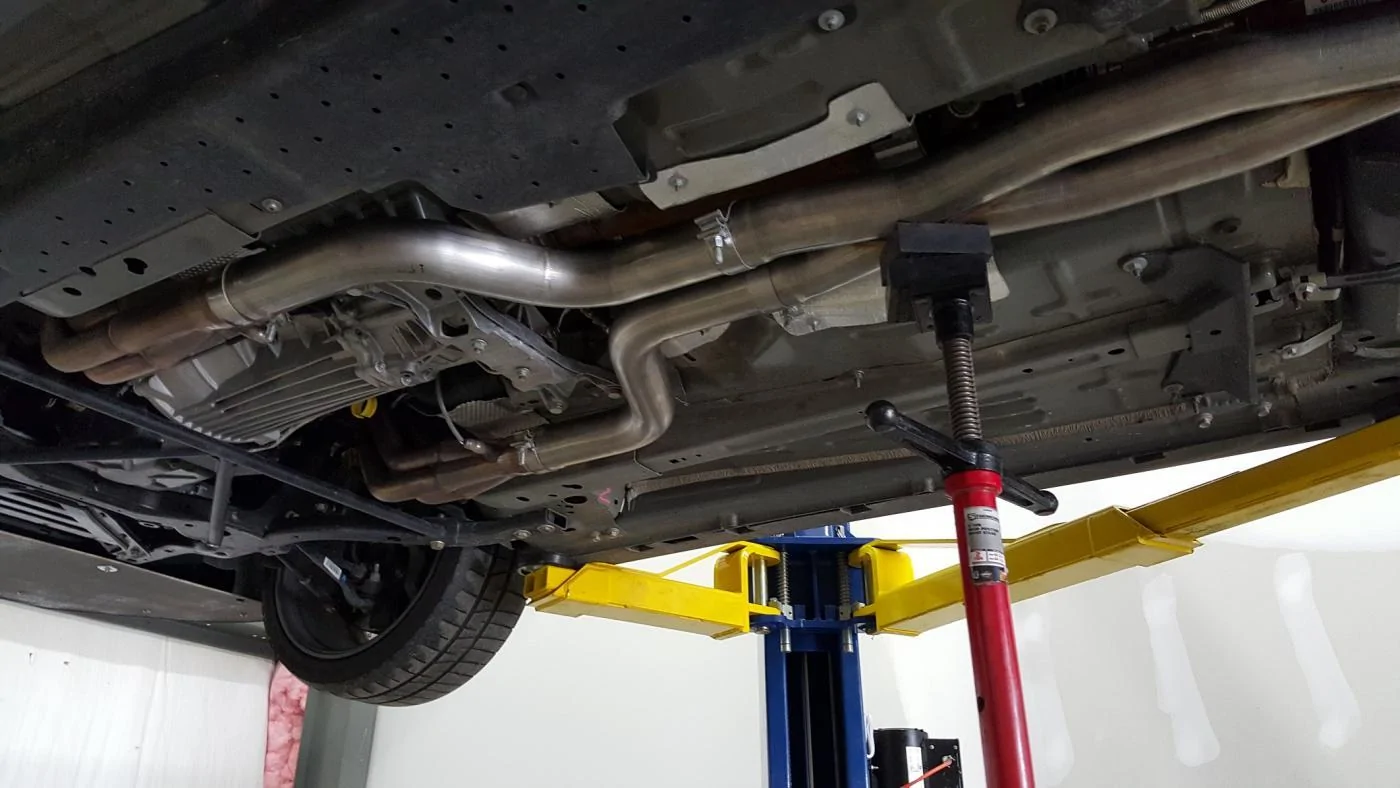

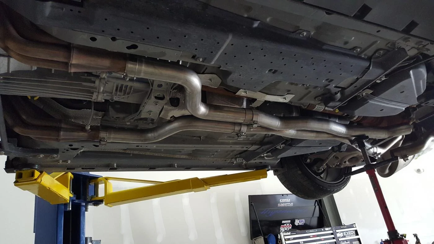

Nice , do your run e85? And if so did you need to relocate the 02 sensors.
No need to relocate with ARH, and I run E85 almost exclusively. I'll fill with 91 every 6 trips to the gas station

Awesome, do you happen to have a picture of the orientation of the 02 sensors once installed?
All the pics I've seen of the ARH headers show the O2 sensors in the 3/9 orientation. You might not have problems, but I'd plan on relocating the bungs. It's easy to do by yourself if you have the right tools or just have an exhaust shop do it on the cheap.
Here is the position. But again, we have a few cars of our own on E85 running this without issue.
