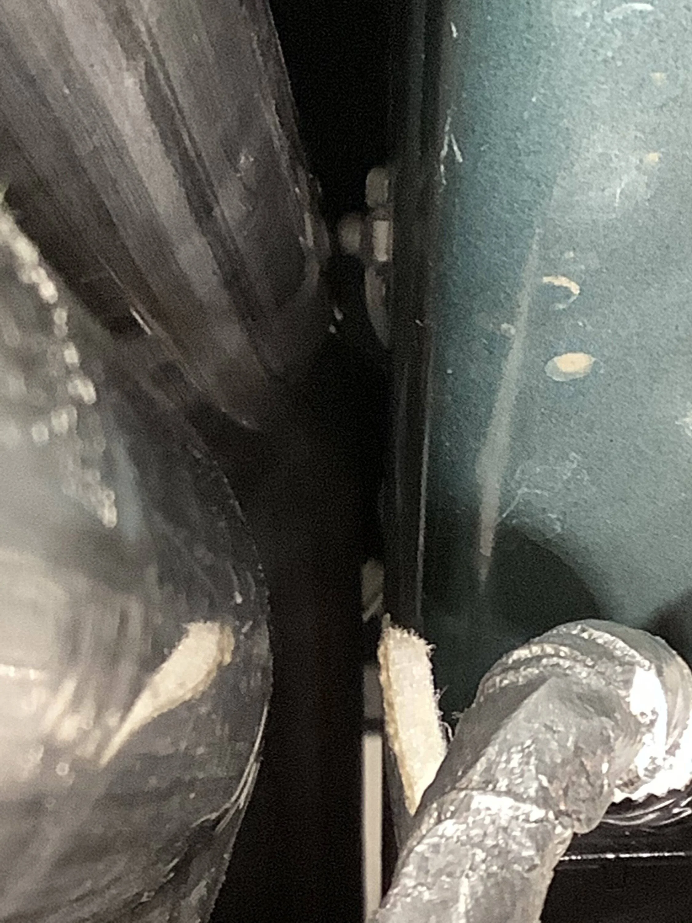

I know you inquired about Kooks LTHs, but I wanted to let you know that Ultimate Headers 1 7/8 LTHs do clear everything (including AC) with no massaging needed. Here’s a pic of the passenger side showing distance between the frame rails and AC line bracket. I would estimate at Least 1/2” from from rail and (although it may not look like it in the pic), 1/4-5/16 from the AC line bracket/stud. I am running Steeda’s adj. motor mounts with engine lowered 1/4”.

If it is all out race lose the AC. I believe the 2 in primaries might impact the AC lines, and they will be closer to the frame. You don't want them touching anything and causing a false knock.
That being said some brands 1-7/8 have these same problems.
Im hoping they mean it needs to be removed to install the headers, not to use them.
I know with Kooks you can keep AC.
Thats actually another concern of mine. Will the 2" clear everything with the engine lowered, as i have a CJ manifold to install as well. But, once again i havent decided if im going to drop the engine or run a different hood.
