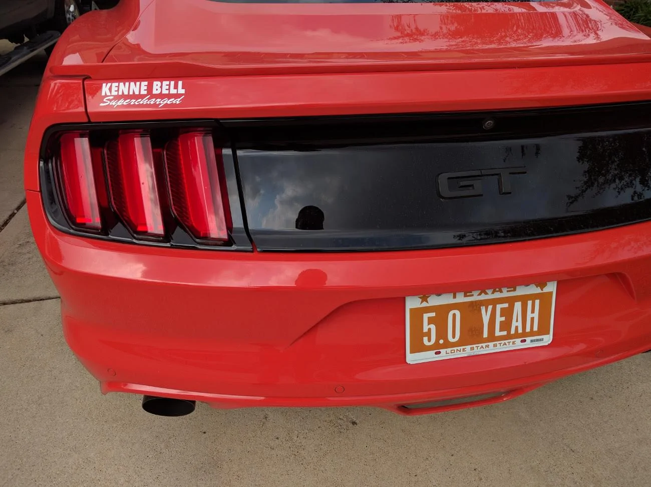

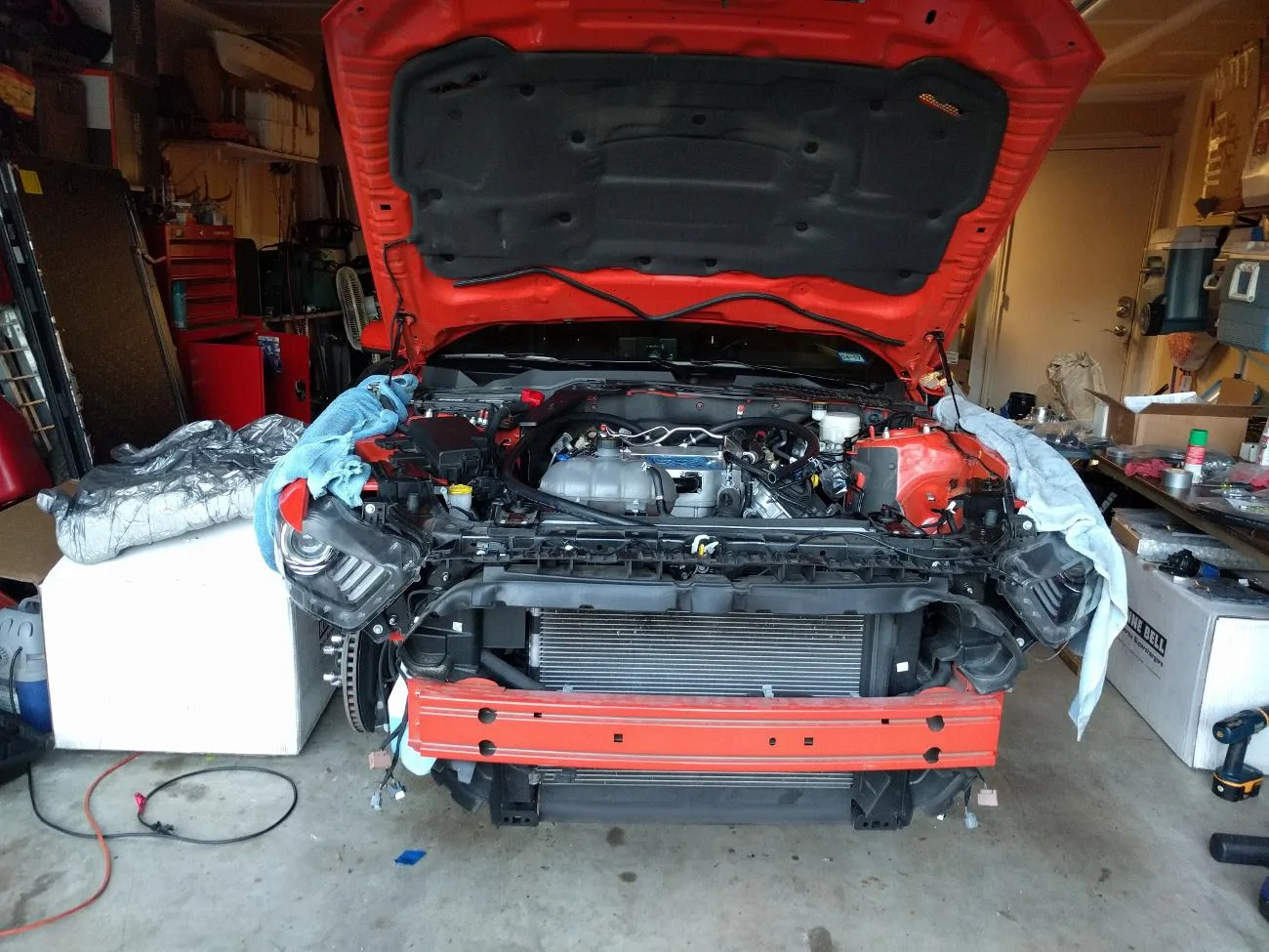

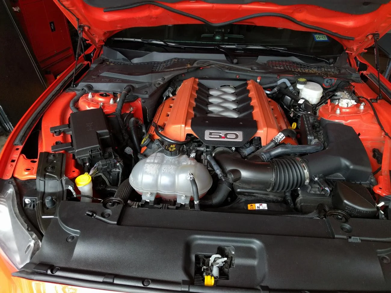

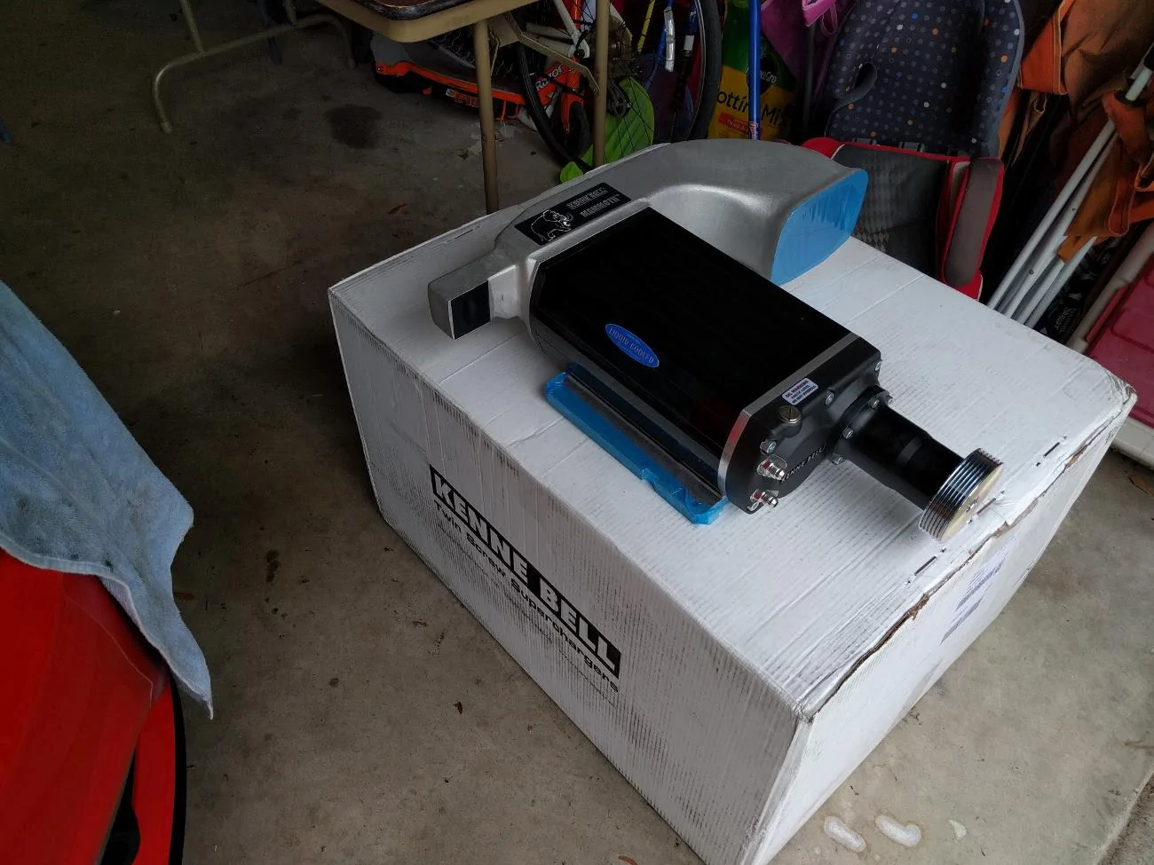

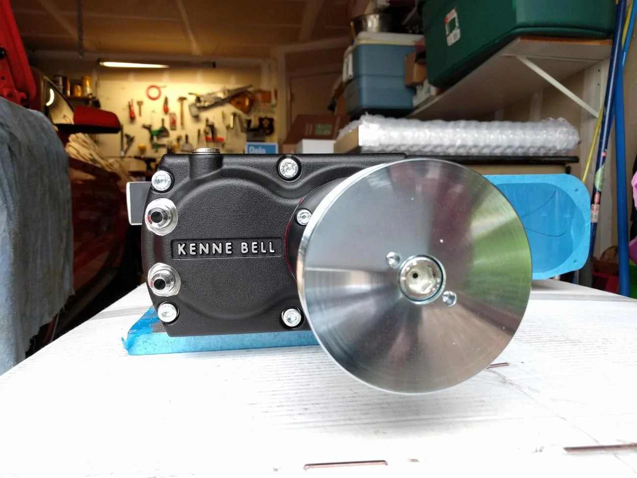

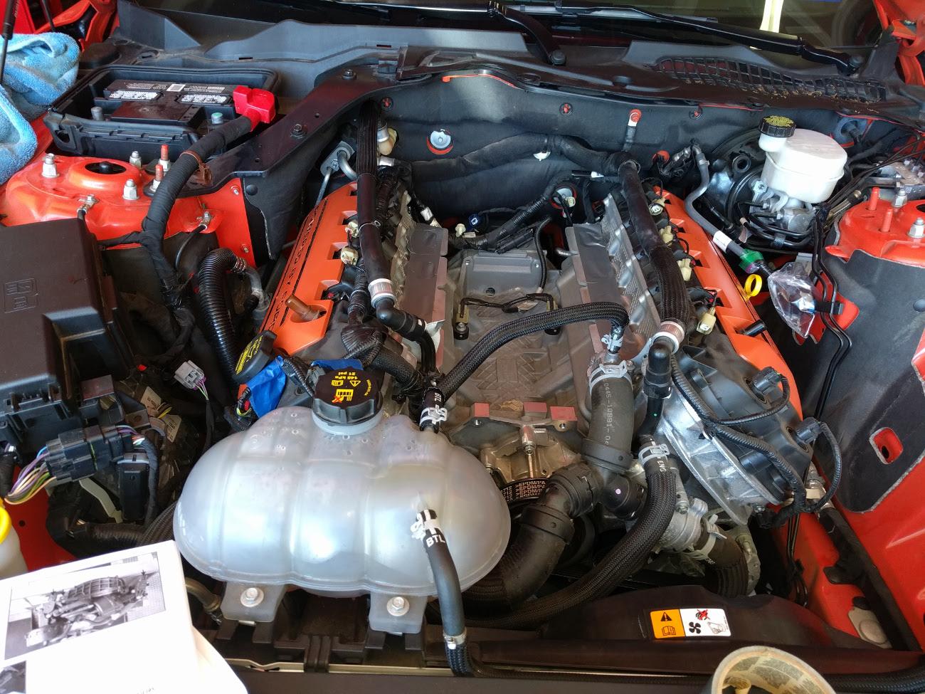

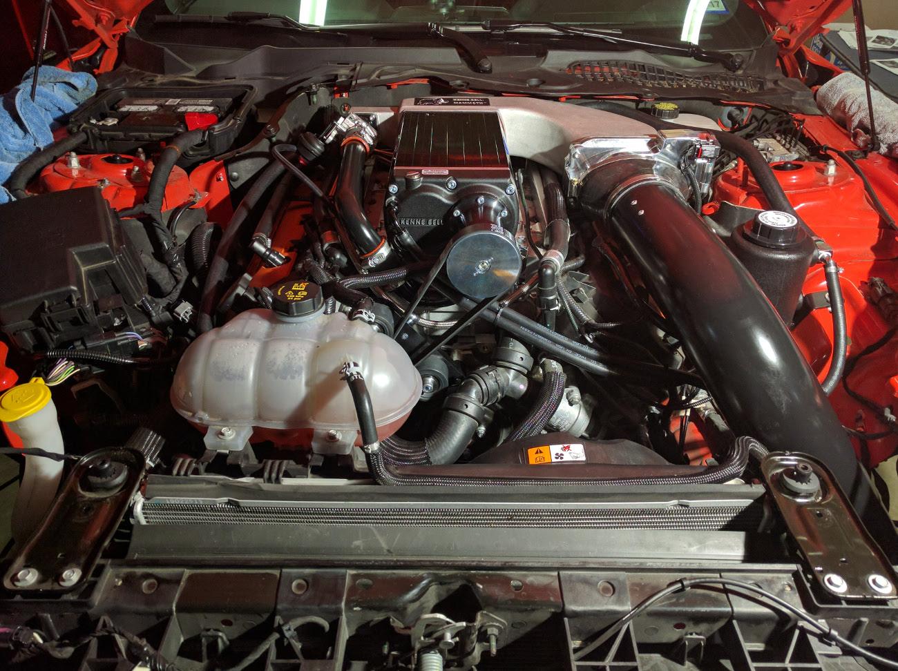

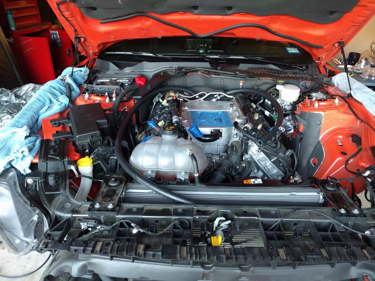

Finally finished up my Kenne Bell 2.8l liquid cooled supercharger. I started 2 weeks ago after ordering the kit direct from Kenne Bell with their stock tune. I did all the work in my garage on the weekdays and 1 weekend so total time about 20 hours. They say the kit can be done in 12 hours and I don't doubt that at all. I do not work on cars for a living and have not really wrenched since I was a helo mech in the Marines some 20 years ago so I am rusty and took my time. Loved the install guide and all the parts were top notch, so install was smooth. I have added pics to show some of the main progress. Now it is done all I can say is holy crap. It is as fast as I would ever want a street car and more beautiful than anything out there. I went to my first car show and was the only KB so it stood out. Love this setup and performance. I may never dyno this as I don't really care about number just the feel.
Stock
Blower
Just very cool
intake out
inter-cooler in
All up in it
almost done
Came with the kit
